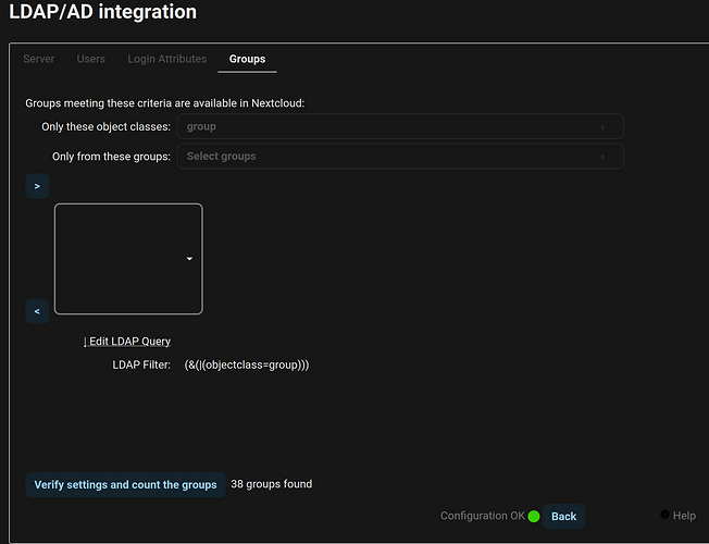

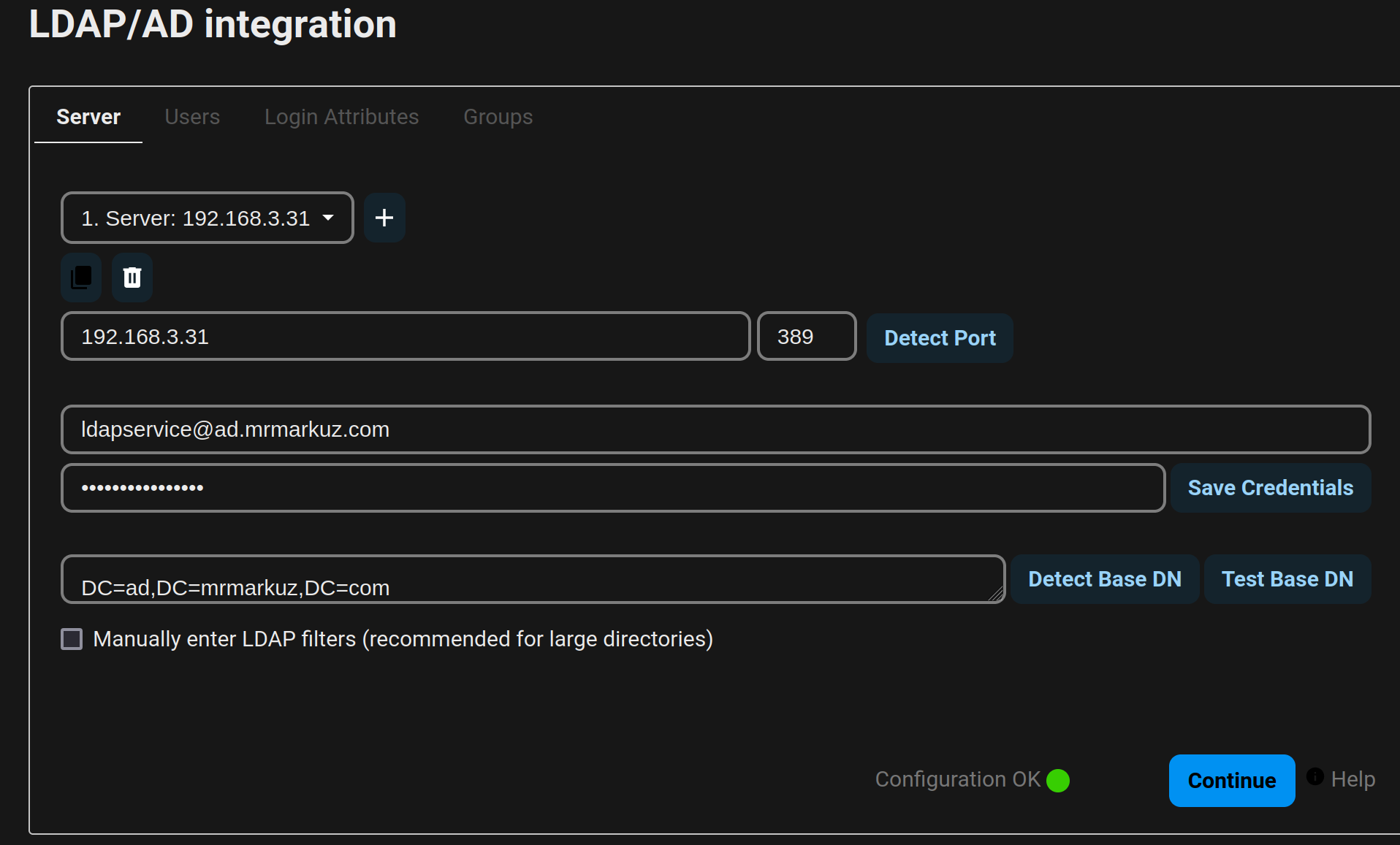

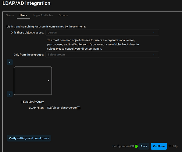

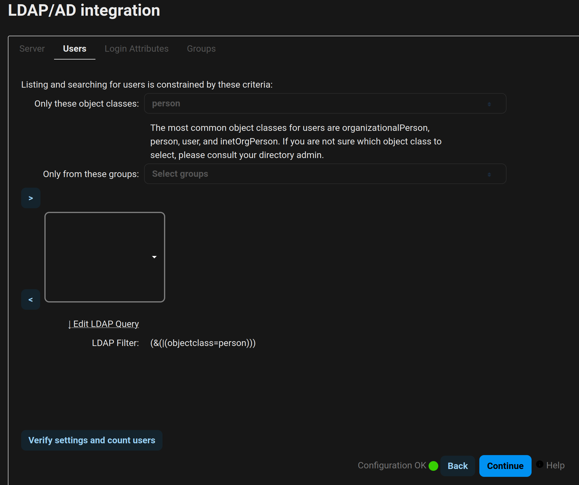

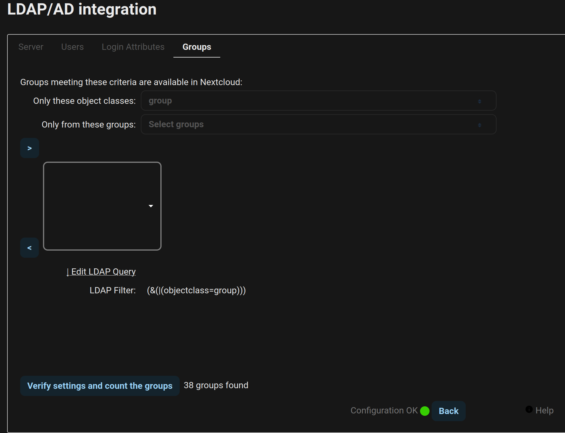

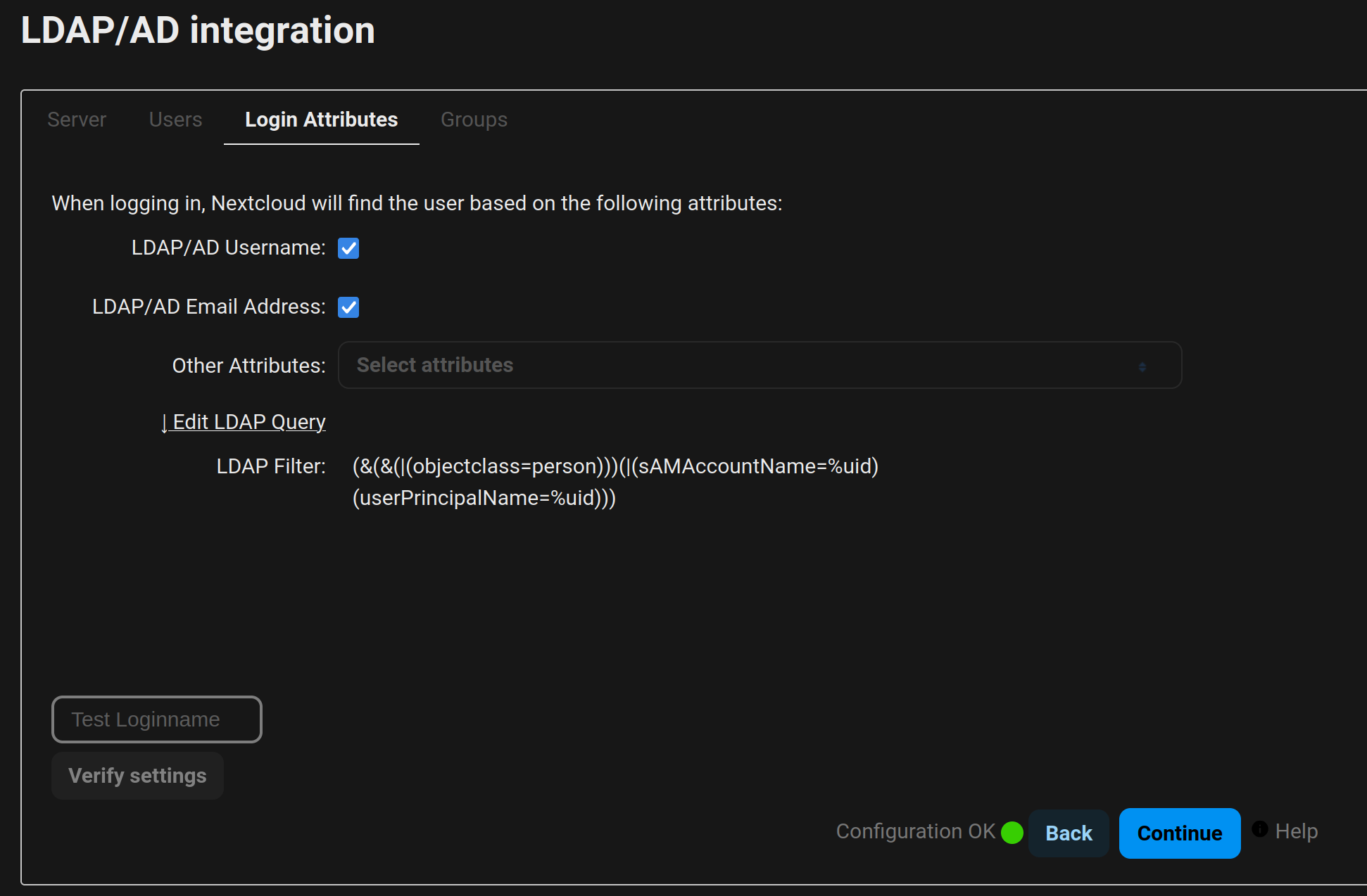

I tested it and these settings in Nextcloud administration - LDAP/AD integration worked. 192.168.3.31 is my NS8 samba server.
Server:
Users:
Login Attributes:
Groups:
Many thanks for your help! I also have these settings analogous to my domain .

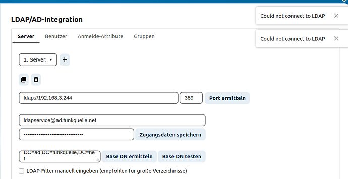

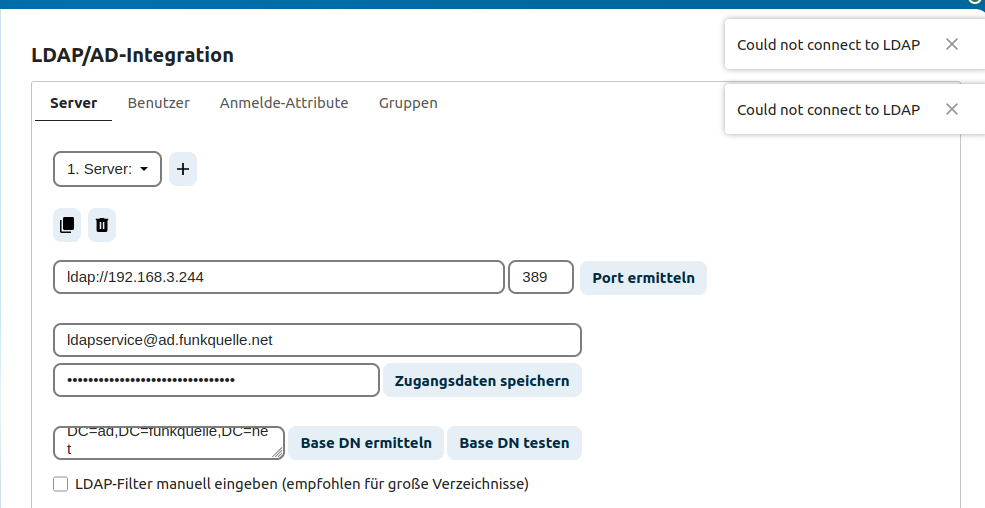

However, this does not yet work via the Nextcloud GUI. Do I have to change anything on the LXC container (Nextcloud) or on the VM (NS8)?

OK, I have changed the base DN from cn=ad to dc=ad. I still can’t communicate with the NS8 to set the other parameters.
Do I need to change anything else on the LXC container (Nextcloud) or on the VM (NS8)?

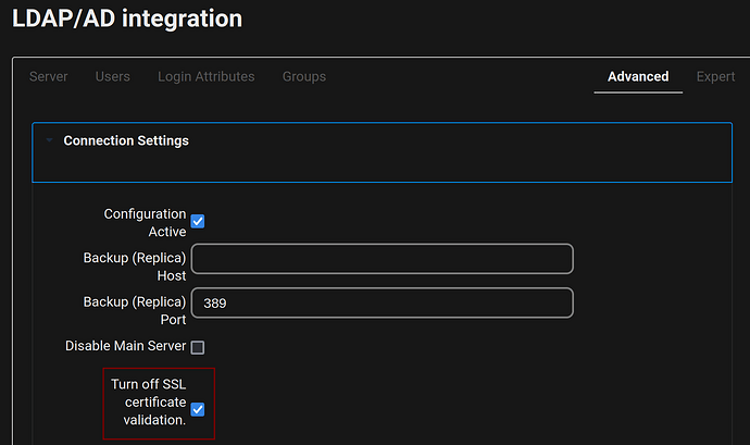

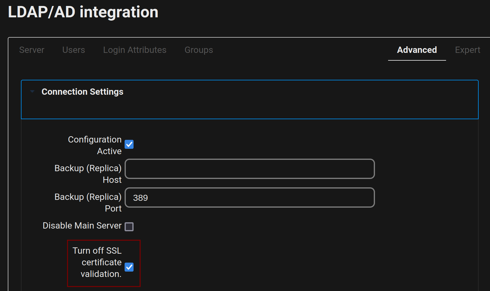

Maybe this one is missing?
