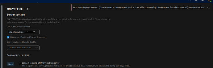

Error when trying to connect (Error occurred in the document service: Error while downloading the document file to be converted.) (version 9.0.4.50)
NethServer Version: NS8
Module: OnlyOffice
Hi everyone,
this is my first time trying to install OnlyOffice on NS8, but I just can't get it to work...
I followed Markus's instructions and I still get the same error.
I saw someone else had the same error and read the post, but I honestly don't understand the solution.
Can anyone help me?
TK.
I installed nextcloud and applied a DNS nexttest.xxxx.it.
I installed Onlyoffice like Markus instructions and applaied a DNS onlytest.xxxx.it
I installed Onlyoffice app in Nextcloud and then configure like Markus documentation
You have applied “https://nexttest.xxxx.it” in the configuration of the module?
You trying to apply “https:///onlytestxxxxx.xx” in the OnlyOffice config?
Please see this.
In the configuration module of Nextcloud in NS8: https://nexttest.xxxx.it
In the configuration module of Onlyoffice in NS8: https://onlytest.xxxx.it
In the configuratino of Nextcloud, the target of Docs address: https://onlytest.xxxx.it
Like Markus documentation.

Hi Markuz,
This is the config of Nextcloud:
Schermata del 2025-09-18 16-45-15
But,
If I type as you write in the documentation, I get this result:

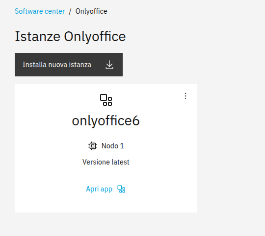

This is my istance:
TK
You installed onlyoffice:latest, I recommend to remove it and to install the current version 1.1.1 either via Software Center (you’d need to add the repository, see https://repo.mrmarkuz.com/)
or on CLI:
add-module ghcr.io/mrmarkuz/onlyoffice:1.1.1

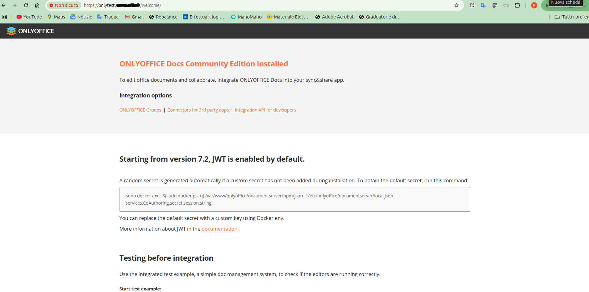

Done… Now it works.

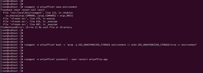

But…
As you can see, I’m on instance number 7, and I already had version 1.1.1 installed. I ran the commands I’m giving you screenshots of, and the first command still gives an error.
Anyway, now it works…

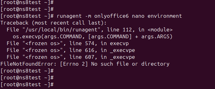

I could reproduce.
nano isn’t installed.
After installing by executing
dnf install nano
the command should work.
Sorry for my amateurism….:rofl:
