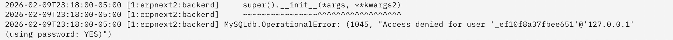

On a fresh install of ERPNext, I get that the user is unable to access the database
This results in the erpnext site responding with Internal Server Error
This happened with v3 and after reinstalling, also with v4.

I am on the v4 with app json. Here is the log. It seems there’s an issue when connecting to the db.
Here is the log, it is on pastebin as its too long to post here. How do i get the .env file?

After alot of back and forth with @kemboielvis22 we were finally able to get it running. We are still trying to figure out what isn’t happening during configuration.
Through the logs we were able to see that the database is not being initialized because the credentials provided in site-config.json.
To verify this, we ran:
runagent -m erpnext1
cat database.env
This gave us the json config that MariaDB is using, which looked something like:
MARIADB_AUTO_UPGRADE=1
MARIADB_DATABASE=erpnext
MARIADB_PASSWORD=db_pass
MARIADB_ROOT_PASSWORD=root_pass
MARIADB_USER=erpnext
We tested and made sure that the password specified actually worked, to do that, we logged into the mysql CLI
podman exec -it mariadb-app /bin/sh
# mariadb -u root -p
Once we verified that the root password was indeed correct, we proceed to check the config on ERPNext side
podman exec -it backend /bin/bash
bench --site all show-config -f json
Here is where we saw our mismatch:
 "frontend": {
  "db_host": "mariadb-app",
  "db_name": "_0e2779d88f97ac76",
  "db_password": "nHgKaCdxiGympKhH",
  "db_port": 3306,
  "db_socket": null,
  "db_type": "mariadb",
  "db_user": "_0e2779d88f97ac76",
  "redis_cache": "redis://redis-cache:6379",
  "redis_queue": "redis://redis-cache:6379",
  "redis_socketio": "redis://redis-cache:6379",
  "socketio_port": 9000
User name and password specified here resulted in ERROR 1045 (28000): Access denied for user '_0e2779d88f97ac76'@'localhost' (using password: YES)
After learning that the credentials specified in ERPNext don’t work, we manually edited the JSON, providing the root mysql credentials
vim sites/frontend/site_config.json
Once this was done, we had our second breaktrhough which was that now 2026-02-18T15:27:06-05:00 [1:erpnext7:backend] MySQLdb.OperationalError: (1049, "Unknown database '_0e2779d88f97ac76'")
At this point a simple reconfiguration from UI would be enough, but at the time, we decided to do it manually
bench --site frontend --force reinstall
With that, I could now access Frappe. To setup ERPNext, I simply reconfigured and viola, it worked!
