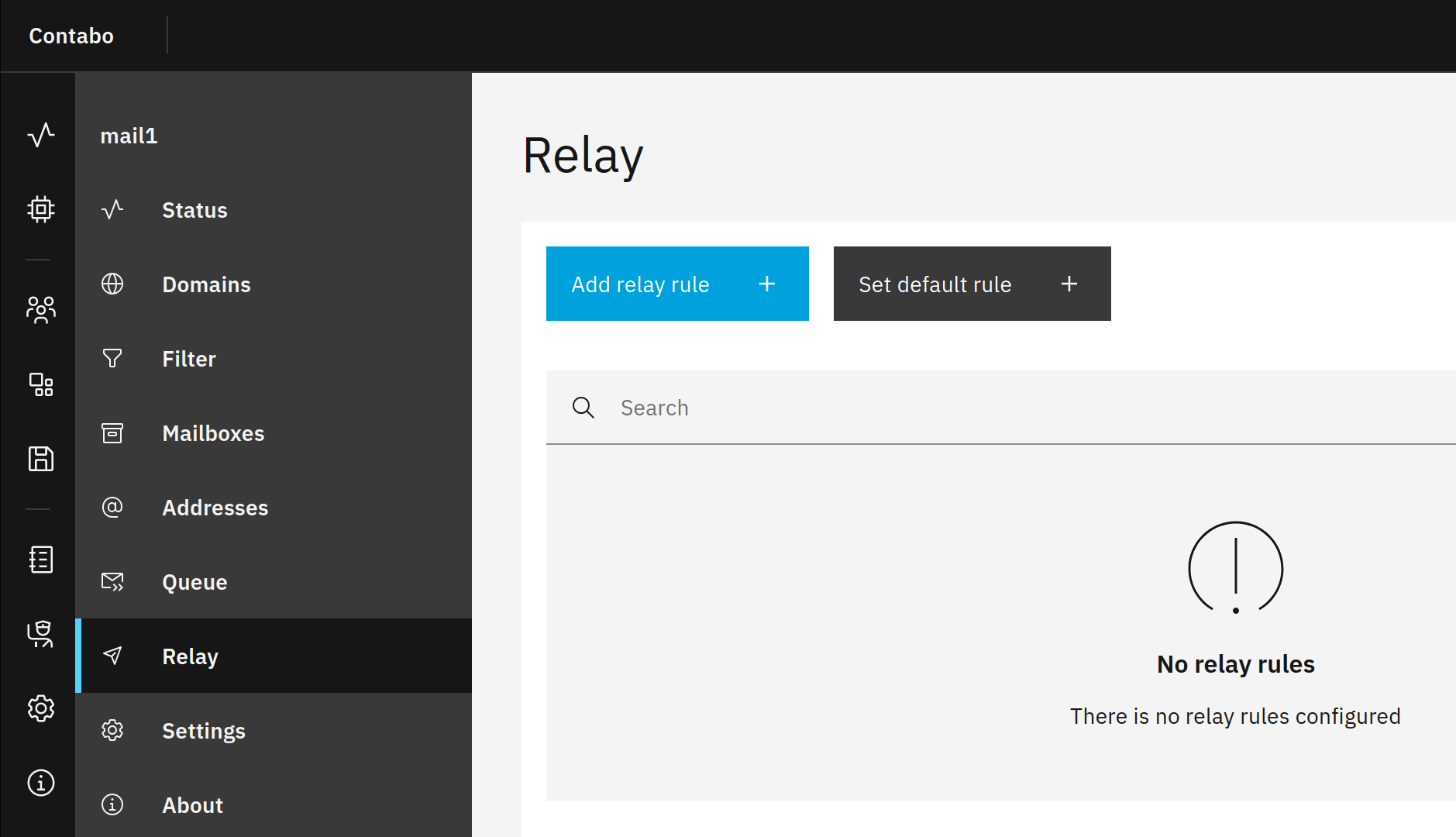

It seems the Hetzner smarthost www220.your-server.de is still used.
Please check the Relay settings in the cluster-admin, there should be no rule:
