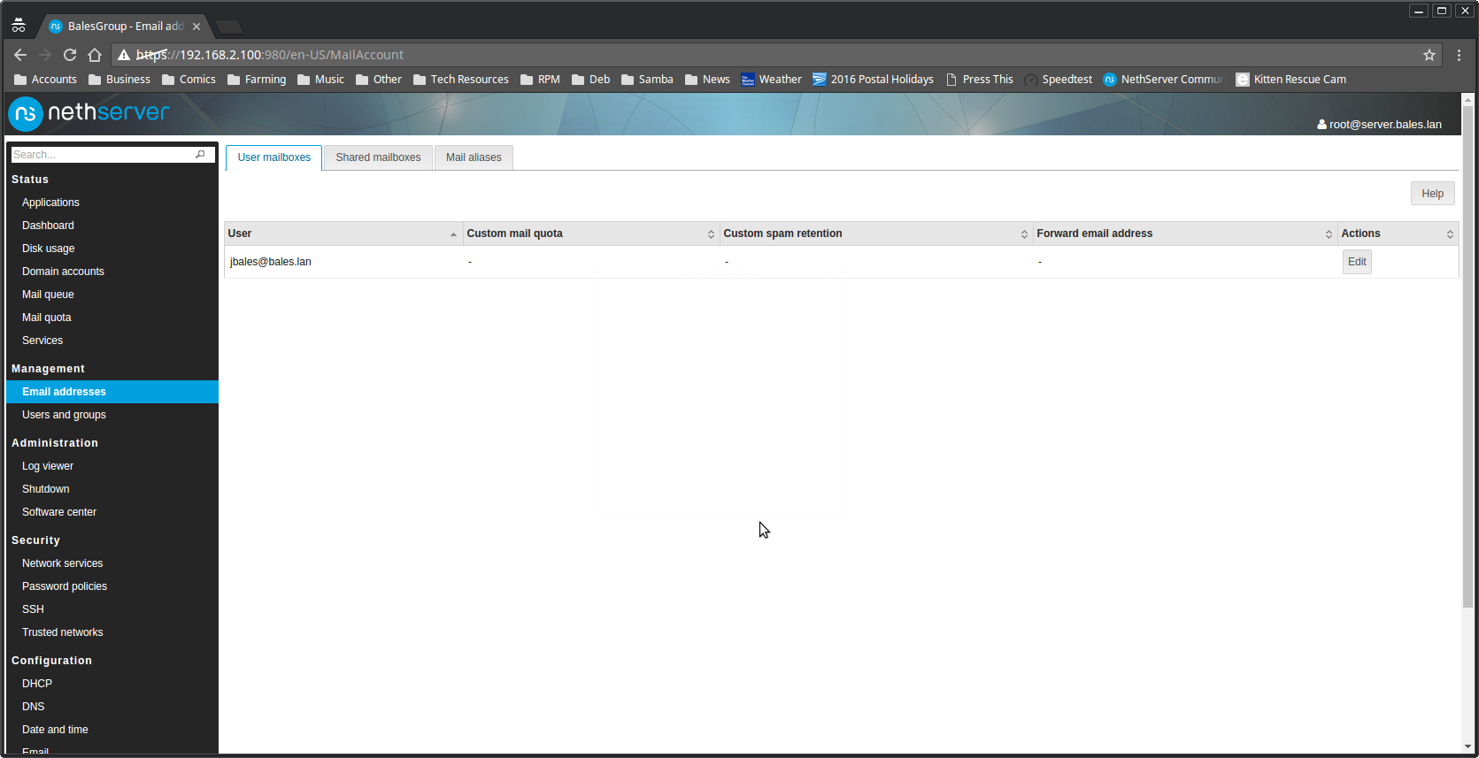

Email Addresses are still showing after removing SOGo
NethServer Version: 7 RC2
Module: SOGo
I installed SOGo Groupware and Email Address are now showing on the website. I removed SOGo and MariaDB, but Email Address are still showing on the website.
Next I from scratch installed OpenLDAP and then installed SOGo, then removed SOGo/MariaDB but his email address was still showing on the website.
Next I from scratch installed Samba AD, and then installed SOGo, them removed SOGo/MariaDB but his email address was still showing on the website.
The SOGo website is showing “Service Unavailable”
I also rebooted and shut the server down but the same results.
