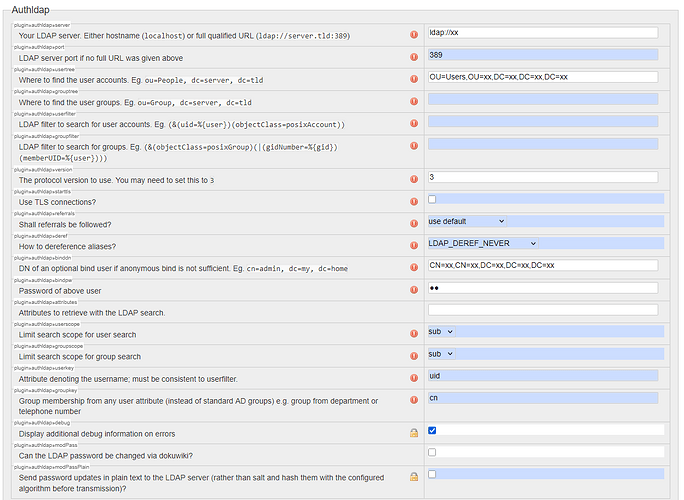

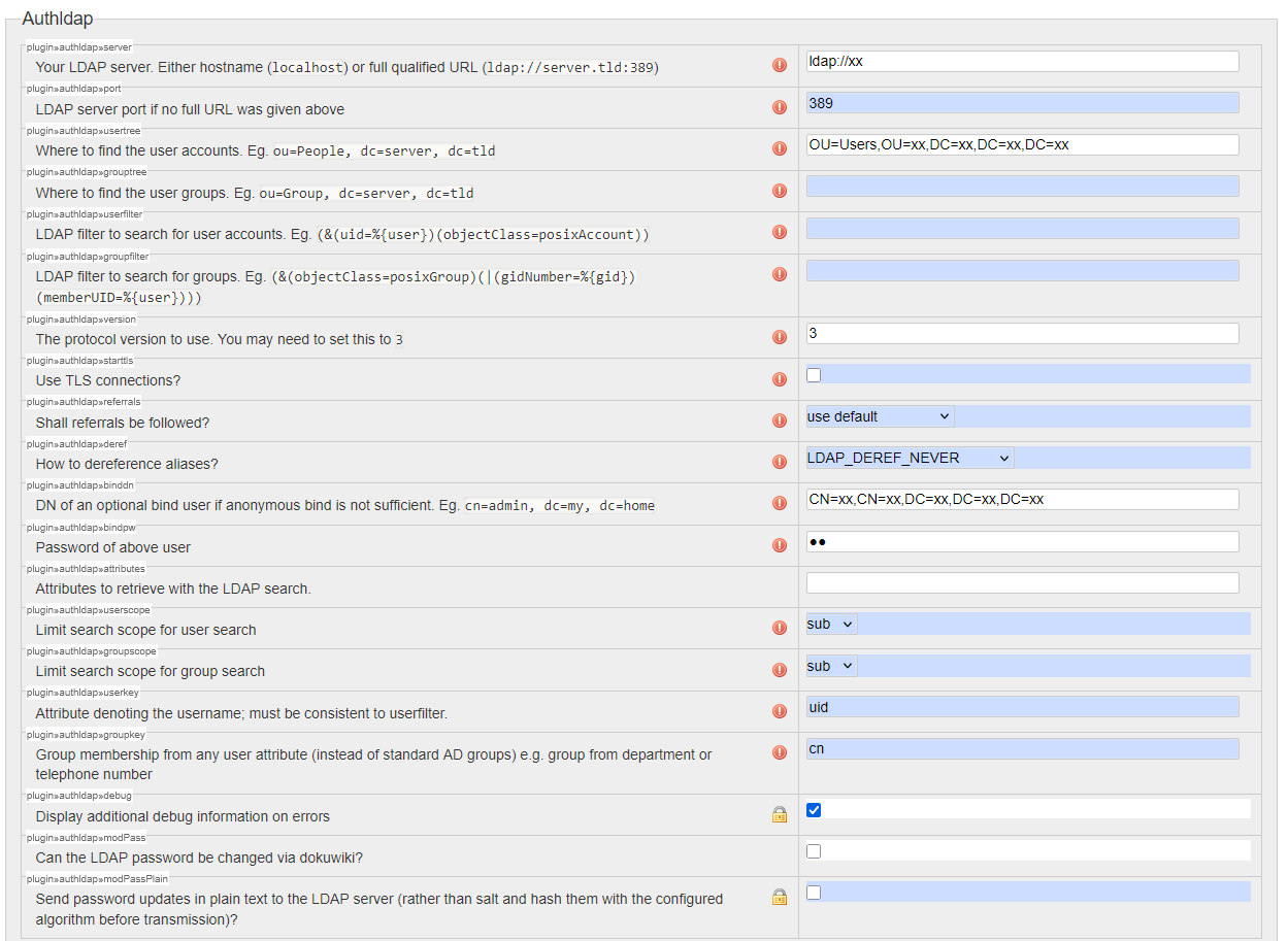

DokuWiki config:
  • I tried to log in with local user and set authad and/or authldap the same way as I have done in NethServer, but no luck.
  • I also tried authchained plugin, but still cannot log in with AD users.
Possibly I am doing something wrong, or some of the config changes left something unnecessary in the config files, but am stuck.

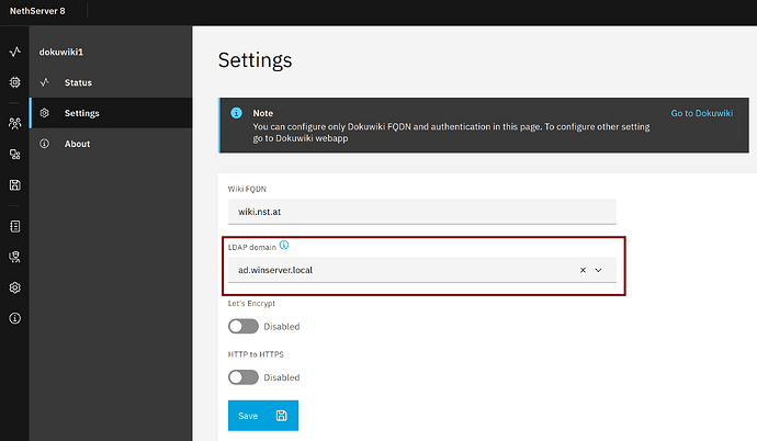

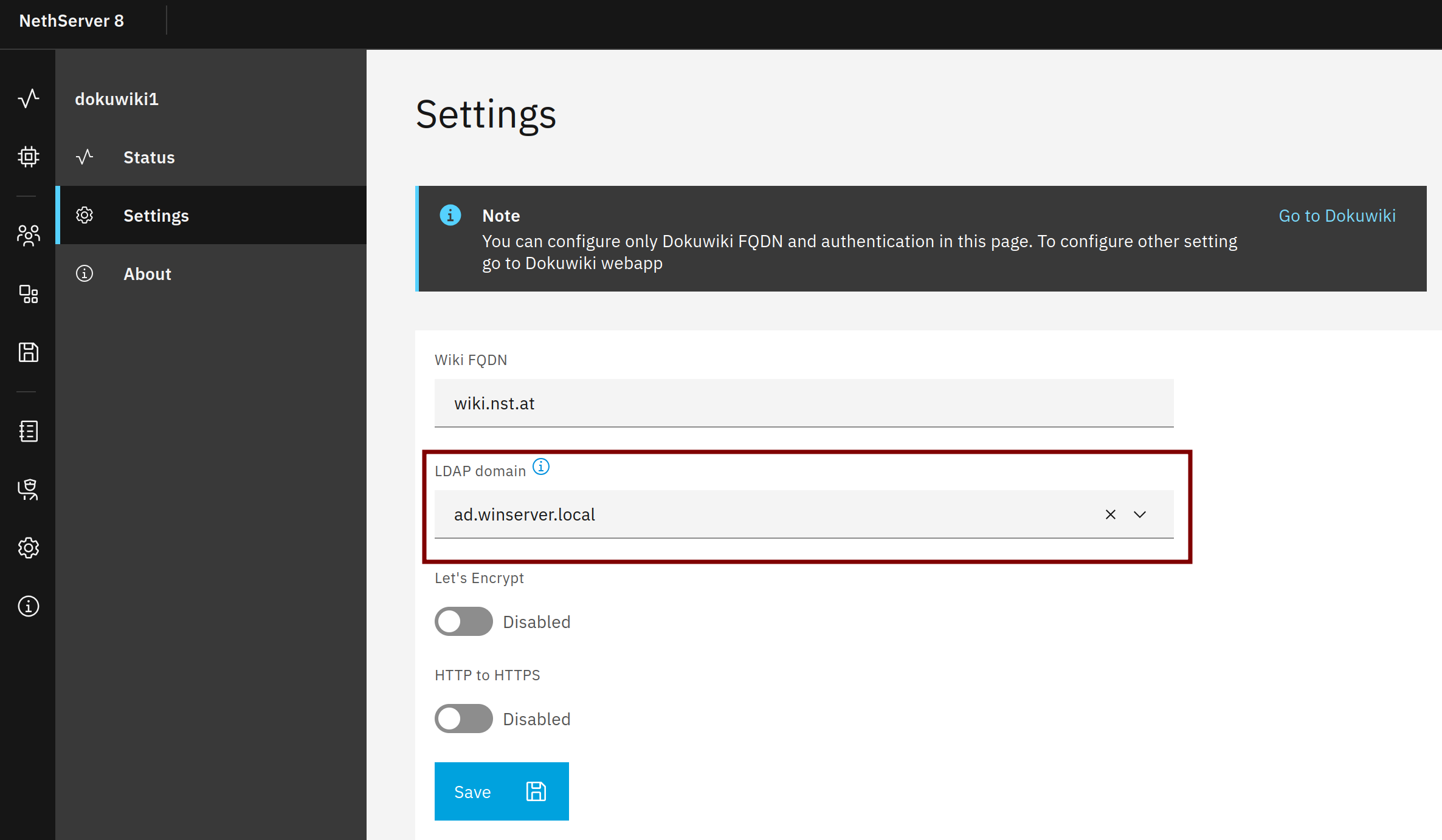

set up the ldap in the domain page of cluster admin the configuration will be automatic in ns8-dokuwiki if you allow the ldap login
Yes, no change in the dokuwiki config needed. After configuring Dokuwiki in the NS8 app settings you can select the LDAP domain:

The domain was not configured when I first tried, so I choose Internal authentication. Later I tried to change it to the domain I configured in the meantime in NS, but seemingly something is locked up.
Anyhow I made a new instance and now it simply works by selecting the domain in NS.
