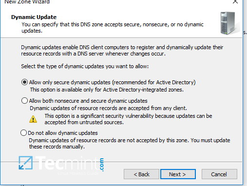

I may be wrong but, aren’t DDNS updates already supported by Samba internal DNS? For example, Manage Samba4 AD Domain Controller DNS and Group Policy from Windows - Part 4
At least AD Windows clients may set their IP on their own (?).

Yes, dynamic update are supported by Samba DNS, and by default is switched on. I got at that detail in a different way:
