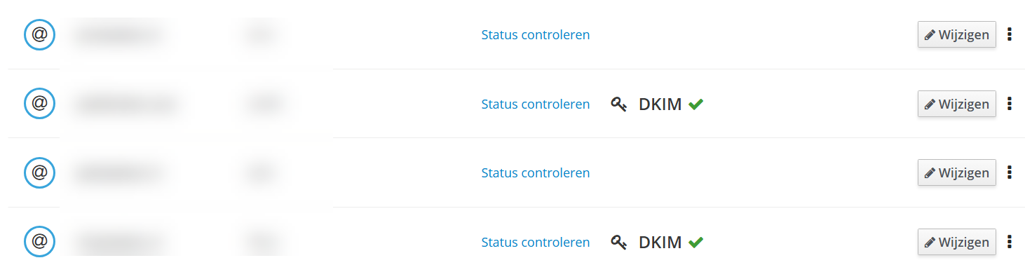

Upon checking things, I see for some users I have a DNS/txt record with DKIM in place, however apparently I have not saved it in NS7. Therefore, these don’t have the OK checkmark.

I’d recommend to migrate and setup the missing DKIM records from the NS8 so you don’t need to touch the NS7 and have a working fallback if something goes wrong during migration.
The already used DKIMs are migrated from NS7 to NS8 so it’s also possible to set it on the NS7 before migration.
The “blackout” period depends on what TTL is configured at your DNS provider.
