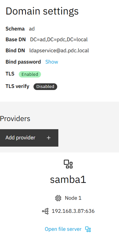

In NethServer 8, is it possible to configure LDAP to work without TLS (port 636)?

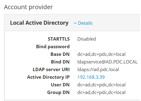

I’m asking because I have an internal mail server and I’m still using NethServer 7, which communicates with it for user synchronization. In NethServer 7, I noticed that TLS is disabled by default, and it uses port 389.

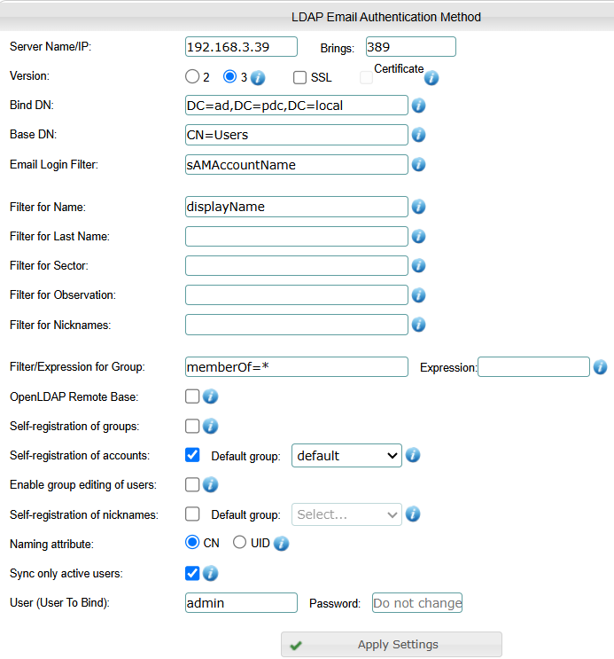

The real issue is that when I configure my mail server to authenticate with NethServer 8, I end up getting an error.
Current setting mail server
I’ve tried configuring it in every possible way, which is why I’m asking if there’s a way to disable TLS in NethServer 8 so I can attempt synchronization.
The last picture you shared i can see that Basedn is wrong, binddn too, port must be over 636 ldaps (ssl checked)
Ldaps over 636 is a mandatory…
Yes to protect the password, TLS is mandatory by default. If your network is already secured and TLS is not a requirement for you, look at this thread:
Thanks, davidep.
It’s work.
