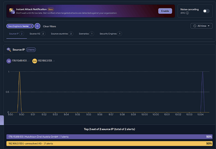

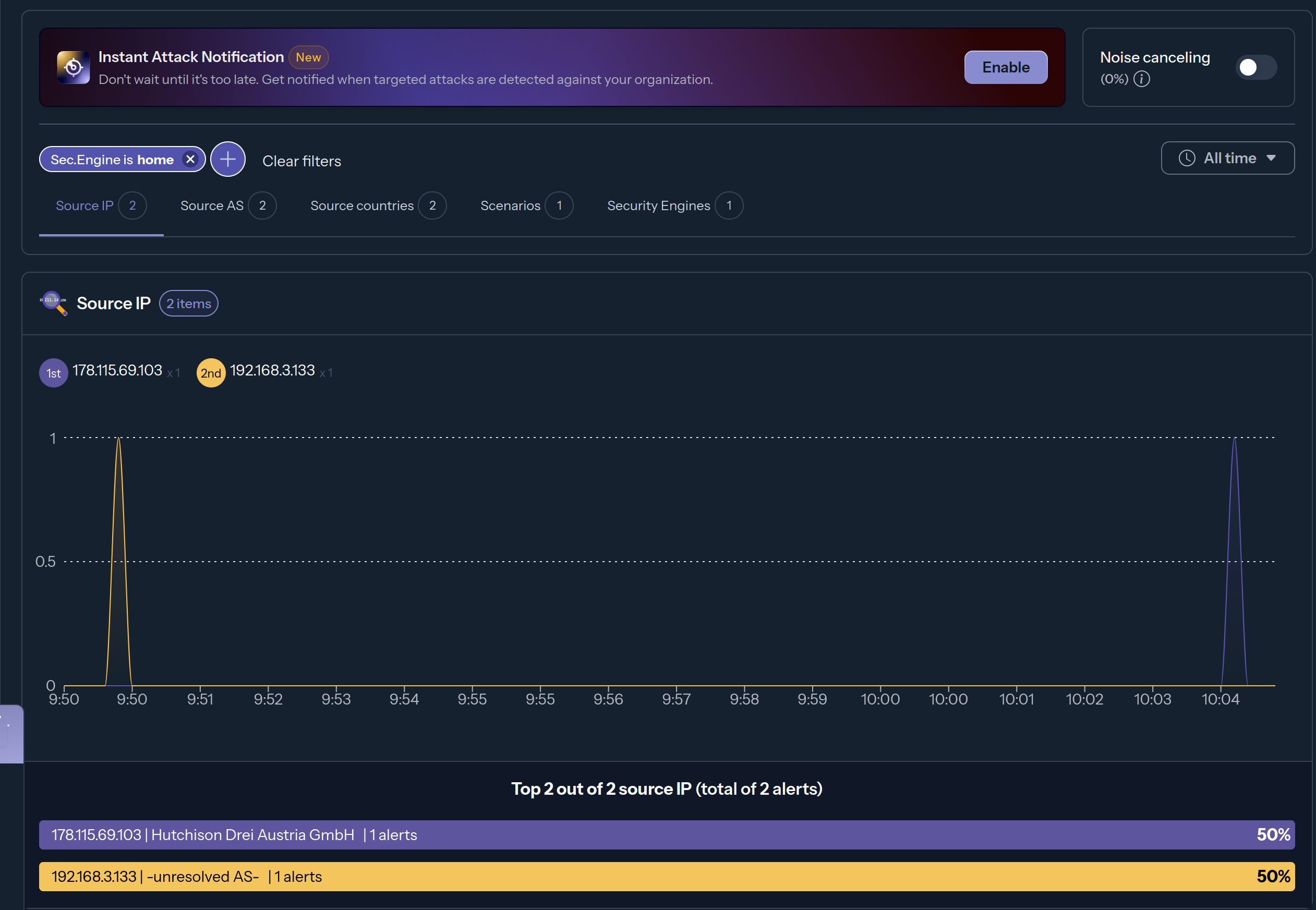

I tested crowdsec now behind NethSecurity using SSH from my mobile. I set a port forward of the SSH port 22 on the NethSec to the NS8.
After some wrong SSH login attempts, I can see the following in the logs:
2025-05-06T10:04:19+02:00 [3:crowdsec5:crowdsec5] time="2025-05-06T08:04:19Z" level=info msg="Ip 178.115.69.103 performed 'crowdsecurity/ssh-bf' (9 events over 37.999906312s) at 2025-05-06 08:04:19.495267988 +0000 UTC"
2025-05-06T10:04:20+02:00 [3:crowdsec5:crowdsec5] time="2025-05-06T08:04:20Z" level=info msg="(localhost/crowdsec) crowdsecurity/ssh-bf by ip 178.115.69.103 (AT/25255) : 4m ban on Ip 178.115.69.103"
The alerts are also shown on the crowdsec page, I tested using a wrong password from LAN and WAN and both worked.
Also a notification mail is sent. After the ban no connection from my mobile to the NS8 is possible anymore until it gets unbanned.

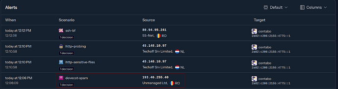

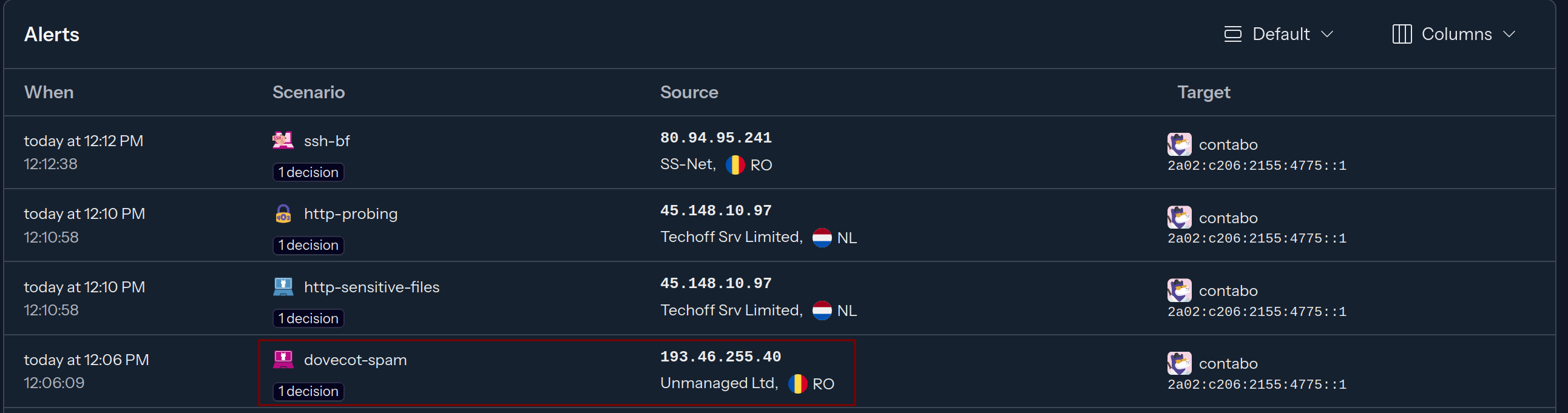

I just checked with 2 Adresses for wich I got lots auf notifications:
45.144.212.223 should be banned for 848 Miuntes, its not in the ruleset, I have over 200 Notifications in the last 2 days
193.46.255.40 should be banned for 2312 Miuntes, its not in the ruleset, I have over 500 Notifications in the last 2 days

I can’t reproduce, I found the same IP on one of my Nethservers (Debian)
and the IP is listed in the ruleset:
root@contabo:/var/lib/nethserver/crowdsec6/state# nft list ruleset | grep 193.46.255.40
			     80.94.95.241 timeout 11m55s expires 9m44s508ms, 193.46.255.40 timeout 19m56s expires 11m15s512ms }
It shows postfix/smtpd just once which I think is normal as the connection gets lost after a ban.
Here is my cluster log (I searched for the malicious IP) that shows that dovecot isn’t attacked anymore from that IP after the ban.
2025-05-06T12:01:48+02:00 [1:mail1:postfix/smtpd] warning: hostname hostingmailto189.statics.servermail.org does not resolve to address 193.46.255.40: Name has no usable address
2025-05-06T12:01:48+02:00 [1:mail1:postfix/smtpd] connect from unknown[193.46.255.40]
2025-05-06T12:01:49+02:00 [1:mail1:postfix/smtpd] Anonymous TLS connection established from unknown[193.46.255.40]: TLSv1.2 with cipher ECDHE-RSA-AES256-GCM-SHA384 (256/256 bits)
2025-05-06T12:01:50+02:00 [1:mail1:dovecot] auth-worker(54909): conn unix:auth-worker (pid=54851,uid=90): auth-worker<1>: ldap(office1,193.46.255.40): unknown user
2025-05-06T12:01:52+02:00 [1:mail1:postfix/smtpd] warning: unknown[193.46.255.40]: SASL LOGIN authentication failed: (reason unavailable), sasl_username=office1
2025-05-06T12:01:52+02:00 [1:mail1:postfix/smtpd] lost connection after AUTH from unknown[193.46.255.40]
2025-05-06T12:01:52+02:00 [1:mail1:postfix/smtpd] disconnect from unknown[193.46.255.40] ehlo=1 auth=0/1 rset=1 commands=2/3
2025-05-06T12:01:52+02:00 [1:mail1:rspamd] (rspamd_proxy) <2ac27a>; milter; rspamd_milter_process_command: got connection from 193.46.255.40:44838
2025-05-06T12:03:58+02:00 [1:mail1:postfix/smtpd] warning: hostname hostingmailto189.statics.servermail.org does not resolve to address 193.46.255.40: Name has no usable address
2025-05-06T12:03:58+02:00 [1:mail1:postfix/smtpd] connect from unknown[193.46.255.40]
2025-05-06T12:03:58+02:00 [1:mail1:postfix/smtpd] Anonymous TLS connection established from unknown[193.46.255.40]: TLSv1.2 with cipher ECDHE-RSA-AES256-GCM-SHA384 (256/256 bits)
2025-05-06T12:03:58+02:00 [1:mail1:dovecot] auth-worker(54912): conn unix:auth-worker (pid=54851,uid=90): auth-worker<7>: ldap(faxuser,193.46.255.40): unknown user
2025-05-06T12:04:00+02:00 [1:mail1:postfix/smtpd] warning: unknown[193.46.255.40]: SASL LOGIN authentication failed: (reason unavailable), sasl_username=faxuser
2025-05-06T12:04:00+02:00 [1:mail1:postfix/smtpd] lost connection after AUTH from unknown[193.46.255.40]
2025-05-06T12:04:00+02:00 [1:mail1:postfix/smtpd] disconnect from unknown[193.46.255.40] ehlo=1 auth=0/1 rset=1 commands=2/3
2025-05-06T12:04:00+02:00 [1:mail1:rspamd] (rspamd_proxy) <c08a7f>; milter; rspamd_milter_process_command: got connection from 193.46.255.40:37478
2025-05-06T12:06:08+02:00 [1:mail1:postfix/smtpd] warning: hostname hostingmailto189.statics.servermail.org does not resolve to address 193.46.255.40: Name has no usable address
2025-05-06T12:06:08+02:00 [1:mail1:postfix/smtpd] connect from unknown[193.46.255.40]
2025-05-06T12:06:08+02:00 [1:mail1:postfix/smtpd] Anonymous TLS connection established from unknown[193.46.255.40]: TLSv1.2 with cipher ECDHE-RSA-AES256-GCM-SHA384 (256/256 bits)
2025-05-06T12:06:09+02:00 [1:mail1:dovecot] auth-worker(54940): conn unix:auth-worker (pid=54851,uid=90): auth-worker<7>: ldap(nagata,193.46.255.40): unknown user
2025-05-06T12:06:09+02:00 [1:crowdsec6:crowdsec6] time="2025-05-06T10:06:09Z" level=info msg="Ip 193.46.255.40 performed 'crowdsecurity/dovecot-spam' (5 events over 8m36.721496291s) at 2025-05-06 10:06:09.145842974 +0000 UTC"
2025-05-06T12:06:09+02:00 [1:crowdsec6:crowdsec6] time="2025-05-06T10:06:09Z" level=info msg="(localhost/crowdsec) crowdsecurity/dovecot-spam by ip 193.46.255.40 (RO/47890) : 20m ban on Ip 193.46.255.40"
2025-05-06T12:06:11+02:00 [1:mail1:postfix/smtpd] warning: unknown[193.46.255.40]: SASL LOGIN authentication failed: (reason unavailable), sasl_username=nagata
2025-05-06T12:06:11+02:00 [1:mail1:postfix/smtpd] lost connection after AUTH from unknown[193.46.255.40]
2025-05-06T12:06:11+02:00 [1:mail1:postfix/smtpd] disconnect from unknown[193.46.255.40] ehlo=1 auth=0/1 rset=1 commands=2/3
2025-05-06T12:06:11+02:00 [1:mail1:rspamd] (rspamd_proxy) <4be176>; milter; rspamd_milter_process_command: got connection from 193.46.255.40:58450
Looks like @stephdl was right and the servis hung for some reasons. After a reboot it seems to work now.
