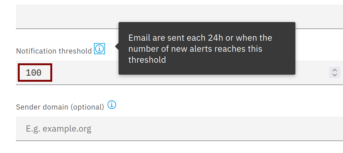

I just ran a test from my mobile network with several incorrect logins to my Nextcloud instance. The IP address is blocked after four failed attempts, but I do not receive an email notification, even though the correct email address is stored. I cannot find anything useful in the log. Does anyone know what the problem is?
Did you setup the notification threshold?
By default you get 1 mail each 24h or after 100 alerts.
Oh, I hadn’t noticed/paid attention to that setting before.
Thank you @mrmarkuz :pray:
if you want to go back to the previous behavior, set the bulk number to 1 and you will have a notification for any decision
