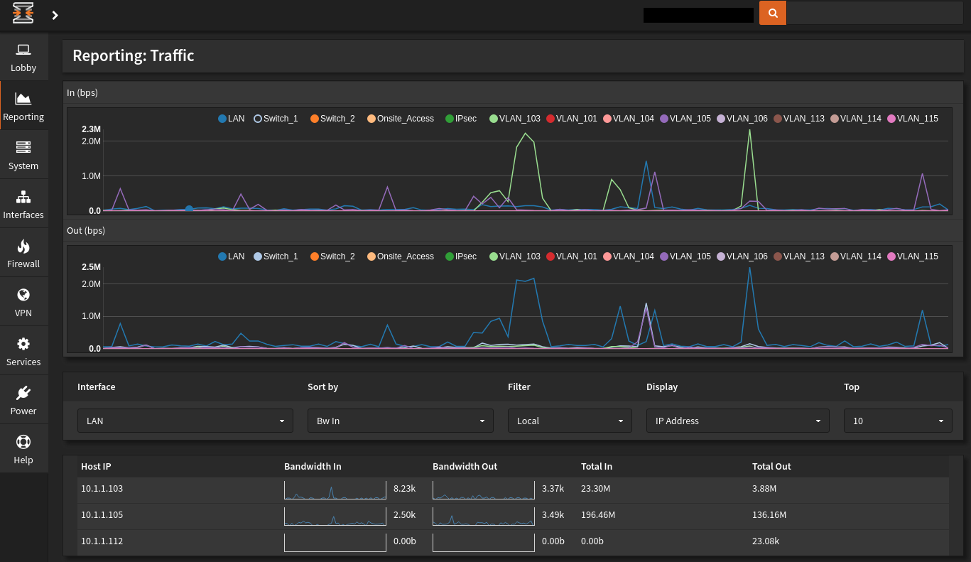

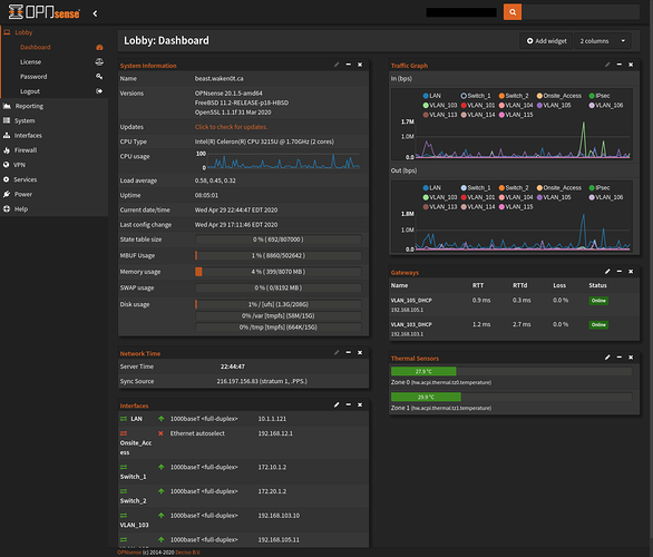

I’m attaching a couple of images. At the moment, we only have two Cable Modems set up: VLAN ID 103 and 105.
You can see their traffic in these graphs.
