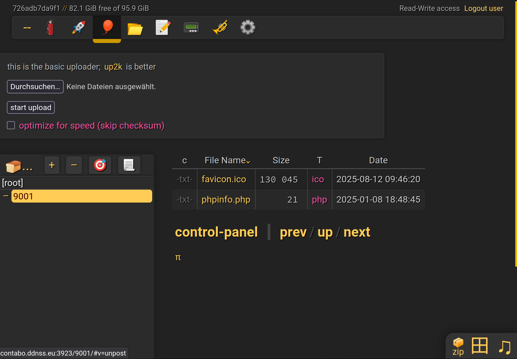

To use copyparty in webserver:
Open port in firewall:
firewall-cmd --permanent --add-port=3923/tcp
firewall-cmd --reload
Enter webserver env:
runagent -m webserver1
Run copyparty:
podman run --rm -it -p 3923:3923 -v "websites:/w:z" docker.io/copyparty/ac:1.19.1 -a user:secret -v /w::rw,user --usernames
The first -v "websites:/w:z" podman option mounts the websites volume to the containers /w directory.
The -a user:secret sets a user account with password in copyparty.
The -v /w::rw,user configures the /w directory to be accessible by user which has rw permissions.
Browse to https://webserverurl:3923 and login with user user and password secret.
You should be able to upload files to the webserver vhost dirs, for example 9001.

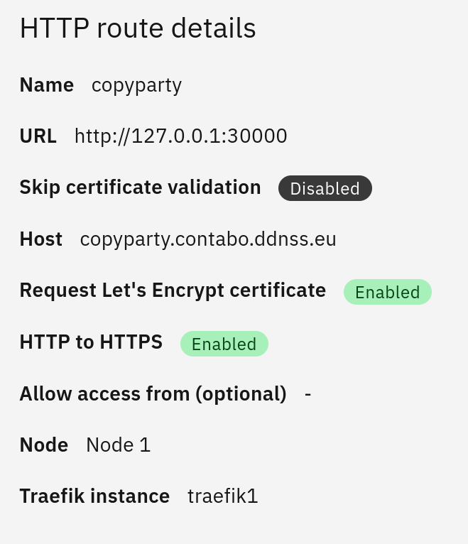

It’s also possible to use copyparty via traefik, this way we avoid opening the firewall port.
So it’s possible to run copyparty in any app and connect it to any volume and access it via HTTPS (including letsencrypt if wanted)
Create the HTTP route:
