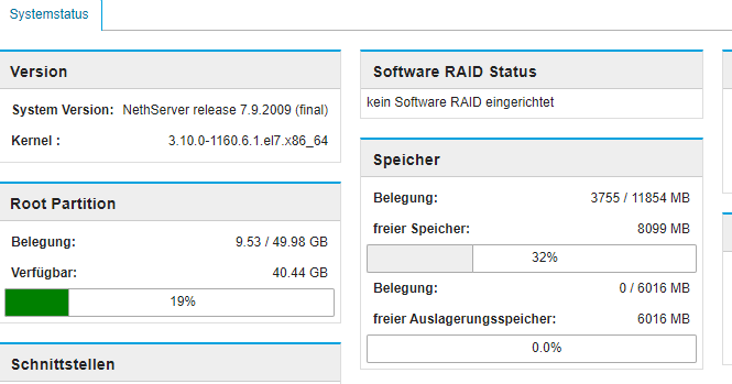

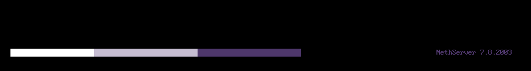

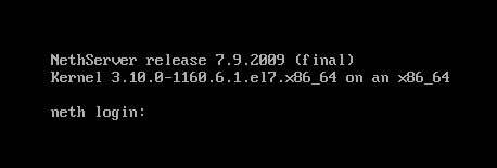

Thanks for helping, attached some screens for unserstanding
1
3
And Software Center is going nuts:
