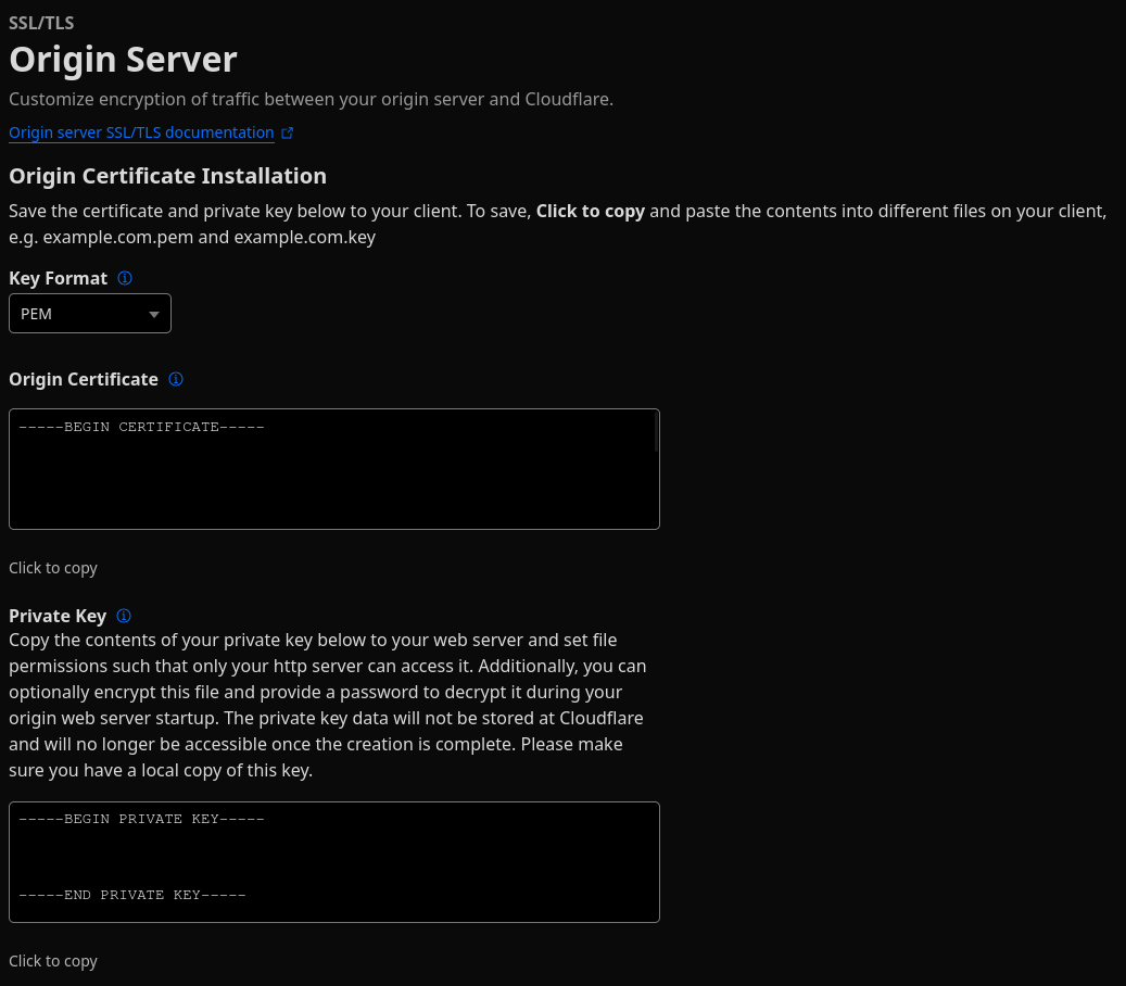

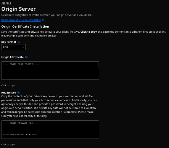

The cloudflare webUI looks like this (Keys redacted for privacy):

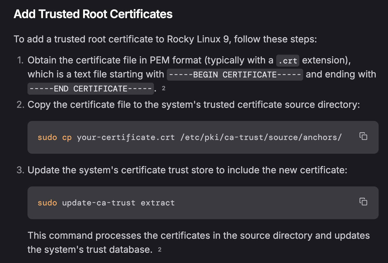

This means that the system was unable to validate that the certificate came from a trusted issuer, which is because it didn’t. The remedy, I expect, is to add Cloudflare’s root CA cert to the OS’s trusted root store. The way you’d do that, in turn, depends on the base OS–if you’re using Rocky/Alma 9, according to Brave Search AI, this is how you’d do that:
Thanks for pointing me in the right direction! You were right, I had to copy the cert to the server via scp then add it to the trust.
The cert Cloudflare gives from the page where the private key comes from isn’t the correct cert however, I had to add their main origin CA which can be fetched from here: Cloudflare origin CA · Cloudflare SSL/TLS docs
