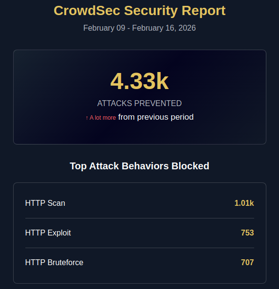

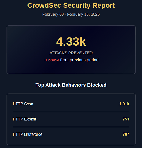

Over the past week, I’ve been running Crowdsec to see what’s happening to the server on the internet.
Today, for the first time since I set it up, I received a notification from Crowdsec that it had prevented 4.33k attacks in the past week. Since only http and https are currently allowed on the router, the report affects them. I’m attaching a picture of it.
These are huge numbers for me, I’ve never seen so many attacks on my servers and routers, I hope it will decrease.
The report doesn’t say what he did with the attacks, blacklisted him, banned him, or anything else. I can’t find a list of banned addresses anywhere.
Is this available to view somewhere?
Thank you for your help
You need to login into the Crowdsec website, all details are there. Please use a new topic if you want to discuss more.
