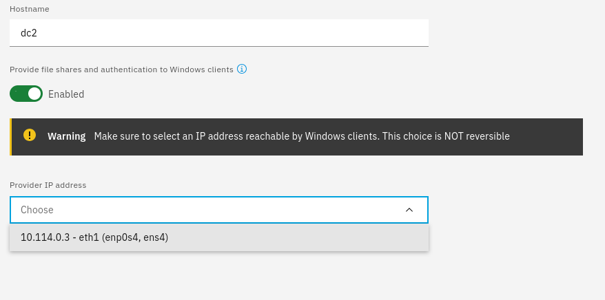

When a DC is added you can enable the switch and select a LAN IP
Other DCs will have the switch disabled. They are just local node replicas for cluster applications.
