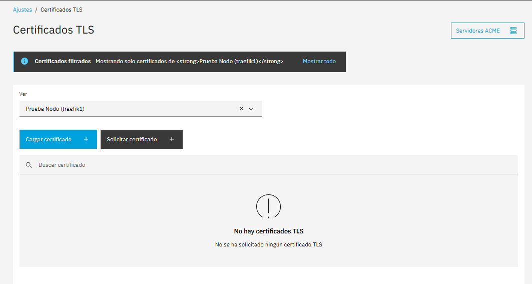

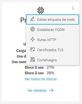

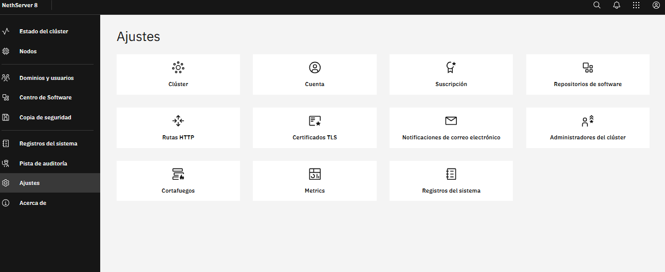

Hello Ladys and Gentleman, i try to find the solution to renew an existing certificate. NS7 has an Button for that, in NS8 i did not find a possibility for this, can someone lead me a hand?
yes, i had a certificate but it endet 1 day ago and now it not longer possible to receive emails by mobile devices
Usually the certs should renew automatically as it was in NS7.
There was a bug when certificates for NS8 apps were obtained on the TLS certificates page in NS8. The apps have their own certificate and it doesnât need to be obtained manually.
Please check in following thread if your system is affected and how to remove the wrong certs and make renewal work again:
i remember that the automatic renew also in NS7 never worked on my side. is there a possibility to start the renew manually? and i think the other thread is not for my prob. i have only one FQDN and it the correct one. there is also no possibility to delete it, because if i want then making a renew it comes up with an error about an existing cert. would it work if i delete the cert and also the entry in configs/_default_cert.yml and then renew it?
