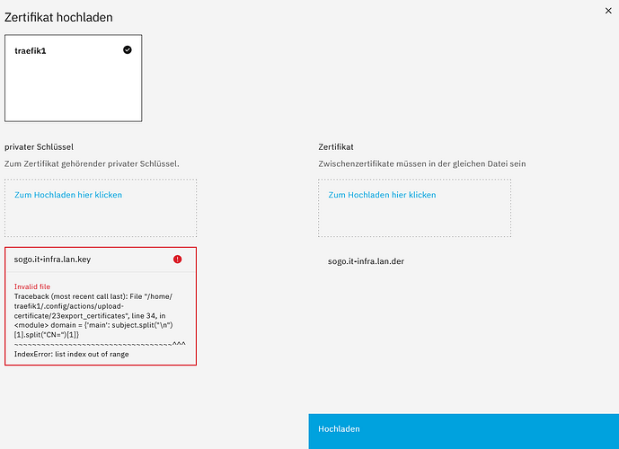

When I try to upload the key and cert I get the following error:
What does the - list index out of range - mean?

It seems an error with getting the domain out of the certificate subject but the cert is uploaded tough.
Usually the subject should be CN=sogo.it-infra.lan.
Could you please check the certificate subject and share it so we can hopefully fix this bug.

Could it be the Windows/Unix line break thing? You could check the certificate with for example Notepad++.
The subject is splitted by newline \n but in Windows it’s \r\n
Did you do it the same way this time? Other editor?

I can reproduce the error.
I think it’s due to the Windows line breaks in the certificate/key file created by the Windows CA and I think it’s a bug (and changed the topic category).
I converted (save as) a certificate and a key using Windows line breaks using gedit and got the same error on upload.
The only strange thing is that it worked for the older certificates…
You could try to convert the certificate and the key to Unix line breaks using Notepad++ and check if the upload works.
It seems to be another issue. I tried a cert using Unix line breaks and got the same error so I need to recheck…

Following is used to get the subject:
openssl x509 -noout -subject -in yourcertificate.crt -nameopt sep_multiline -nameopt utf8
Then the domain is extracted out of the subject.
I checked a certificate from CyberGhost and the CN was just a bunch of letters instead of a domain. As far as I can see it’s just used for the redis key name so as long as it’s not empty it shouldn’t matter.
