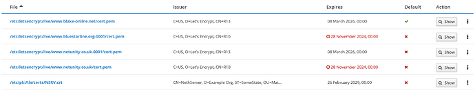

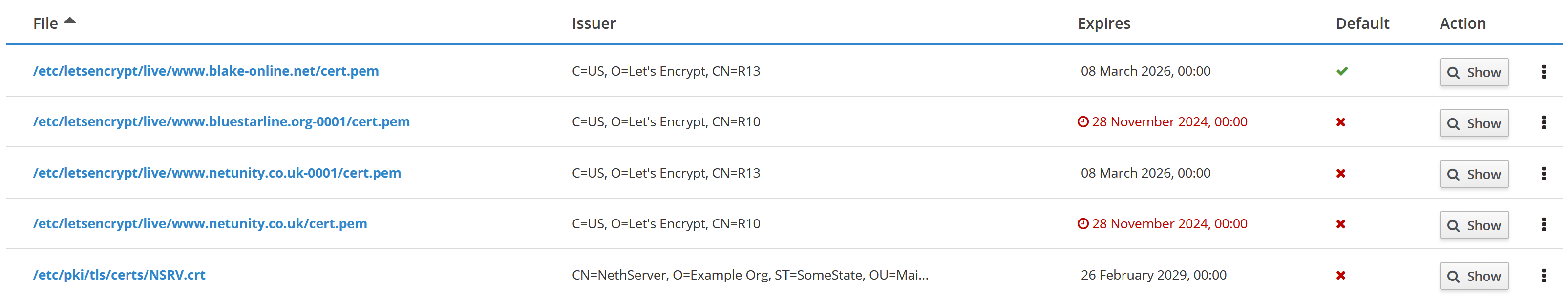

An additional bit of info, under “certificates” I have
That looks like I should know what to do with it, but I don’t :frowning:
I think the errors are just about the old certificates, the current default blake-online.net cert seems working. You could check the certificate by clicking the “Show” button. It should include all websites under “X509v3 Subject Alternative Name:”
Do you still get the errors when you remove the old certs that are not in use?

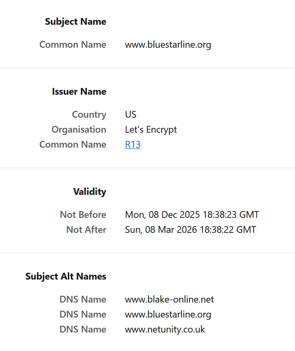

I just had a look: when I inspect the certificate that is used whenever I go to any of the three sites, I get:
It looks like its using the same cert for all sites, as you say, and the “not before” date of late yesterday fits in with what I was doing yesterday trying to run certbot renew, so I think I might be OK now. I also hit the “show” button and got this
” X509v3 Subject Alternative Name: DNS:www.blake-online.net, DNS:www.bluestarline.org, DNS:www.netunity.co.uk" so they are all there

As the sites are already working you don’t need it.
I think the old certs are still saved somewhere but you can ignore the errors.
You could check if the old certs are in the /etc/letsencrypt/live directory and move them away.
Important is this one (as it contains the domains of your sites) and it should be renewed automatically before it expires:
Just a thought….thr problem I have is related only to certificates. I used to run without certificates. Is it possible to simply delete the certificates/certbot system and re-install? That might get it to run clean: everything else runs perfectly.
Thanks
