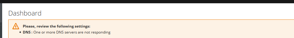

Can you help me to fix this issue?
(upload://mMWmbhxu6CUEfGCsMNX6GcTywcZ.png)
I found out that all my users and group was disappeared on the smb? May I know how can i back it again?

Thanks @Andy_Wismer here’s my version
before I’m using this cockpit 9090 but today I encountered issue also to access this. I tried also to restore to cli but the issue still the same
