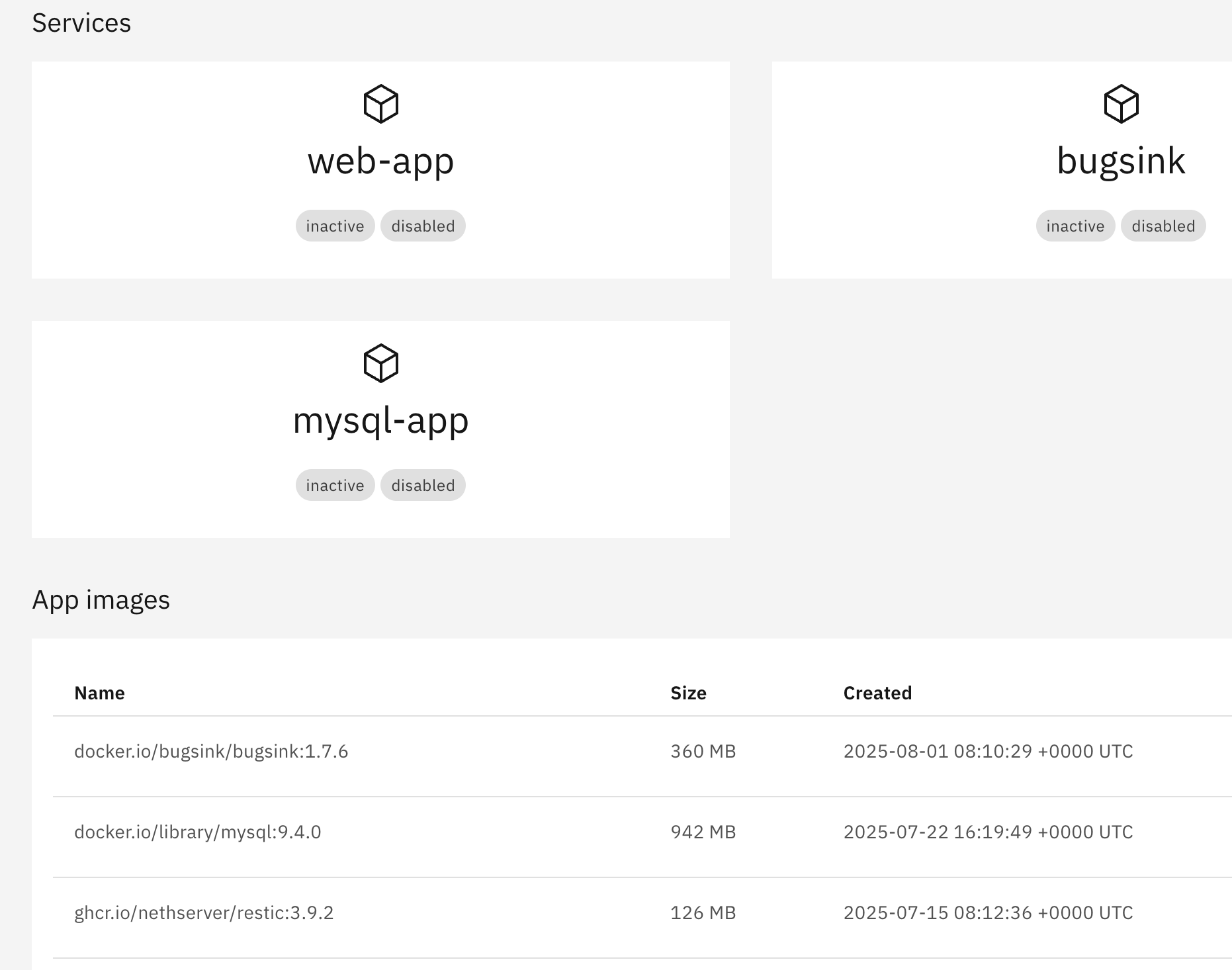

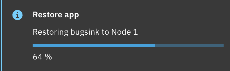

Restore (replace existing) spins at 67% indefinitely in software center. 2 instances still available where the resore one in progress is inactive.
@mrmarkuz how can I forcefully kill this task please?
TIA
ps. In general ‘How to kill an ongoing task from the cli’ without disturbing integrity of task system (Redis etc?)
I don’t know how to stop the task but it could help to stop the rsync or restore-db container so the task stops with an error.

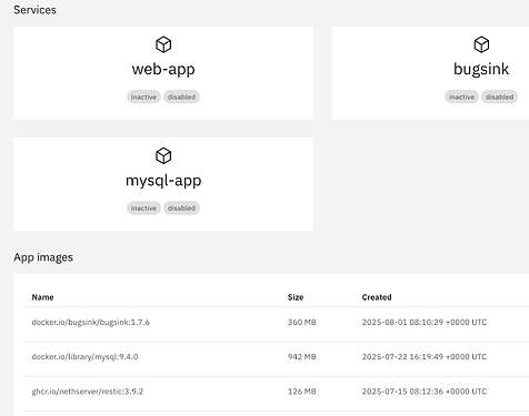

Thanks, I already removed the bugsink instances, so any trace of them is gone. Except for the task that is still coming back (after refresh page/login/out) even tho all bugsink instances are gone.
Is there a way to list (ongoing) tasks, and to whom (who/what is managing tasks) they belong? Something is queing something and the queue still contains that unwanted task :slight_smile:

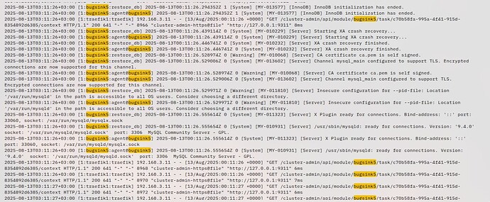

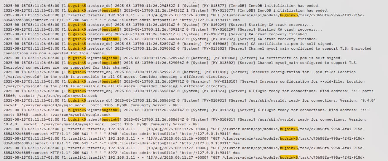

I dont know why it remains like this when restoring
As you can see in the following image the db sucessfully restores that means the issue is in the configure traefik on the restore module.
@mrmarkuz Any hint on how to handle this
