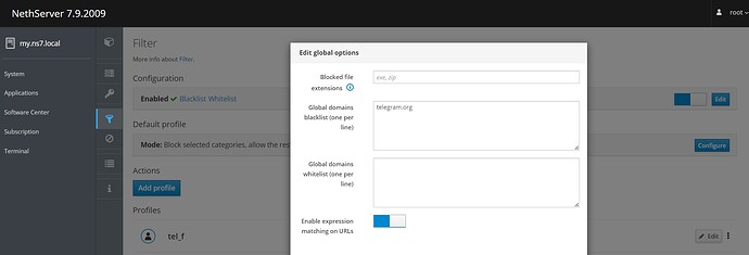

In NS 7 it was all very simple Web proxy & Filter - Filter - Enable Global Blacklist. I added telegram.org and it no longer works in my network. How can I do this in NethSecurity 8?
