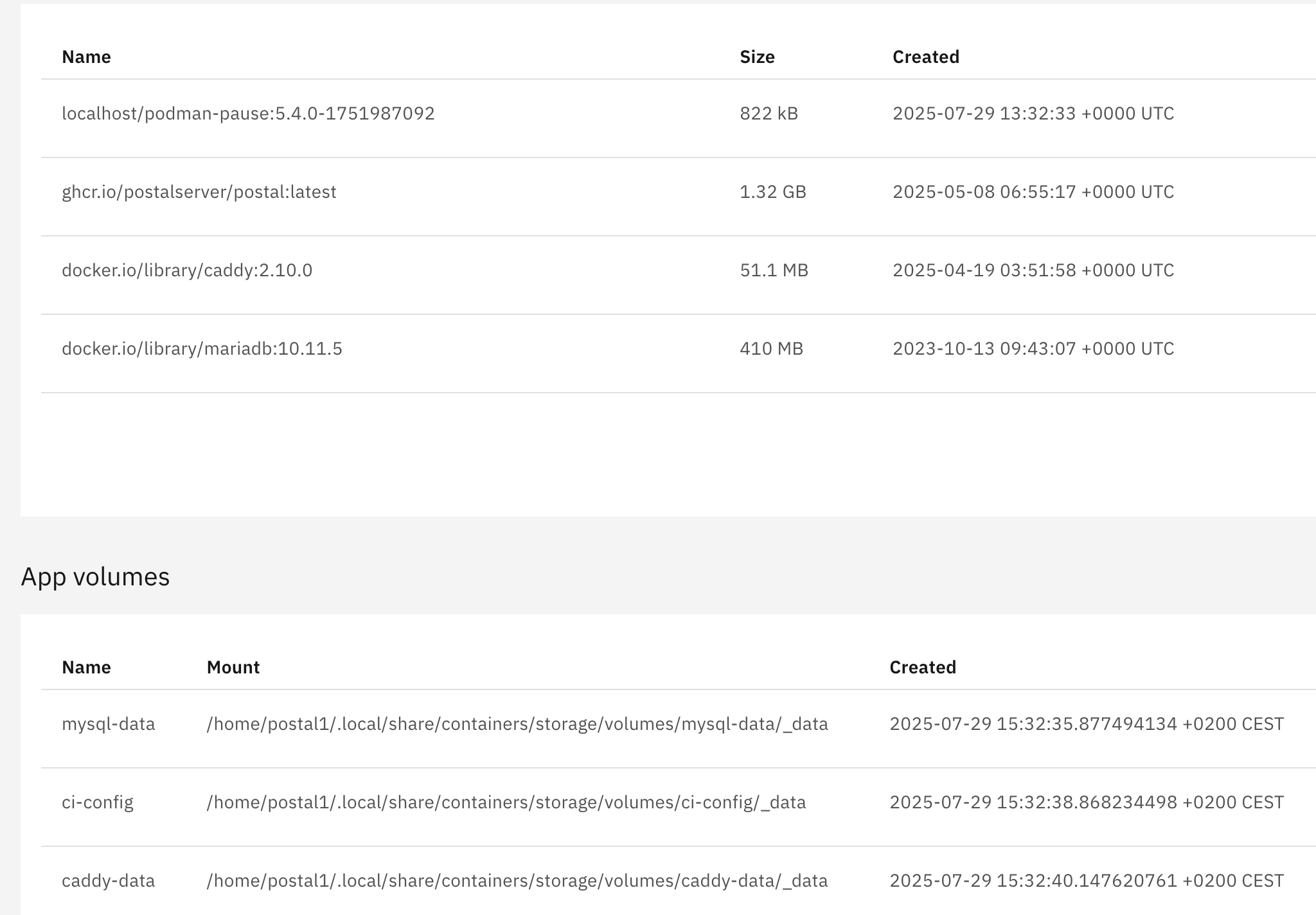

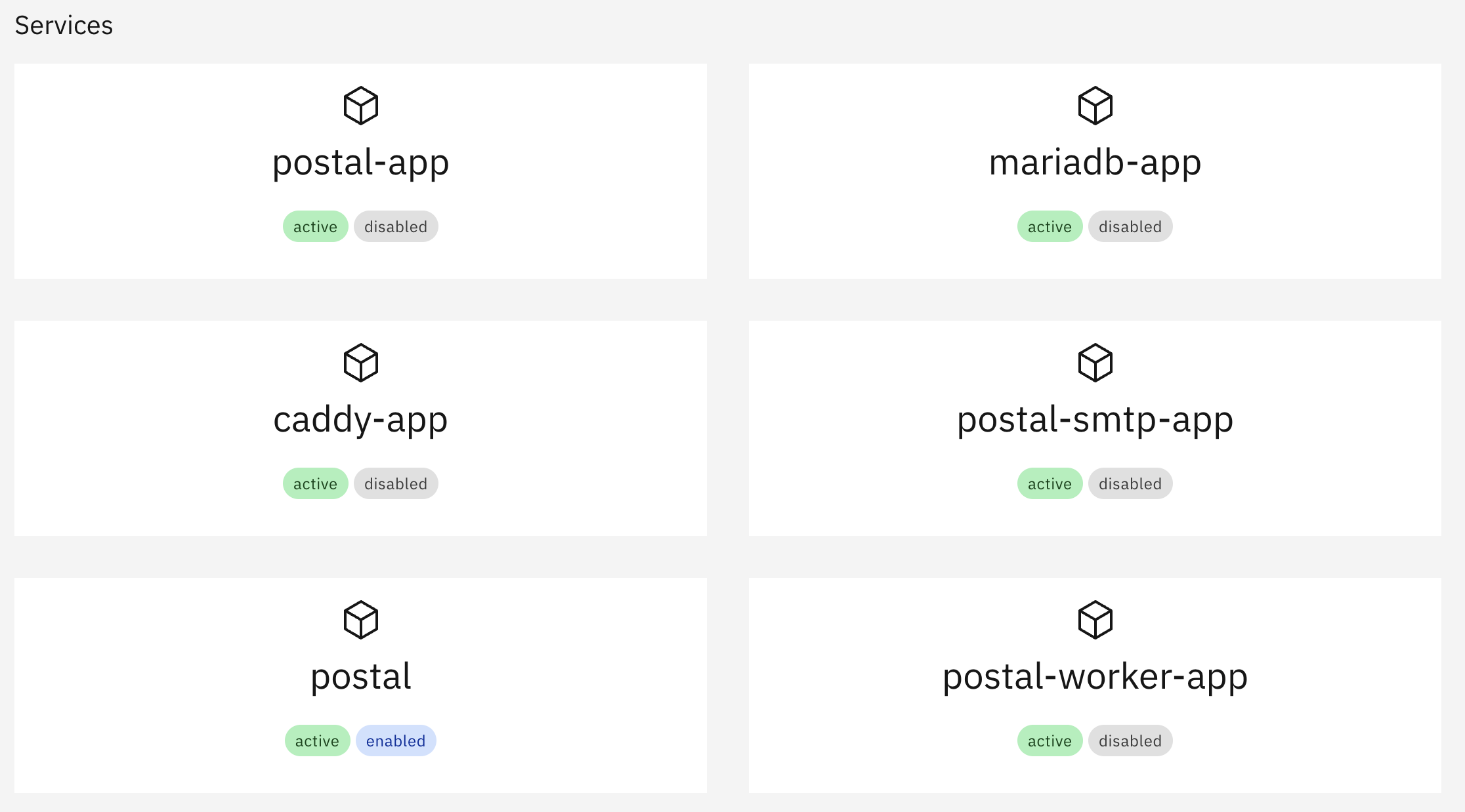

Bad gateway.
please see 2025-07-29T15:33:12+02:00 [1:postal1:postal-worker-app] 2025-07-29 13:33:12 +000 - Pastebin.com
I uninstalled due to overflooding the logs with errors
After configuring module, you are supposed to wait for services to start, then intitialise postal, it sin the docs
you were to click initialise postal
The errors dissapear once postal has been initialised
