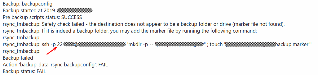

I configured a backup with rsync on sftp. The first time the file backup.marker file is created, this error is also generated.
Same thing for subsequent bakups. I have seen that the declared port is the 22 actually it would be 1212.
thanks

I’ve reproduced the bug of rsync over sftp on non standard port.
this backup is “data” backup called backupconfig.
I created the backup in the well and set the port to SFTP Port to 1212. At the first run the system correctly writes the backup.marker file but fails and returns the error I indicated above.

The issue has been fixed.
I confirm that the issue has been solved.
thanks
