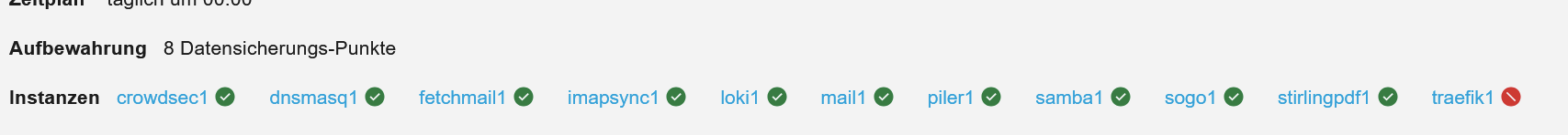

After the last update i got an error when the backup running.
Any Ideas?
