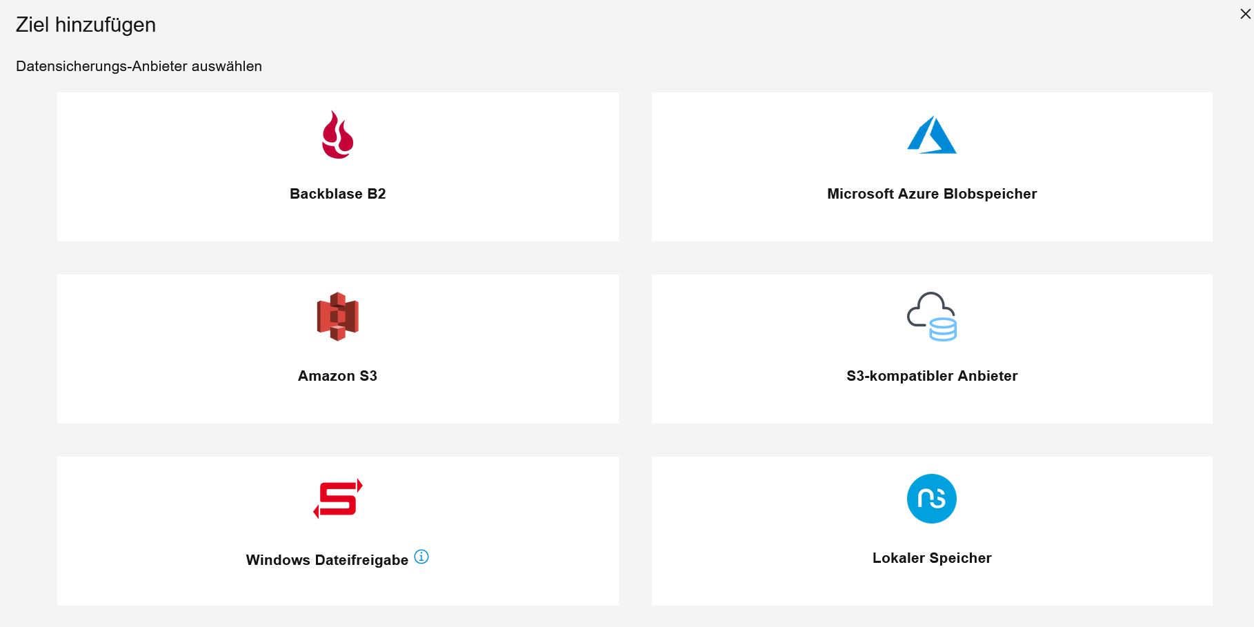

Hallo again, i think about to backup the ns8 system to a cloud, especial pCloud is one System what get my attention. First i thought i could backup the NS8 to a Servershare on the NS8 and then the Backup will at night to a NAS system, but this was not working. So i try to find a alternative way. Is this possible? Because the NS8 shows this:
as possibility.

hucky:
pCloud
I’m afraid pCloud doesn’t provide a supported connection like S3 or B2.

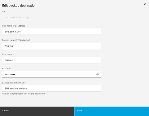

No, it’s working here.
Here are my backup destination settings:
pCloud uses it’s own clients so there’s no supported protocol but there are a lot of S3 providers. I use Contabo S3 for example.
I think it’s possible to do a local backup and sync it to pcloud but I recommend to use a supported provider.

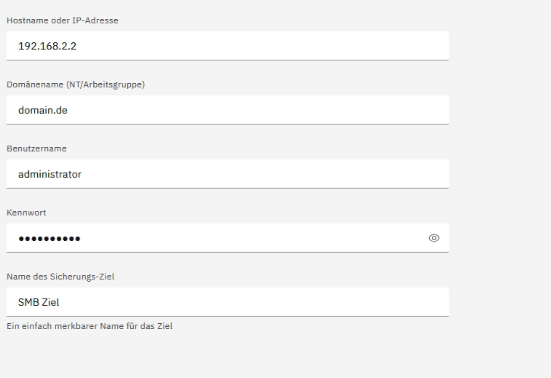

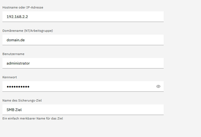

hucky
(kai)
May 1, 2025, 6:43am
6

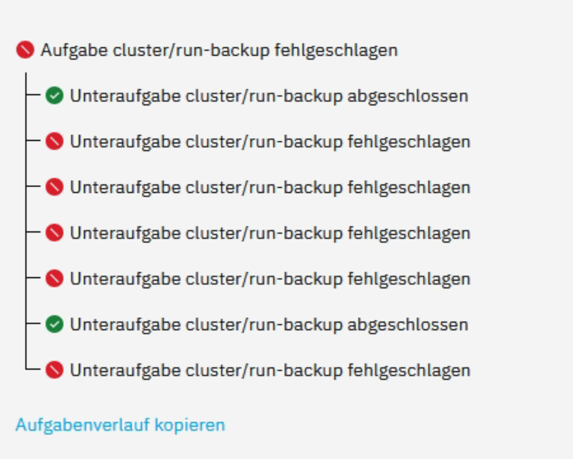

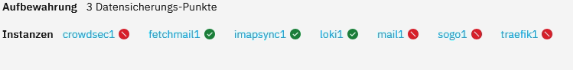

same konfig here
but i got an error
Log:
“run-backup” status is “aborted” (1) at step 50run_backup
2025-05-01T08:43:39+02:00 [1:loki1:agent@loki1] task/module/loki1/4a30f184-b508-4caf-b0ff-b850c1570f3d: get-configuration/10get is starting
2025-05-01T08:43:39+02:00 [1:loki1:agent@loki1] task/module/loki1/4a30f184-b508-4caf-b0ff-b850c1570f3d: action “get-configuration” status is “completed” (0) at step validate-output.json
2025-05-01T08:43:54+02:00 [1:loki1:loki-server] ts=2025-05-01T06:43:54.322394707Z caller=spanlogger.go:111 middleware=QueryShard.astMapperware org_id=fake traceID=527efef40b649173 user=fake caller=log.go:168 level=warn msg=“failed mapping AST” err=“context canceled” query=“{module_id="loki1"} | json syslog_id="SYSLOG_IDENTIFIER", message="MESSAGE" | line_format "[{{.node_id}}:{{.module_id}}:{{.syslog_id}}] {{.message}}"”

mrmarkuz
(Markus Neuberger)
May 1, 2025, 7:38am
7
Please check the containers of the app instances that failed, for example loki1, maybe it’s a similar issue like here ?
runagent -m loki1 podman ps -a
Two app backups seem to work, please try to just backup these 2 apps instead of all and check if the backup runs through.

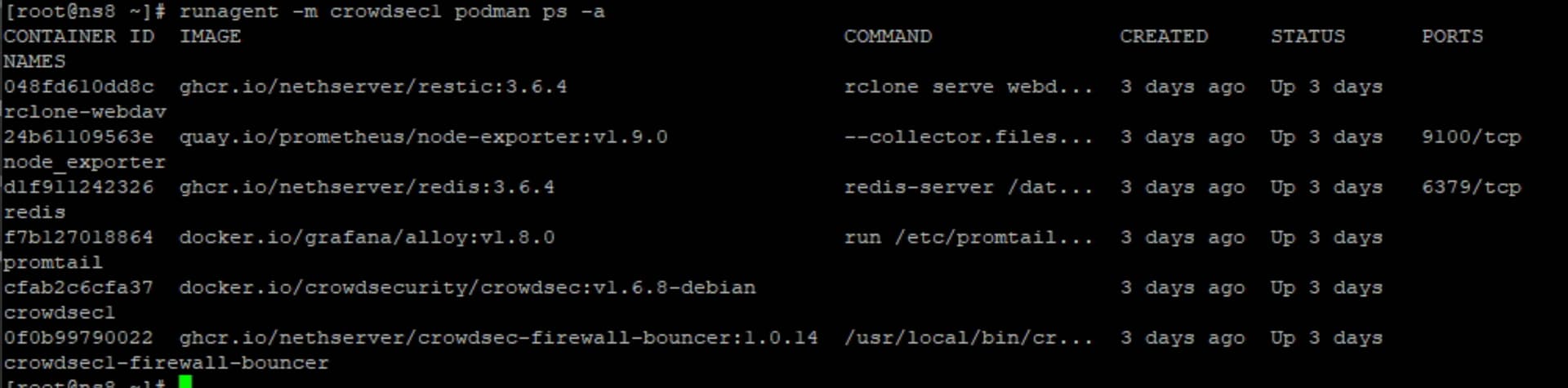

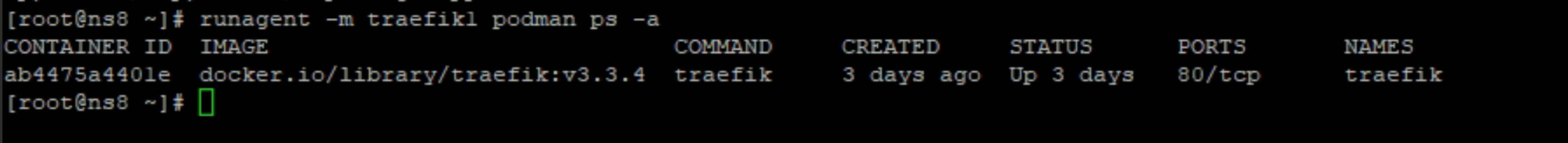

hucky
(kai)
May 4, 2025, 9:46am

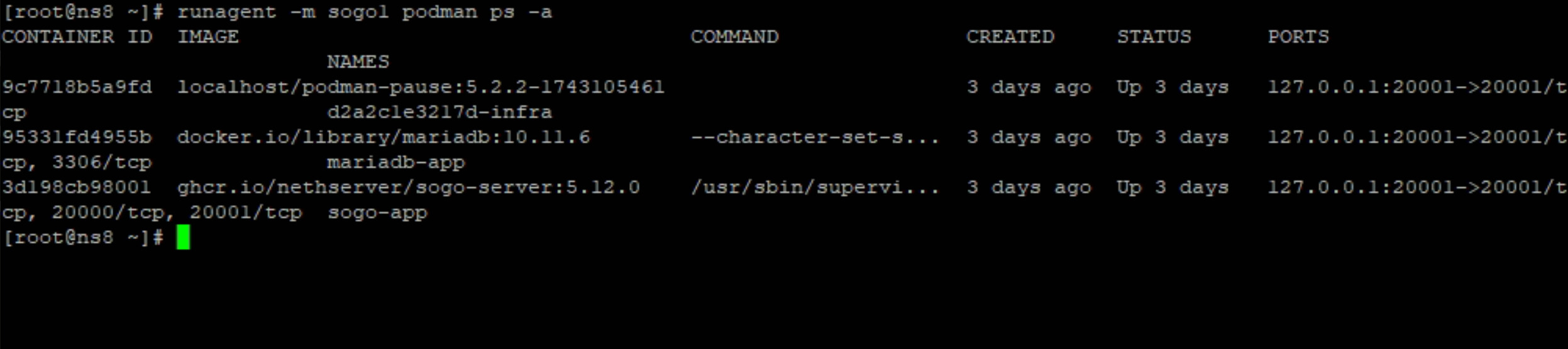

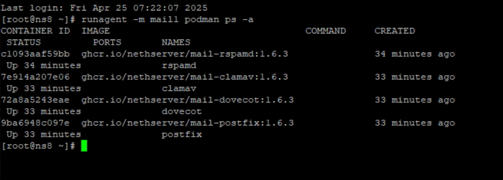

8
i tried now to choose different backup from the apps but also if its always an error with the same apps.
i tried the runagent with the mail app, but i am not able to decide it is okay or not, this are the result of the mail1
i can do the runagent command also with the other apps what are not backupped if it is helpful.

mrmarkuz
(Markus Neuberger)
May 4, 2025, 10:18am
9
The containers seem to be ok, there’s no hanging container.
