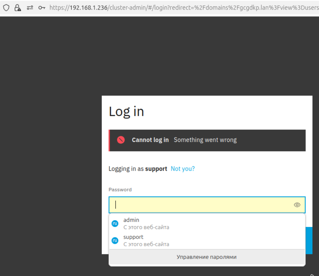

Description of the Problem:
We are experiencing an authentication issue with the NS8 admin interface after migrating from NS7.
Environment Details:
Hypervisor: ProxMox
NS8 Installation: Deployed from the system snapshot available at https://tinyurl.com/ns8-rocky-qcow2
Configuration: Static IP address assigned. An additional user with admin cluster privileges (support) was created.
Steps Taken:
Successfully set up NS8 with static IP.
Verified that login to the UI at https://<host IP>/cluster-admin was functional initially.
Migrated data from NS7 SambaDC (including Folders and Mail) to NS8.
Installed the Roundcube client after migration.
The cluster operated without significant issues until the end of the day.
Issue:
On the following day, attempts to log in to https://<host IP>/cluster-admin using both the admin and support accounts fail. Authentication is no longer working, preventing access to the admin interface.
Change cluster admin password not working
[root@sv-0-236 ~]# api-cli run alter-user --data '{"user":"admin","set":{"password":"Nethesis,1234","2fa":false}}'
AuthenticationError: invalid username-password pair or user is disabled.

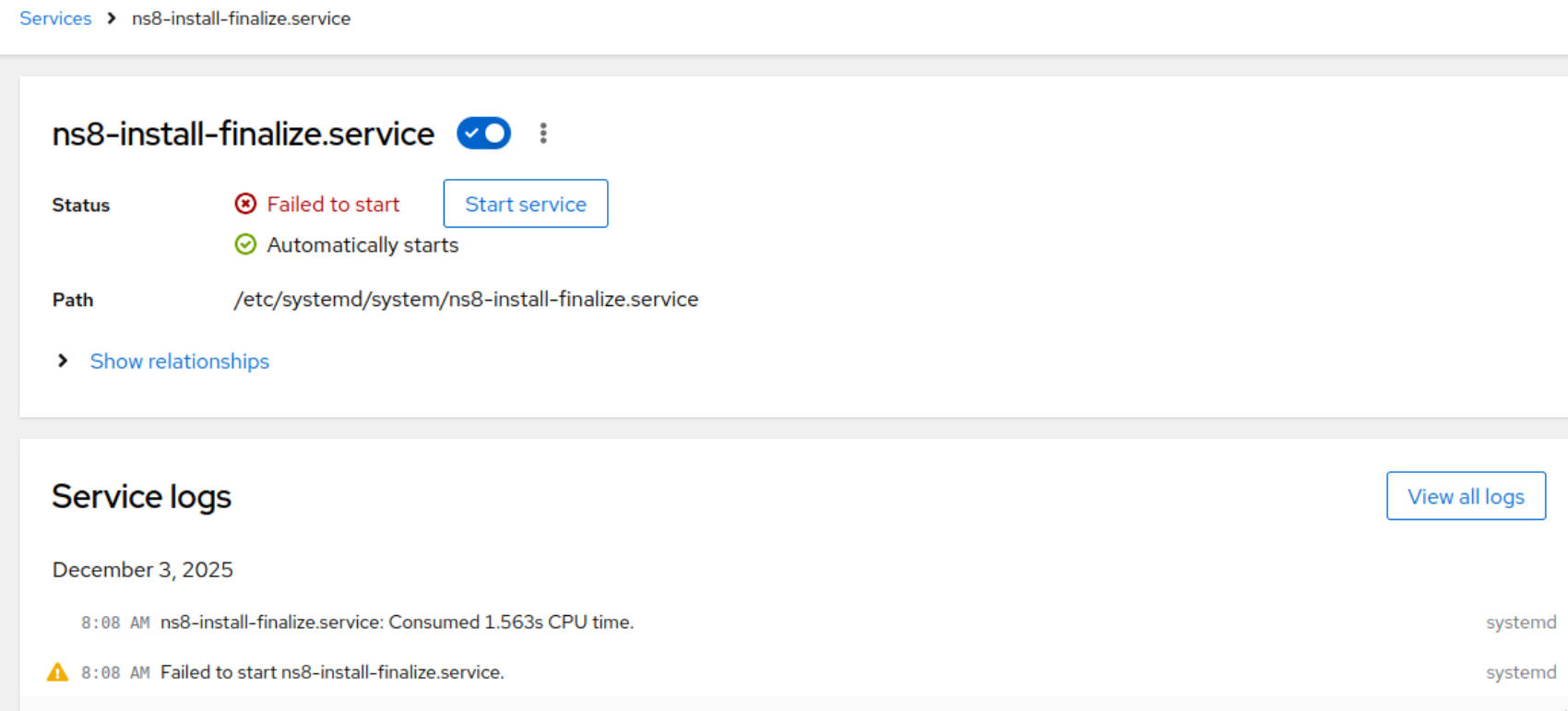

I also see an error when starting the service…
Failed to start ns8-install-finalize.service.
redis.exceptions.AuthenticationError: invalid username-password pair or user is disabled.
Please advise what other information we can provide to resolve the issue?

This service should be removed automatically at the first image boot. I suppose something went wrong in that phase.
I suggest to not use the prebuilt image. Instead install with the standard procedure over a clean Rocky Linux or Debian system. Installation — NS8 documentation

6
As something went wrong I think it’s the safest way to do a full reinstall including the OS which would delete the data.
To reset the NS7 to the state before migration, see GitHub - NethServer/nethserver-ns8-migration
That could be the issue.
The pre-built image already has NS8 preinstalled so there’s no need to run the standard installation procedure .

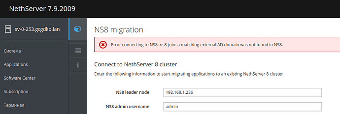

I have a problem
How to re-migrate.
mrmarkuz
(Markus Neuberger)
December 3, 2025, 4:23pm
11
If the NS7 used an external account provider, it must be created on the NS8 first, see NethServer 7 migration — NS8 documentation
Or maybe you need to go back before migration on the NS7:
