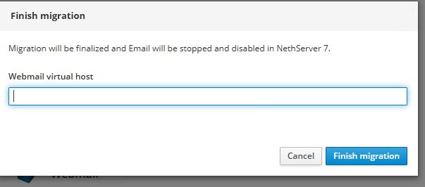

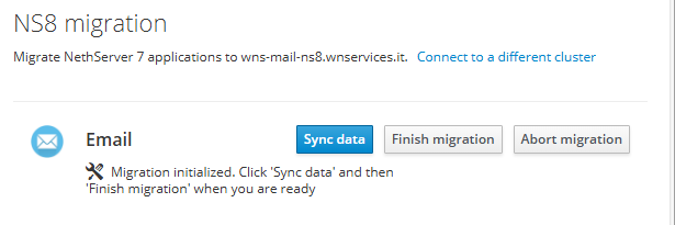

i’m in this situation
immagine
i did sync and then finish and i got this pop up
immagine
I went to Applications, searched for Webmail, then clicked Open, and it directed me to the link https://mail.mydomaincompany.it/webmail/. Is this what I need to enter in the pop-up?
Thanks
No, in NS8 virtual hosts are needed so you should enter something like webmail.mydomaincompany.it and ensure that the domain resolves to your servers IP in DNS.
