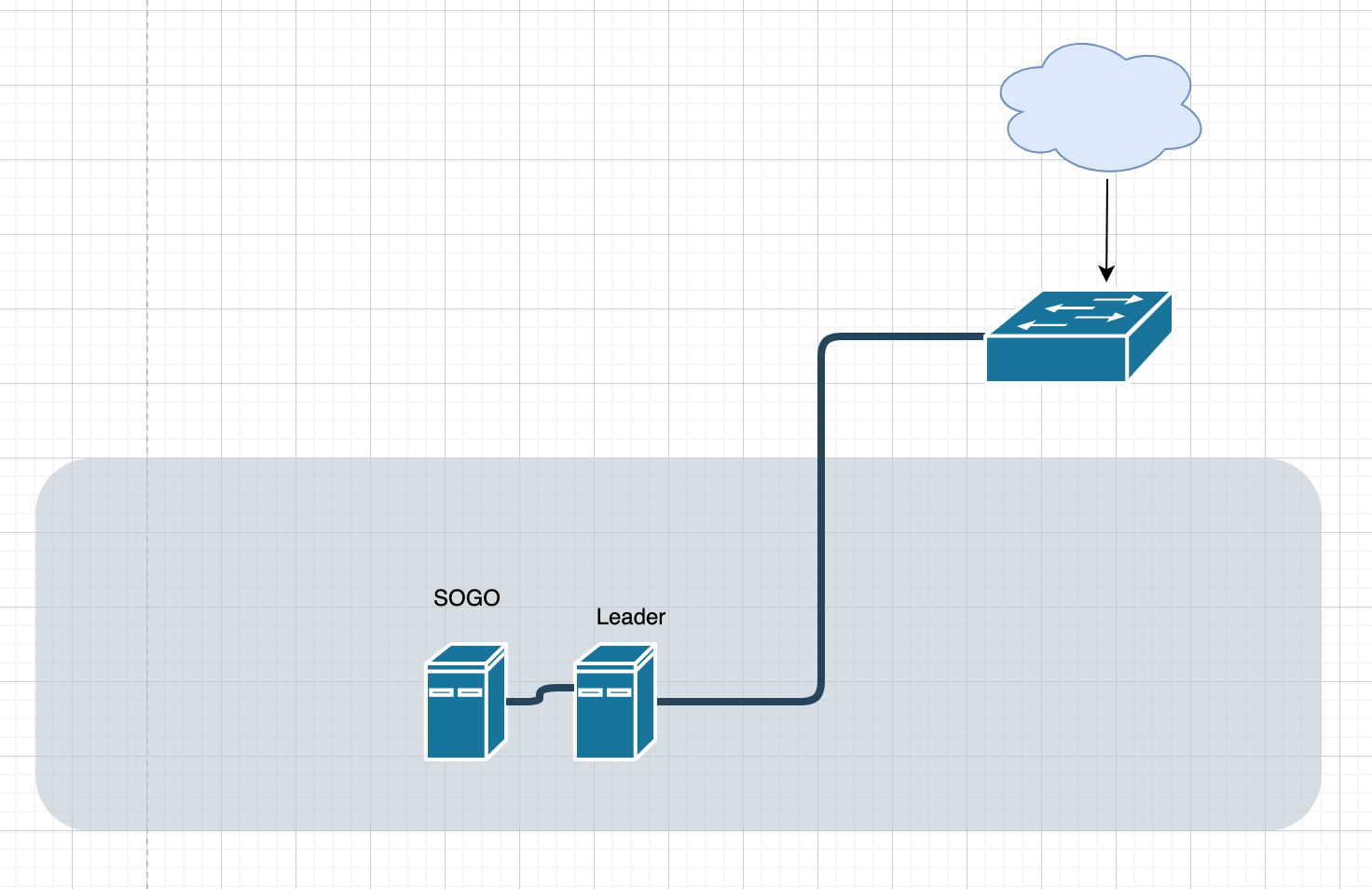

As far as I understood, if I have multiple nodes, and I want to run a application on a second node, it should be accessible from the outside passing through nginx on the leader and using the VPN to access the resources of the application on node2. Am I wrong?
I’m only getting a 404 page not found.

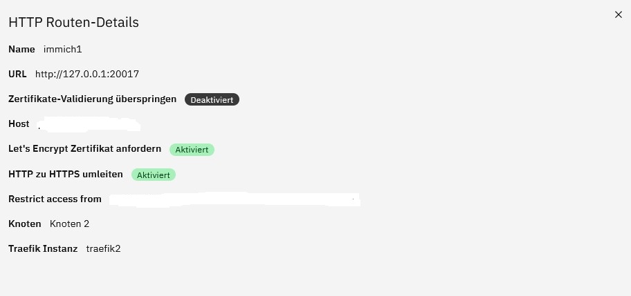

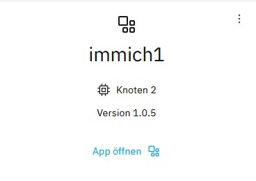

Here is my configuration using Immich from @mrmarkuz as an example.
It works without problems.

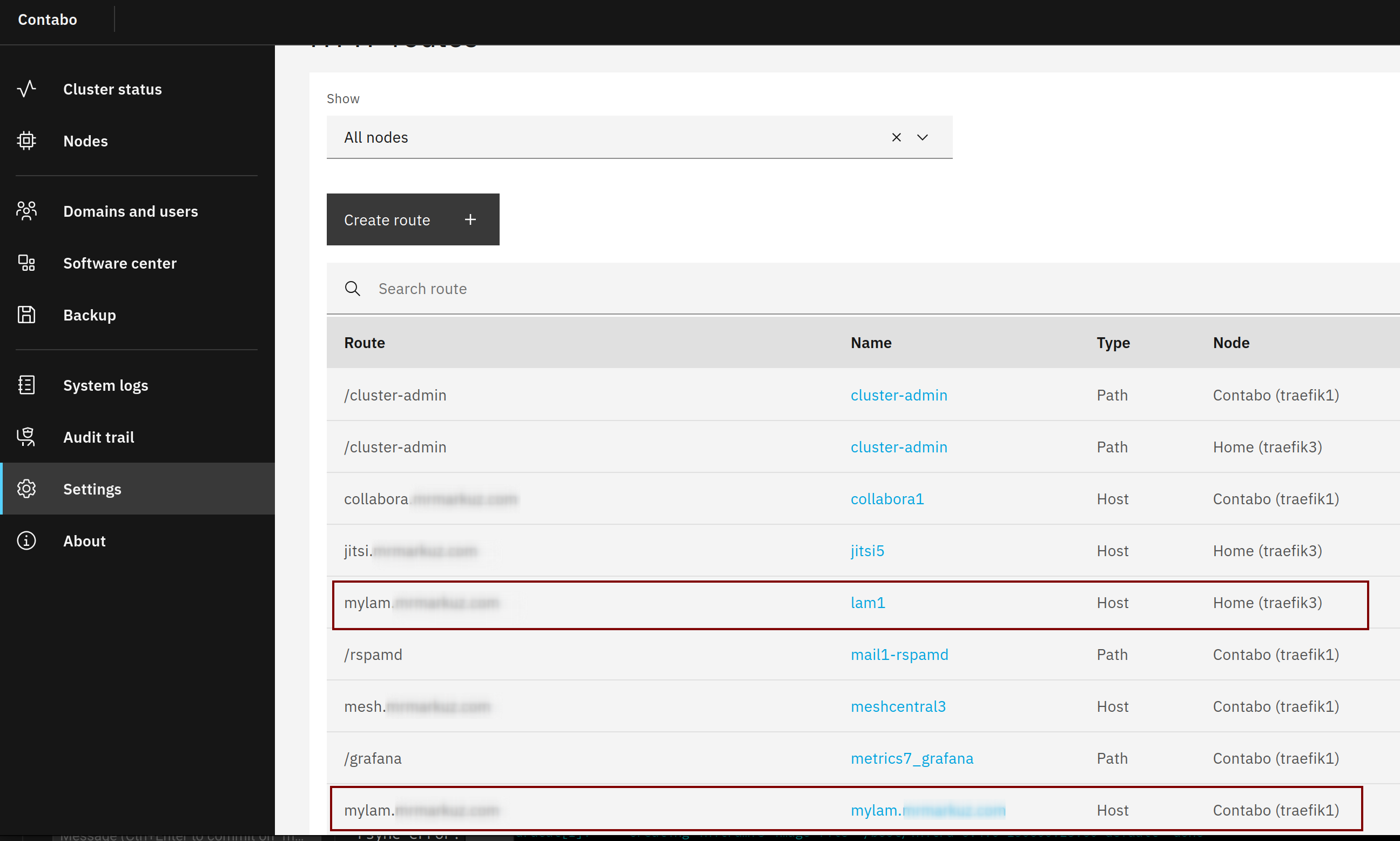

You could setup a traefik http route on the leader, pointing to the worker node:

Here is an example where node 1 is the leader and node 3 is the worker:
Usually you don’t need to delete anything.
The route is added to the leader node 1. On the worker node 3 a route already exists pointing to localhost.
You can use any name, the “Route” or FQDN needs to be set correctly.
