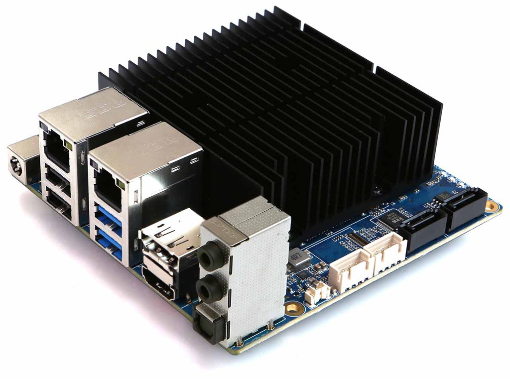

PS:
Both Proxmox PVE and PBS can run well on one of these:
Think 64 GB RAM, 1 120 or 250 GB NVME for system, and 2x 1 or 2 TB SSDs in ZFS mirror for VMs…
For PBS that would be 2x 4, 6 or 8 TB rotating disks, eg Seagate Iron Wolf or even Exos!
Saves power, heat, price and space! :slight_smile:
