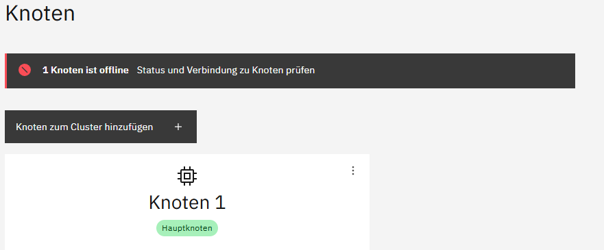

I‘m about to set up a 2nd node to my cluster hosted somewhere else. I iunstalled Rocky Linux 9, then Nethserver with the Standard procedure. Trying join the cluster seems to work but on the leader Nodes Cluster management it says Node is offline.
at the hosters Server the node is running, I can connect via ssh.
There is no way to remove the offline.
What can I do now?

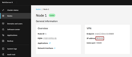

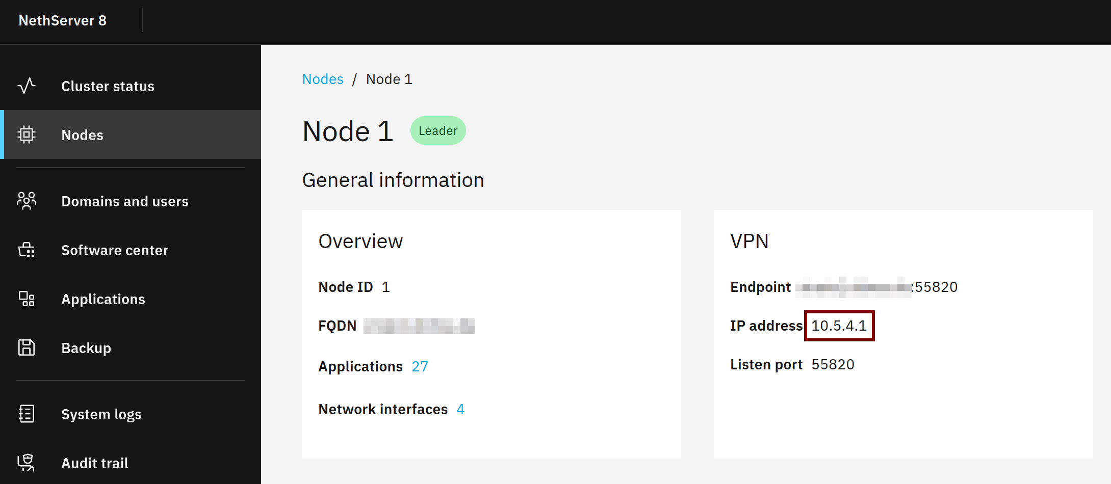

Are the other sides VPN IPs pingable from the nodes? You can find out the VPN IPs on the nodes page.
there is only the leader node
no, I could not ping the leader node from the worker node via the vpn adress.
there is a vpn network adaper on each node, both with a ip in the same subnet
leader: 10.5.4.1/32
worker 10.5.4.3/32
trying to ping the worker (after I found its ip in the shell):
