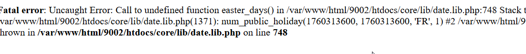

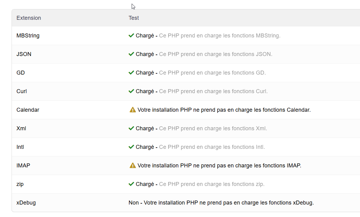

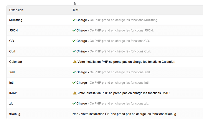

I checked phpinfo and found no trace of these modules. The error comes from Dolibarr and is as follows:
The function in error belongs to the calendar module, and a check of the php configuration in Dolibarr done:

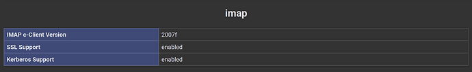

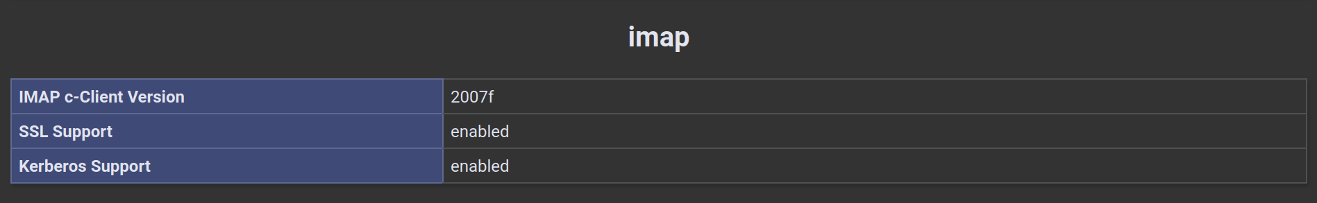

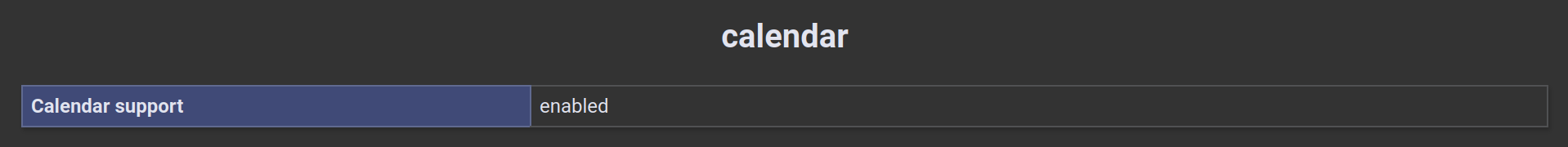

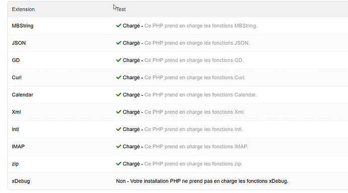

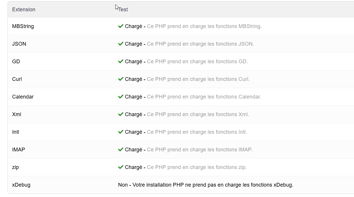

After testing,I confirm that both modules are activated in NS8-Lamp, thank you.
It seems the modules are installed but not enabled, following exists in lamp but is missing in webserver phpinfo:

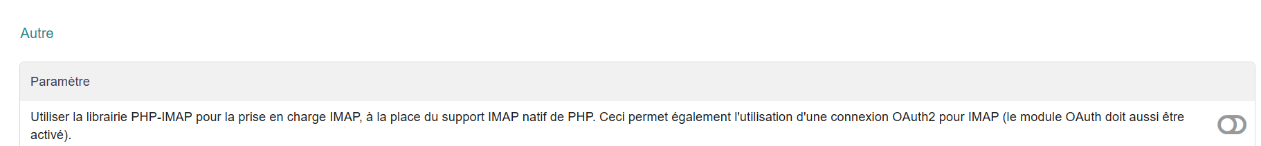

I don’t use the IMAP feature on Dolibarr. After checking, email retrieval works without the IMAP module except for OAuth2. See below (I think you speak French).
