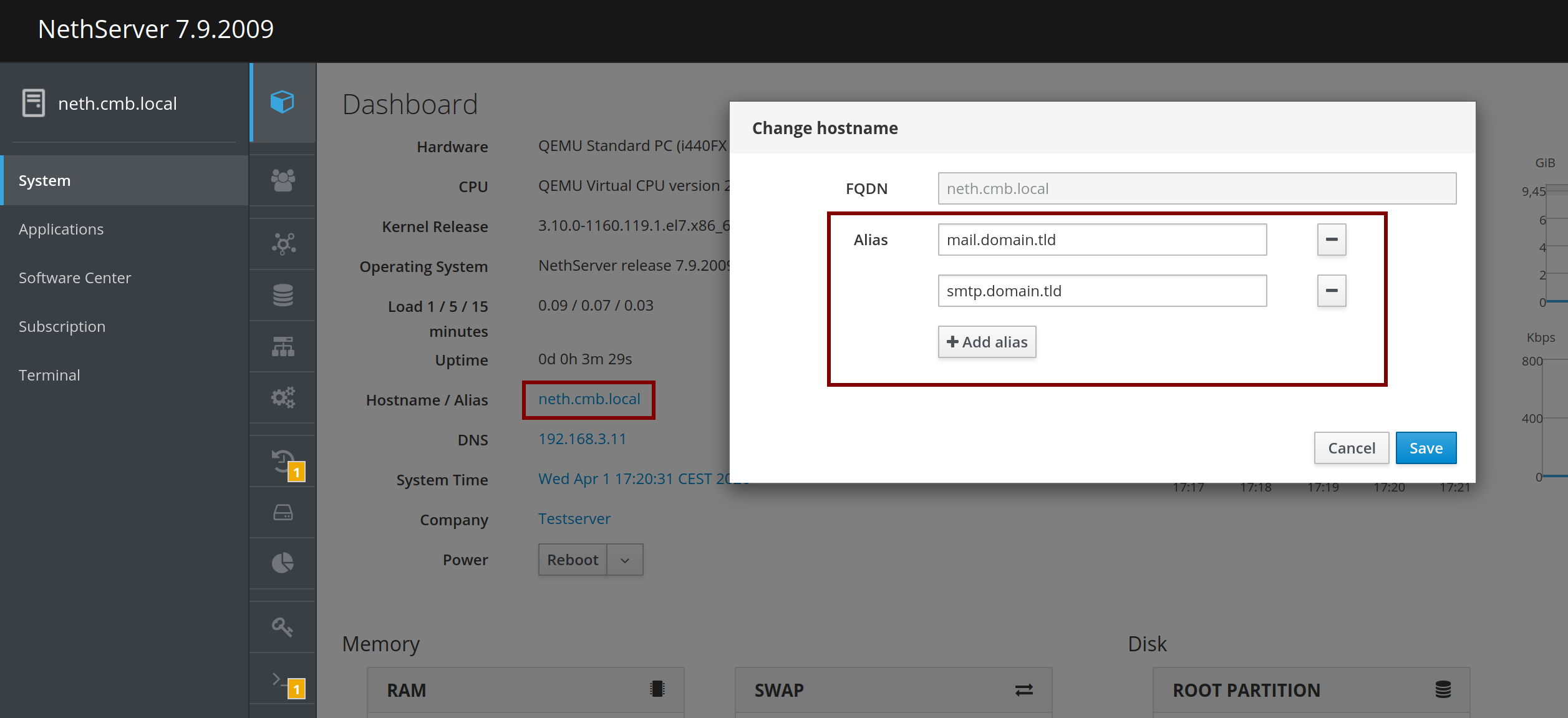

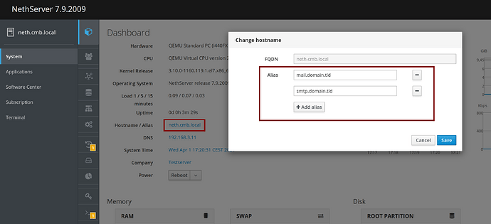

Maybe there are aliases?

The are not added as aliases, I have only the hostname listed there. What I don’t understand is why the DNS wasn’t migrated together with the accounts.
