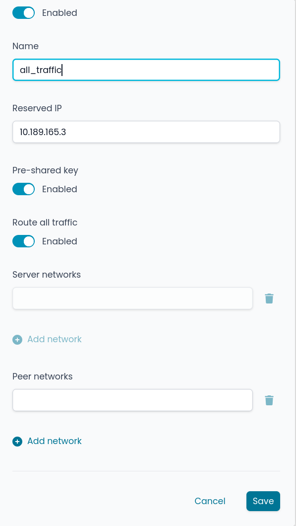

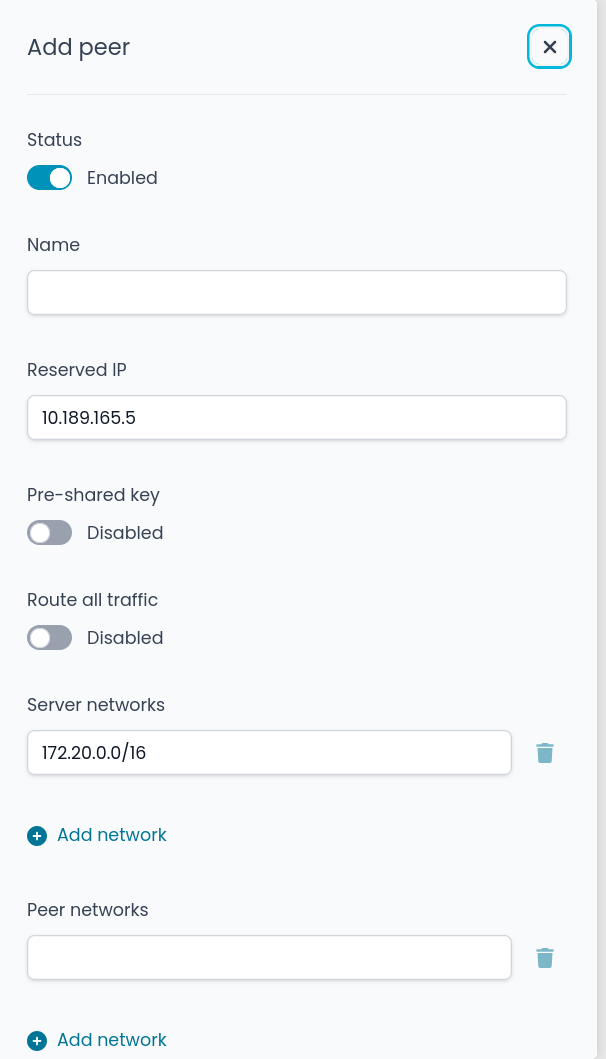

When adding a peer, the ‘Pre-shared key’ option should be enabled by default to ensure post-quantum security (this should be already a standard).
Additionally, ‘Route all traffic’ should be enabled by default, as this is the standard behavior in similar applications and OpenWRT. If users only need to access specific subnets via the VPN, they should switch this option off and define them manually. Restricting the VPN only to the server network is more common in peer tunnel environment.

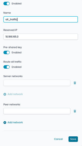

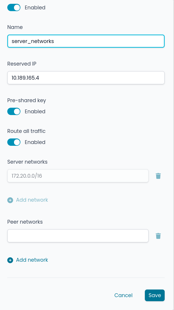

If you add a peer and enable ‘Route all traffic’ later, it results in a different configuration than if you had enabled it in the first step. This behavior is inconsistent, as the system should end up in the same state regardless of when the option is selected.
all_traffic: created without editing afterwards
server_networks: edited afterwards enabling Route all traffic
config wireguard_wg1 'wg1_ns_e31817d9_peer'
        option disabled '0'
        option ns_name 'all_traffic'
        option preshared_key 'xxx'
        option ns_route_all_traffic '1'
        list allowed_ips ''
        list allowed_ips '10.189.165.3/32'
        option ns_ip '10.189.165.3'
        option public_key 'xxx'
        option private_key 'xxx'
        option persistent_keepalive '25'
        option route_allowed_ips '1'
        option ns_link 'network/wg1'
config wireguard_wg1 'wg1_ns_c7911c95_peer'
        option disabled '0'
        option ns_name 'server_networks'
        list ns_local_routes '172.20.0.0/16'
        option ns_ip '10.189.165.4'
        list allowed_ips '10.189.165.4/32'

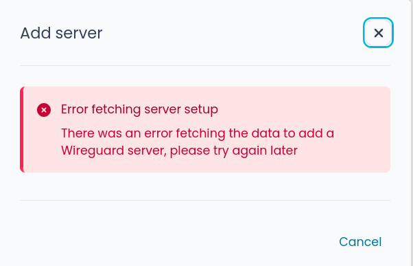

In the latest version of NethSecurity, I’m unable to add a second server tunnel. I’ll need to test this on a clean installation to confirm.

Do you have ThreatShield DNS enabled? The last error might because the firewall cannot solve it’s external IP through opendns. You can check by executing dig +short +time=1 myip.opendns.com @resolver1.opendns.com, in case it fails you should add a whitelist for these domains: Wireguard public IP check: Fail silently if IP cannot be resolved · Issue #1443 · NethServer/nethsecurity · GitHub .
This is cause Wireguard tunnelling was planned as a tunnel to bridge firewalls, not for clients. This is because most of our userbase expects when adding a end-user tunnel to have password and OTP authentication which the protocol doesn’t support at all, so the option is disabled by default to avoid sending all traffic through one firewall to the other. If this kind of usage keeps being requested we might add an additional UI to handle user tunnelling something on the ropes of OpenVPN RoadWarrior
Looking into it, from what you’ve posted I might have forgot a delete somewhere
Thanks, this solved the problem.

I still believe the pre-shared key (PSK) should be a default setting
