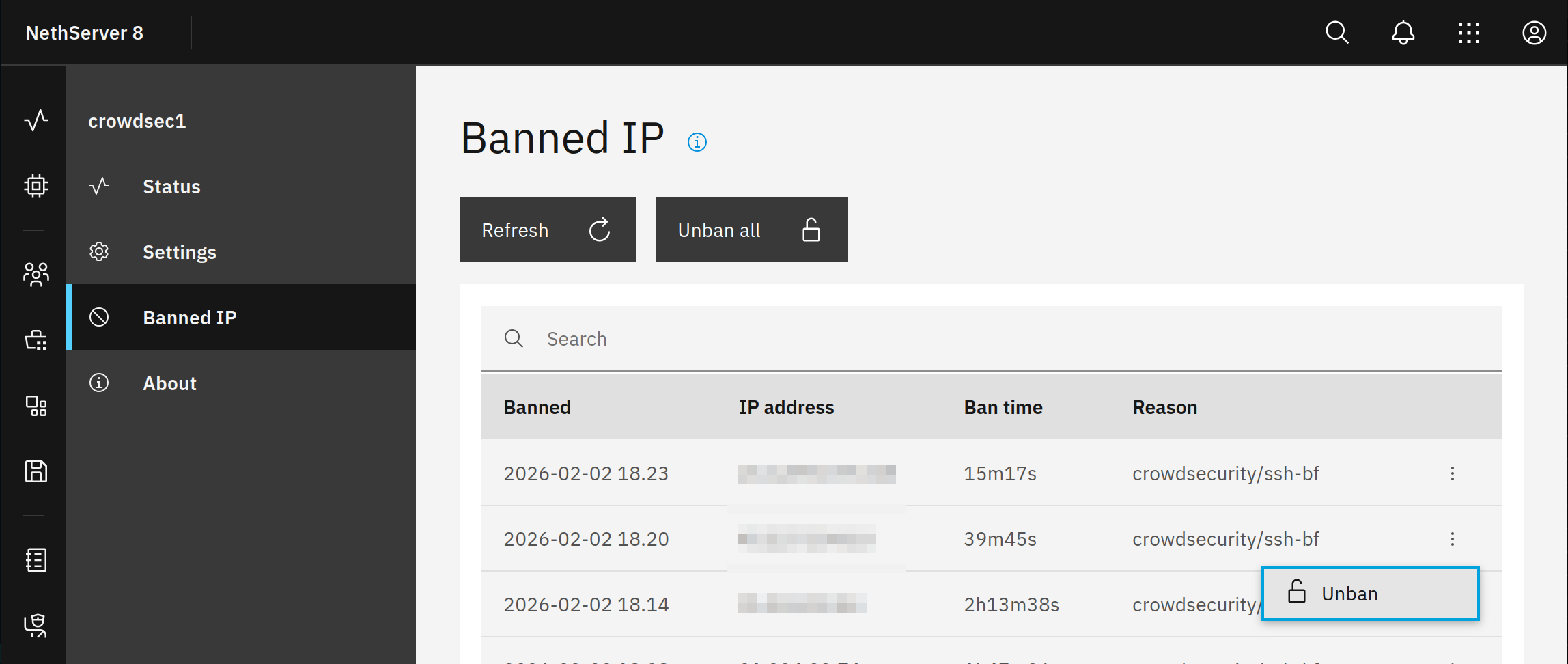

Finally, the Crowdsec settings also need to be tested, but I haven’t figured out how to manually unblock it, similar to fail2ban, if a false ban occurs…

You can unban the IPs at the “Banned IP” page:
