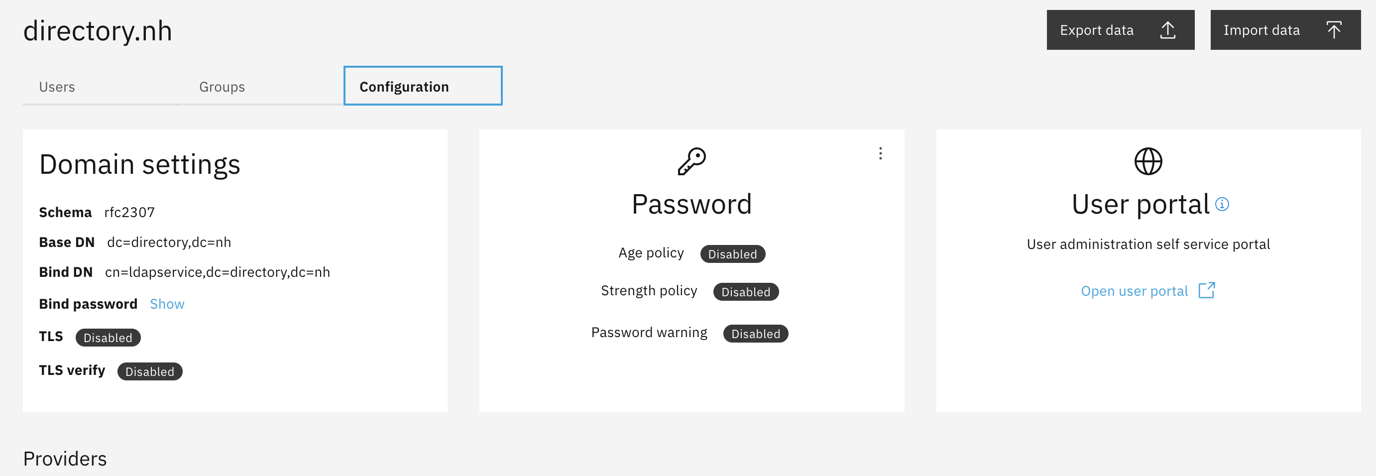

Looks like it. The user portal/admin page is linked from inside the cluster-admin pages, though. Go to Domains and users → Show Details (for the relevant domain) → Configuration. And then under User portal, click the Open user portal link:
Might be different if you’re using AD for your accounts provider rather than OpenLDAP.
