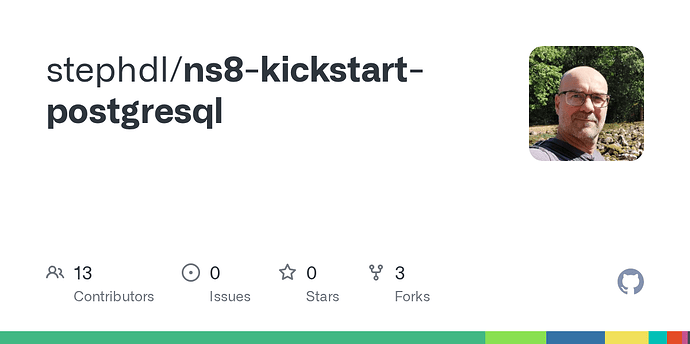

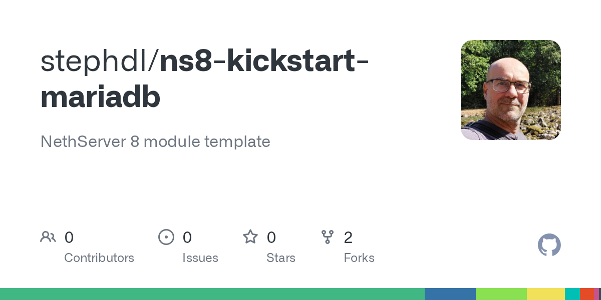

Kickstart? You should have started from mine :slight_smile:
I put some “CLAUDE.md” files in there to help AI agents. AI agent-driven development is still quite new, though, and I agree that agents need to be guided, especially because I’m concerned about people using them to produce code without any framework, guidelines, or direction.
The skills has not been my idea first but from @Tbaile IRC but I recall my claude the first time I did /nethserver-ns8-module I feel like it got drug and went direct to the goal :slight_smile:
