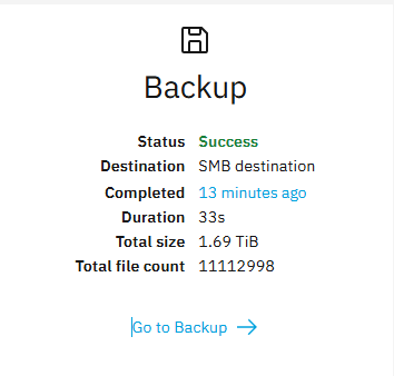

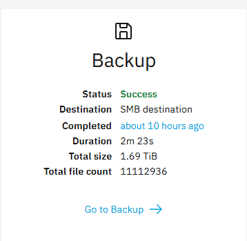

Before:
After:
Based on the time taken and only a very small increase in the number of files, I’d like to say it’s working.
Let me see if I can take a look at the backed up data to confirm.
Cheers.

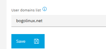

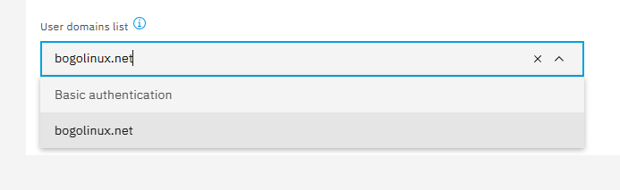

Not quite sure what you’re asking. I have this setting:
Only users declared to NS8 can login to the BackupPC interface. And all users have full control.
I see this in BackupPC:
But I can’t use backuppc as the user to login with as I don’t have a password for it.

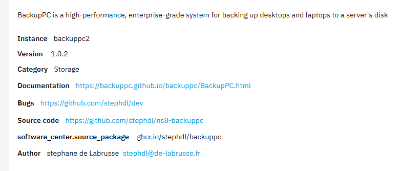

Use the stable version. Not the testing version
Version 1.0.2
I don’t know how to switch back.
But previous to installing your new version, it was the same as I described above. I could only log in via the UI with an NS8 defined user and they had full control.
Cheers.

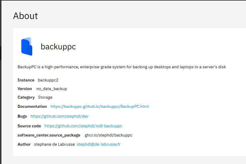

Go to about page in the module and display the version you use ![]()
In the upgrade you should have 1.0.2 offered if not
api-cli run update-module --data ‘{“module_url”:“ghcr.io/stephdl/backuppc:1.0.2",“instances”:[“backuppc1”],"force”:true}’
It includes the ldap and the no data backup fix
Nope, no update offered.

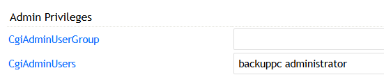

Normally by upgrading to 1.0.2 you should see also the administrator in the field of the cgi admin ?
You mean as an option here:
Then no.
If not, exactly where. To logon to the UI is a simple user/password prompt.
Cheers.
Normally administrator is also listed
OK, yes it appears to have done that now:
