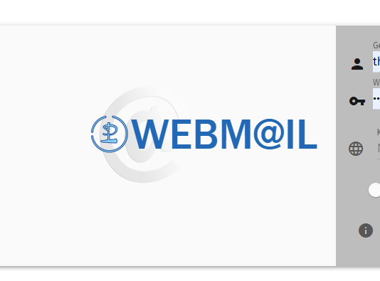

Is that also possible for the customized logo “sogo-full.svg”
I’ve it now copied in the container.
If you just copy it into the container it’s not persistent.
You could add another volume line for it like: (untested)

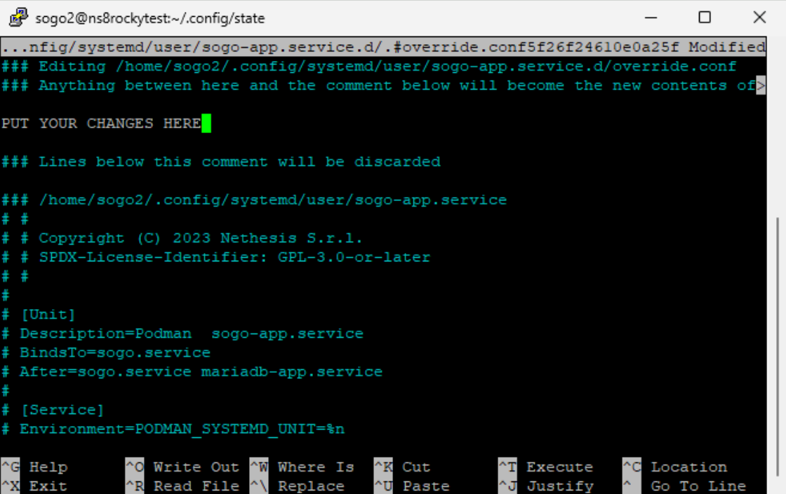

I m ust doing something wrong
runagent -m sogo1
runagent: [INFO] working directory: /home/sogo1/.config/state
sogo1@ns8:~/.config/state$ systemctl --user edit sogo-app
Editing "/home/sogo1/.config/systemd/user/sogo-app.service.d/override.conf" canceled: temporary file is empty.
i can not edit the file in putty
I think you just uncommented the needed lines but you need to add your changes between
### Editing /home/sogo2/.config/systemd/user/sogo-app.service.d/override.conf
### Anything between here and the comment below will become the new contents of the file
and
### Lines below this comment will be discarded
and then save the open file in the editor.
If there are no changes between those lines, it’s seen as empty file.
See also systemctl edit failed (canceled: temporary file is empty) · Issue #24208 · systemd/systemd · GitHub
If you like another editor, for example vi:
EDITOR=vi systemctl --user edit sogo-app

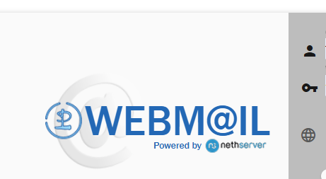

For those who like it. Here are the files i’m using (without my logo)
If some one like a different logo, i can adjust it for you.
Thanks for sharing. Powered by NethServer ![]()
