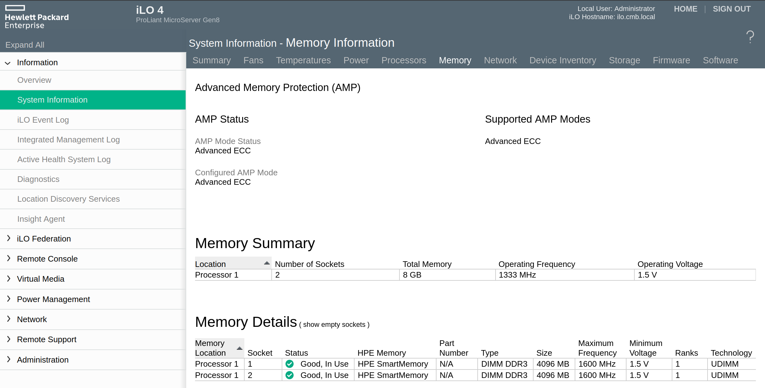

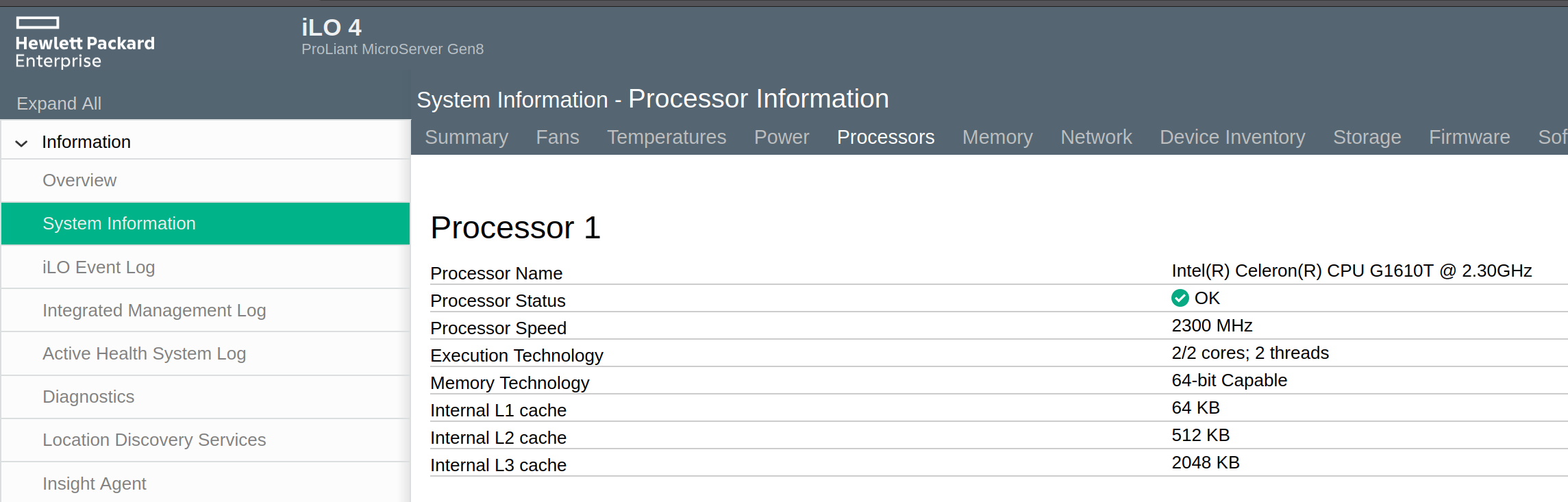

I found another G8 Microserver which I think is comparable, so I tested to install Proxmox 9 and NS8 and I think it’s workable for your needs @DarkCorner
HP ProLiant MicroServer System G8 BIOS J6 04/04/2019
CPU: Intel(R) Celeron(R) CPU G1610T @ 2.30GHz
Disk: Samsung SSD 870 QVO
RAM: 8 GB
Installation notes:
  • Prepare Proxmox USB boot stick with etcher or dd
  • Install Proxmox 9
  • Add no-subscription repo and update Proxmox 9
  • Install NS8 on Proxmox and set the VM to 2 cores and 4 GB RAM
    PRXVMNAME=NS8Test
    PRXVMID=100
    PRXSTORAGE=local-lvm
    PRXRAM=4096
    PRXCORES=2
    wget https://tinyurl.com/ns8-rocky-qcow2
    qm create ${PRXVMID} --name "${PRXVMNAME}" --cpu host --scsihw virtio-scsi-pci --ostype l26 --cores ${PRXCORES} --memory ${PRXRAM} --net0 virtio,bridge=vmbr0 --agent 1
    qm importdisk $PRXVMID ns8-rocky-qcow2 ${PRXSTORAGE}
    qm set ${PRXVMID} --scsi0 "${PRXSTORAGE}:vm-${PRXVMID}-disk-0"
    qm set ${PRXVMID} --boot order=scsi0
  • Setup (wildcard) DNS record for the NS8 domain name
  • Setup user to access via SSH: useradd -G wheel markus; passwd markus
  • Create single node cluster
  • Enable NethForge repo for webserver
Install and configure following apps:
  • Samba User Domain and create users/groups and a share
  • Mail
  • Ejabberd
  • Mattermost and create a user
  • Webserver and create a virtualhost and upload phpinfo.php for testing
  • Webtop
  • Dokuwiki
  • Lamp
  • Wordpress
Video of booting and a working NS8:
