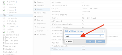

I ask you a question : If I force the snapshot locally on the ZFS storage mdi proxmox second is better or not ?
To be honest, I can’t give an answer…
I simply never trusted snapshots enough and have always preferred a full backup. That has always worked.

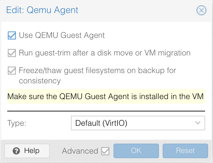

@Andy_Wismer Last question : in Ns8 as in all servers , I installed the qemu-guest-agent and activated it in the VM profile .
I have the option to disable it and uninstall the package . What do you think?
I’ve always had better experience when using the qemu-guest-agent in all available OSes than without.
But you still can try. Usually you can set some options in the QEMU agent for each specific VM.
