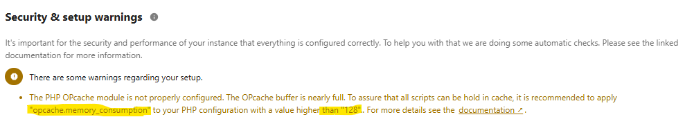

@mrmarkuz thank you for everything, right now I would like to solve another issue within regards on this OPACHE , trying to figure-out the location but /php folder on this can’t find.
I don’t get this message on my NS8 Nextclouds.
To adapt the opcache.memory_consumption value in NS8 Nextcloud:
Enter nextcloud1:
runagent -m nextcloud1
Add the following to the file ./config.env for 256 MB:
PHP_OPCACHE_MEMORY_CONSUMPTION=256
Restart Nextcloud app:
systemctl --user restart nextcloud-app
Exit environment:
exit

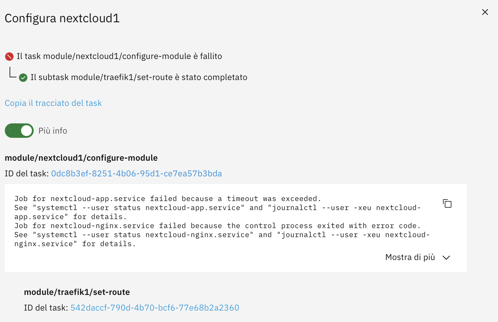

Hi, I have the same problem ‘Bad Gateway’
I use a VPS Contabo 6 Core 12GB RAM 300GB SSD Rocky 9
I removed the app and installed a new instance but
“nextcloud-app.service” and “nextcloud-nginx.service” do not start
Job for nextcloud-app.service failed because a timeout was exceeded.
See "systemctl --user status nextcloud-app.service" and "journalctl --user -xeu nextcloud-app.service" for details.
Job for nextcloud-nginx.service failed because the control process exited with error code.
See "systemctl --user status nextcloud-nginx.service" and "journalctl --user -xeu nextcloud-nginx.service" for details.
Since I still had no data stored, I decided to do a complete reset of the VPS and reinstall Rocky 9.

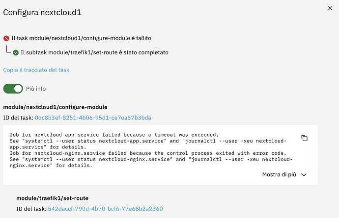

I add the Hostname of the CODE server in Cluster-admin and I get the error
I try to execute from shell but from now on NC always responds “Bad gateway”
runagent -m nextcloud1 systemctl --user try-reload-or-restart nextcloud nextcloud-{redis,db,app,nginx}
I have reset the server several times and minimized the changes to the various services but I always get the same error
I ask if you can kindly help me understand what I’m doing wrong.
Thanks

Hi Giuseppe,
welcome to NethServer community.
So Nextcloud does work until you set the collabora server in the NS8 Nextcloud app settings?
Maybe one of the apps you installed causes the issue? Did you already try without app install?
Please also check the system logs for errors.
Maybe it helps to increase the timeout, see also Continuing NS8 Nextcloud + other problems - #19 by stephdl
Thanks for the advice, unfortunately even increasing the timeout to 120 for
- nextcloud.service
- nextcloud-nginx.service
- nextcloud-app.service
and then running
always responds “Bad Gateway”

2025-05-05T12:33:35+02:00 [1:nextcloud1:nextcloud-db] 2025-05-05 10:33:35 0 [Note] InnoDB: 10.6.21 started; log sequence number 84666969; transaction id 309392
2025-05-05T12:33:35+02:00 [1:nextcloud1:nextcloud-db] 2025-05-05 10:33:35 0 [Warning] You need to use --log-bin to make --expire-logs-days or --binlog-expire-logs-seconds work.
2025-05-05T12:33:35+02:00 [1:nextcloud1:nextcloud-db] 2025-05-05 10:33:35 0 [Note] Server socket created on IP: ‘::’.
2025-05-05T12:33:35+02:00 [1:nextcloud1:systemd] Started libcrun container.
2025-05-05T12:33:36+02:00 [1:nextcloud1:nextcloud-app] Configuring Redis as session handler
2025-05-05T12:33:36+02:00 [1:nextcloud1:podman] 06091d6689b7e1a77dff10c520c14e0d8939e8d64ce1f7b8ef79442ba8bbbd27
2025-05-05T12:33:36+02:00 [1:nextcloud1:nextcloud-app] => Searching for hook scripts (*.sh) to run, located in the folder “/docker-entrypoint-hooks.d/before-starting”
2025-05-05T12:33:36+02:00 [1:nextcloud1:nextcloud-app] ==> Skipped: the “before-starting” folder is empty (or does not exist)
2025-05-05T12:33:36+02:00 [1:nextcloud1:nextcloud-db] 2025-05-05 10:33:36 0 [Note] InnoDB: Buffer pool(s) load completed at 250505 10:33:36
2025-05-05T12:33:37+02:00 [1:nextcloud1:nextcloud-app] 2025-05-05 10:33:37,682 CRIT Supervisor is running as root. Privileges were not dropped because no user is specified in the config file. If you intend to run as root, you can set user=root in the config file to avoid this message.
2025-05-05T12:33:38+02:00 [1:nextcloud1:nextcloud-app] crond: crond (busybox 1.37.0) started, log level 8
2025-05-05T12:33:39+02:00 [1:nextcloud1:nextcloud-app] [05-May-2025 10:33:39] NOTICE: fpm is running, pid 52
2025-05-05T12:33:39+02:00 [1:nextcloud1:nextcloud-app] [05-May-2025 10:33:39] NOTICE: ready to handle connections
Log after saving in setup panel in clauster-admin
Log
2025-05-05T12:35:33+02:00 [1:nextcloud1:nextcloud-app] => Searching for hook scripts (.sh) to run, located in the folder “/docker-entrypoint-hooks.d/before-starting”
2025-05-05T12:35:33+02:00 [1:nextcloud1:nextcloud-app] ==> Skipped: the “before-starting” folder is empty (or does not exist)
2025-05-05T12:35:34+02:00 [1:nextcloud1:nextcloud-app] 2025-05-05 10:35:34,264 CRIT Supervisor is running as root. Privileges were not dropped because no user is specified in the config file. If you intend to run as root, you can set user=root in the config file to avoid this message.
2025-05-05T12:35:35+02:00 [1:nextcloud1:nextcloud-app] crond: crond (busybox 1.37.0) started, log level 8
2025-05-05T12:35:35+02:00 [1:nextcloud1:nextcloud-app] [05-May-2025 10:35:35] NOTICE: fpm is running, pid 52
2025-05-05T12:35:35+02:00 [1:nextcloud1:nextcloud-app] [05-May-2025 10:35:35] NOTICE: ready to handle connections
2025-05-05T12:35:50+02:00 [1:nextcloud1:agent@nextcloud1] task/module/nextcloud1/79ab9bf8-f82c-4dc6-b83d-3bdb61e7c239: get-configuration/20read is starting
2025-05-05T12:35:56+02:00 [1:nextcloud1:agent@nextcloud1] task/module/nextcloud1/79ab9bf8-f82c-4dc6-b83d-3bdb61e7c239: action “get-configuration” status is “completed” (0) at step 20read
2025-05-05T12:35:59+02:00 [1:nextcloud1:agent@nextcloud1] task/module/nextcloud1/0dc8b3ef-8251-4b06-95d1-ce7ea57b3bda: configure-module/20configure is starting
2025-05-05T12:35:59+02:00 [1:nextcloud1:agent@nextcloud1] task/module/nextcloud1/0dc8b3ef-8251-4b06-95d1-ce7ea57b3bda: configure-module/30traefik is starting
2025-05-05T12:36:09+02:00 [1:nextcloud1:agent@nextcloud1] task/module/nextcloud1/0dc8b3ef-8251-4b06-95d1-ce7ea57b3bda: configure-module/40migrate is starting
2025-05-05T12:36:09+02:00 [1:nextcloud1:agent@nextcloud1] task/module/nextcloud1/0dc8b3ef-8251-4b06-95d1-ce7ea57b3bda: configure-module/50systemd is starting
2025-05-05T12:36:09+02:00 [1:nextcloud1:systemd] Reloading.
2025-05-05T12:36:10+02:00 [1:nextcloud1:nextcloud-db] 2025-05-05 10:36:10 32 [Warning] Aborted connection 32 to db: ‘nextcloud’ user: ‘nextcloud’ host: ‘127.0.0.1’ (Got an error reading communication packets)
2025-05-05T12:36:10+02:00 [1:nextcloud1:nextcloud-app] [05-May-2025 10:36:10] NOTICE: exiting, bye-bye!
2025-05-05T12:36:10+02:00 [1:nextcloud1:systemd] Stopping Podman nextcloud-db.service…
2025-05-05T12:36:11+02:00 [1:nextcloud1:systemd] libpod-dc60d1ee9a9a1a8eafad6526fee6971cff98ced55b21b6e156fda12242a3e854.scope: Consumed 31.866s CPU time.
2025-05-05T12:36:11+02:00 [1:nextcloud1:nextcloud-db] 2025-05-05 10:36:11 0 [Note] InnoDB: Starting shutdown…
2025-05-05T12:36:11+02:00 [1:nextcloud1:nextcloud-db] 2025-05-05 10:36:11 0 [Note] InnoDB: Dumping buffer pool(s) to /var/lib/mysql/ib_buffer_pool
2025-05-05T12:36:12+02:00 [1:nextcloud1:nextcloud-db] 2025-05-05 10:36:12 0 [Note] mariadbd: Shutdown complete
2025-05-05T12:36:12+02:00 [1:nextcloud1:systemd] libpod-70ac3d7cd00e3cc7bd043a854e25012a987a0b21a911495910fd8f1a883a5b03.scope: Consumed 4.097s CPU time.
2025-05-05T12:36:13+02:00 [1:nextcloud1:podman] 791fe5631f777a1a953f3045d58648935cbdaa43a03f6e415c376e624b8b1021
2025-05-05T12:36:13+02:00 [1:nextcloud1:podman] 70ac3d7cd00e3cc7bd043a854e25012a987a0b21a911495910fd8f1a883a5b03
2025-05-05T12:36:14+02:00 [1:nextcloud1:systemd] Stopped Podman nextcloud-app.service.
2025-05-05T12:36:15+02:00 [1:nextcloud1:systemd] Stopped Podman nextcloud-notify_push.service.
2025-05-05T12:36:15+02:00 [1:nextcloud1:systemd] nextcloud-notify_push.service: Consumed 3.576s CPU time.
2025-05-05T12:36:15+02:00 [1:nextcloud1:podman] 70ac3d7cd00e3cc7bd043a854e25012a987a0b21a911495910fd8f1a883a5b03
2025-05-05T12:36:15+02:00 [1:nextcloud1:systemd] nextcloud-db.service: Consumed 3.585s CPU time.
2025-05-05T12:36:15+02:00 [1:nextcloud1:nextcloud-redis] 1:M 05 May 2025 10:36:15.964 * User requested shutdown…
2025-05-05T12:36:16+02:00 [1:nextcloud1:systemd] libpod-62e13bc3d79cec8e87efdd3b84e2c27911039c6ede55672d7f75673bf6d911b4.scope: Consumed 5.216s CPU time.
2025-05-05T12:36:16+02:00 [1:nextcloud1:conmon] conmon 62e13bc3d79cec8e87ef : Failed to open cgroups file: /sys/fs/cgroup/user.slice/user-1008.slice/user@1008.service/user.slice/user-libpod_pod_1dd02508045ca87830a195b4dbc1684a40ae3e62b400f406f594f6fb388b28bd.slice/libpod-62e13bc3d79cec8e87efdd3b84e2c27911039c6ede55672d7f75673bf6d911b4.scope/container/memory.events
2025-05-05T12:36:16+02:00 [1:nextcloud1:podman] 62e13bc3d79cec8e87efdd3b84e2c27911039c6ede55672d7f75673bf6d911b4
2025-05-05T12:36:17+02:00 [1:nextcloud1:podman] 62e13bc3d79cec8e87efdd3b84e2c27911039c6ede55672d7f75673bf6d911b4
2025-05-05T12:36:17+02:00 [1:nextcloud1:systemd] Stopped Podman nextcloud-redis.service.
2025-05-05T12:36:17+02:00 [1:nextcloud1:systemd] nextcloud-redis.service: Consumed 3.778s CPU time.
2025-05-05T12:36:17+02:00 [1:nextcloud1:systemd] Stopping Podman nextcloud.service…
2025-05-05T12:36:19+02:00 [1:nextcloud1:systemd] Removed slice cgroup user-libpod_pod_1dd02508045ca87830a195b4dbc1684a40ae3e62b400f406f594f6fb388b28bd.slice.
2025-05-05T12:36:19+02:00 [1:nextcloud1:systemd] user-libpod_pod_1dd02508045ca87830a195b4dbc1684a40ae3e62b400f406f594f6fb388b28bd.slice: Consumed 2min 13.529s CPU time.
2025-05-05T12:36:19+02:00 [1:nextcloud1:podman] nextcloud
2025-05-05T12:36:19+02:00 [1:nextcloud1:systemd] user-libpod_pod_1dd02508045ca87830a195b4dbc1684a40ae3e62b400f406f594f6fb388b28bd.slice: Failed to open /run/user/1008/systemd/transient/user-libpod_pod_1dd02508045ca87830a195b4dbc1684a40ae3e62b400f406f594f6fb388b28bd.slice: No such file or directory
2025-05-05T12:36:19+02:00 [1:nextcloud1:podman] 1dd02508045ca87830a195b4dbc1684a40ae3e62b400f406f594f6fb388b28bd
2025-05-05T12:36:19+02:00 [1:nextcloud1:systemd] Stopped Podman nextcloud.service.
2025-05-05T12:36:20+02:00 [1:nextcloud1:systemd] Created slice cgroup user-libpod_pod_7ef27ba315eccea448bf1173917ae6d873da46308a7536a3be6b654878a6bccb.slice.
2025-05-05T12:36:21+02:00 [1:nextcloud1:podman] 7ef27ba315eccea448bf1173917ae6d873da46308a7536a3be6b654878a6bccb
2025-05-05T12:36:22+02:00 [1:nextcloud1:systemd] Started libcrun container.
2025-05-05T12:36:22+02:00 [1:nextcloud1:podman] nextcloud
2025-05-05T12:36:22+02:00 [1:nextcloud1:systemd] Started Podman nextcloud.service.
2025-05-05T12:36:22+02:00 [1:nextcloud1:systemd] Starting Podman nextcloud-db.service…
2025-05-05T12:36:22+02:00 [1:nextcloud1:systemd] Starting Podman nextcloud-redis.service…
2025-05-05T12:36:24+02:00 [1:nextcloud1:nextcloud-redis] 1:C 05 May 2025 10:36:24.879 * Redis version=7.4.3, bits=64, commit=00000000, modified=0, pid=1, just started
2025-05-05T12:36:24+02:00 [1:nextcloud1:nextcloud-redis] 1:C 05 May 2025 10:36:24.879 * Configuration loaded
2025-05-05T12:36:24+02:00 [1:nextcloud1:podman] 2bc087f3a151d2de9428b50cc65aa9832285a36b6c8860f107520d909b4e1dc5
2025-05-05T12:36:24+02:00 [1:nextcloud1:nextcloud-redis] 1:M 05 May 2025 10:36:24.882 * Running mode=standalone, port=6379.
2025-05-05T12:36:24+02:00 [1:nextcloud1:podman] 314f0f8b7346495eccb6178847f35f6316f8c6d495b20d9e7dd3985eedfb239b
2025-05-05T12:36:24+02:00 [1:nextcloud1:nextcloud-redis] 1:M 05 May 2025 10:36:24.883 * Reading RDB base file on AOF loading…
2025-05-05T12:36:25+02:00 [1:nextcloud1:nextcloud-redis] 1:M 05 May 2025 10:36:25.840 * DB loaded from append only file: 0.958 seconds
2025-05-05T12:36:26+02:00 [1:nextcloud1:nextcloud-db] 2025-05-05 10:36:26 0 [Note] Starting MariaDB 10.6.21-MariaDB-ubu2004 source revision 066e8d6aeabc13242193780341e0f845528105de server_uid Qyukua9fvcgXJncqD784b+yOZfI= as process 1
2025-05-05T12:36:26+02:00 [1:nextcloud1:nextcloud-db] 2025-05-05 10:36:26 0 [Note] InnoDB: Initializing buffer pool, total size = 134217728, chunk size = 134217728
2025-05-05T12:36:26+02:00 [1:nextcloud1:nextcloud-db] 2025-05-05 10:36:26 0 [Note] InnoDB: Completed initialization of buffer pool
2025-05-05T12:36:26+02:00 [1:nextcloud1:nextcloud-db] 2025-05-05 10:36:26 0 [Note] Plugin ‘FEEDBACK’ is disabled.
2025-05-05T12:36:26+02:00 [1:nextcloud1:nextcloud-db] 2025-05-05 10:36:26 0 [Note] InnoDB: Loading buffer pool(s) from /var/lib/mysql/ib_buffer_pool
2025-05-05T12:36:26+02:00 [1:nextcloud1:systemd] Started libcrun container.
2025-05-05T12:36:27+02:00 [1:nextcloud1:nextcloud-app] Configuring Redis as session handler
2025-05-05T12:36:27+02:00 [1:nextcloud1:podman] 00d5741ef961e5023a507ee4c60400f98f8d3cbe11e3552c3a04856fd92b6820
2025-05-05T12:36:27+02:00 [1:nextcloud1:nextcloud-db] 2025-05-05 10:36:27 0 [Note] InnoDB: Buffer pool(s) load completed at 250505 10:36:27
2025-05-05T12:36:27+02:00 [1:nextcloud1:nextcloud-app] => Searching for hook scripts (.sh) to run, located in the folder “/docker-entrypoint-hooks.d/before-starting”
2025-05-05T12:36:27+02:00 [1:nextcloud1:nextcloud-app] ==> Skipped: the “before-starting” folder is empty (or does not exist)
2025-05-05T12:36:28+02:00 [1:nextcloud1:nextcloud-app] 2025-05-05 10:36:28,438 CRIT Supervisor is running as root. Privileges were not dropped because no user is specified in the config file. If you intend to run as root, you can set user=root in the config file to avoid this message.
2025-05-05T12:36:29+02:00 [1:nextcloud1:nextcloud-app] crond: crond (busybox 1.37.0) started, log level 8
2025-05-05T12:36:29+02:00 [1:nextcloud1:nextcloud-app] [05-May-2025 10:36:29] NOTICE: fpm is running, pid 52
2025-05-05T12:36:29+02:00 [1:nextcloud1:nextcloud-app] [05-May-2025 10:36:29] NOTICE: ready to handle connections
2025-05-05T12:37:25+02:00 [1:nextcloud1:nextcloud-redis] 1:M 05 May 2025 10:37:25.026 * 10000 changes in 60 seconds. Saving…
2025-05-05T12:37:25+02:00 [1:nextcloud1:nextcloud-redis] 1:M 05 May 2025 10:37:25.027 * Background saving started by pid 17
2025-05-05T12:37:25+02:00 [1:nextcloud1:nextcloud-redis] 17:C 05 May 2025 10:37:25.079 * DB saved on disk
2025-05-05T12:37:25+02:00 [1:nextcloud1:nextcloud-redis] 17:C 05 May 2025 10:37:25.080 * Fork CoW for RDB: current 0 MB, peak 0 MB, average 0 MB
2025-05-05T12:37:25+02:00 [1:nextcloud1:nextcloud-redis] 1:M 05 May 2025 10:37:25.129 * Background saving terminated with success
2025-05-05T12:38:19+02:00 [1:nextcloud1:systemd] nextcloud-app.service: start-post operation timed out. Terminating.
2025-05-05T12:38:20+02:00 [1:nextcloud1:nextcloud-db] 2025-05-05 10:38:19 19 [Warning] Aborted connection 19 to db: ‘nextcloud’ user: ‘nextcloud’ host: ‘127.0.0.1’ (Got an error reading communication packets)
2025-05-05T12:38:20+02:00 [1:nextcloud1:systemd] nextcloud-app.service: Control process exited, code=killed, status=15/TERM
2025-05-05T12:38:20+02:00 [1:nextcloud1:nextcloud-app] [05-May-2025 10:38:20] NOTICE: Terminating …
2025-05-05T12:38:20+02:00 [1:nextcloud1:nextcloud-app] [05-May-2025 10:38:20] NOTICE: exiting, bye-bye!
2025-05-05T12:38:21+02:00 [1:nextcloud1:systemd] libpod-00d5741ef961e5023a507ee4c60400f98f8d3cbe11e3552c3a04856fd92b6820.scope: Consumed 1min 25.737s CPU time.
2025-05-05T12:38:23+02:00 [1:nextcloud1:agent@nextcloud1] Job for nextcloud-app.service failed because a timeout was exceeded.
2025-05-05T12:38:23+02:00 [1:nextcloud1:podman] 00d5741ef961e5023a507ee4c60400f98f8d3cbe11e3552c3a04856fd92b6820
2025-05-05T12:38:23+02:00 [1:nextcloud1:agent@nextcloud1] See “systemctl --user status nextcloud-app.service” and “journalctl --user -xeu nextcloud-app.service” for details.
2025-05-05T12:38:23+02:00 [1:nextcloud1:systemd] Starting Podman nextcloud-notify_push.service…
2025-05-05T12:38:23+02:00 [1:nextcloud1:systemd] nextcloud-app.service: Scheduled restart job, restart counter is at 1.
2025-05-05T12:38:23+02:00 [1:nextcloud1:systemd] Starting Podman nextcloud-app.service…
2025-05-05T12:38:25+02:00 [1:nextcloud1:podman] Error: looking up container “nextcloud-app” for volumes-from: no container with name or ID “nextcloud-app” found: no such container
2025-05-05T12:38:25+02:00 [1:nextcloud1:systemd] nextcloud-nginx.service: Control process exited, code=exited, status=125/n/a
2025-05-05T12:38:26+02:00 [1:nextcloud1:systemd] nextcloud-nginx.service: Failed with result ‘exit-code’.
2025-05-05T12:38:26+02:00 [1:nextcloud1:systemd] Failed to start Podman nextcloud-nginx.service.
2025-05-05T12:38:26+02:00 [1:nextcloud1:systemd] nextcloud-nginx.service: Consumed 3.505s CPU time.
2025-05-05T12:38:26+02:00 [1:nextcloud1:agent@nextcloud1] Job for nextcloud-nginx.service failed because the control process exited with error code.
2025-05-05T12:38:26+02:00 [1:nextcloud1:agent@nextcloud1] See “systemctl --user status nextcloud-nginx.service” and “journalctl --user -xeu nextcloud-nginx.service” for details.
2025-05-05T12:38:27+02:00 [1:nextcloud1:systemd] Stopped Podman nextcloud-nginx.service.
2025-05-05T12:38:27+02:00 [1:nextcloud1:systemd] nextcloud-nginx.service: Consumed 3.505s CPU time.
2025-05-05T12:38:27+02:00 [1:nextcloud1:podman] ccc8e1d2523d81dc92599969a84a476c7a9c2ad1bf9138b31b5b01c1e116a9cc
2025-05-05T12:38:27+02:00 [1:nextcloud1:systemd] Started Podman nextcloud-notify_push.service.
2025-05-05T12:38:28+02:00 [1:nextcloud1:agent@nextcloud1] task/module/nextcloud1/0dc8b3ef-8251-4b06-95d1-ce7ea57b3bda: action “configure-module” status is “aborted” (1) at step 50systemd
2025-05-05T12:38:28+02:00 [1:nextcloud1:nextcloud-notify_push] [2025-05-05 10:38:28.202699 +00:00] ERROR [notify_push] src/main.rs:84: Self test failed: Error while communicating with nextcloud instance: error sending request for url (http://127.0.0.1/index.php/apps/notify_push/test/version)
2025-05-05T12:38:29+02:00 [1:nextcloud1:systemd] Started libcrun container.
2025-05-05T12:38:29+02:00 [1:nextcloud1:podman] d8250638e3dc2511fc5c959bd1e17800a99488ffad05aa55c4e1b320e351bc02
2025-05-05T12:38:29+02:00 [1:nextcloud1:nextcloud-app] Configuring Redis as session handler
2025-05-05T12:38:30+02:00 [1:nextcloud1:nextcloud-app] => Searching for hook scripts (*.sh) to run, located in the folder “/docker-entrypoint-hooks.d/before-starting”
2025-05-05T12:38:30+02:00 [1:nextcloud1:nextcloud-app] ==> Skipped: the “before-starting” folder is empty (or does not exist)
2025-05-05T12:38:31+02:00 [1:nextcloud1:nextcloud-app] 2025-05-05 10:38:31,521 CRIT Supervisor is running as root. Privileges were not dropped because no user is specified in the config file. If you intend to run as root, you can set user=root in the config file to avoid this message.
2025-05-05T12:38:32+02:00 [1:nextcloud1:nextcloud-app] crond: crond (busybox 1.37.0) started, log level 8
2025-05-05T12:38:33+02:00 [1:nextcloud1:nextcloud-app] [05-May-2025 10:38:33] NOTICE: fpm is running, pid 52
2025-05-05T12:38:33+02:00 [1:nextcloud1:nextcloud-app] [05-May-2025 10:38:33] NOTICE: ready to handle connections
Did you try the following restart command?
systemctl --user restart nextcloud.service nextcloud-redis.service nextcloud-db.service nextcloud-app.service nextcloud-nginx.service nextcloud-notify_push.service
Let’s check if the containers are running:
[root@ns8rockytest ~]# runagent -m nextcloud1 podman ps -a
cb697f967f8d localhost/podman-pause:5.2.2-1743105461 26 hours ago Up 26 hours 127.0.0.1:20011->80/tcp d3f958f4bd82-infra
f7411475dbdf docker.io/library/mariadb:10.6.21 mariadbd 26 hours ago Up 26 hours 127.0.0.1:20011->80/tcp, 3306/tcp nextcloud-db
1f869e18a804 docker.io/library/redis:7.4.3-alpine --appendonly yes 26 hours ago Up 26 hours 127.0.0.1:20011->80/tcp, 6379/tcp nextcloud-redis
b2bc81117e92 ghcr.io/nethserver/nextcloud-app:1.4.2 /usr/bin/supervis... 26 hours ago Up 26 hours 127.0.0.1:20011->80/tcp, 9000/tcp nextcloud-app
827dca355f08 docker.io/library/nginx:1.28.0-alpine nginx -g daemon o... 26 hours ago Up 26 hours 127.0.0.1:20011->80/tcp, 80/tcp nextcloud-nginx
34e72e2fadb3 ghcr.io/nethserver/nextcloud-notify_push:1.4.2 /notify_push 26 hours ago Up 26 hours 127.0.0.1:20011->80/tcp, 7867/tcp nextcloud-notify_push
7f29912e9b9d localhost/podman-pause:5.2.2-1743105461 25 minutes ago Up 25 minutes 127.0.0.1:20007->80/tcp 7ef27ba315ec-infra
2bc087f3a151 docker.io/library/redis:7.4.3-alpine --appendonly yes 25 minutes ago Up 25 minutes 127.0.0.1:20007->80/tcp, 6379/tcp nextcloud-redis
314f0f8b7346 docker.io/library/mariadb:10.6.21 mariadbd 25 minutes ago Up 25 minutes 127.0.0.1:20007->80/tcp, 3306/tcp nextcloud-db
ccc8e1d2523d ghcr.io/nethserver/nextcloud-notify_push:1.4.2 /notify_push 23 minutes ago Up 23 minutes 127.0.0.1:20007->80/tcp, 7867/tcp nextcloud-notify_push
21c59399a4d8 ghcr.io/nethserver/nextcloud-app:1.4.2 /usr/bin/supervis... About a minute ago Up About a minute 127.0.0.1:20007->80/tcp, 9000/tcp nextcloud-app
[root@neth ~]# runagent -m nextcloud1 systemctl --user try-reload-or-restart nextcloud-nginx
[root@neth ~]# runagent -m nextcloud1 podman ps -a
7f29912e9b9d localhost/podman-pause:5.2.2-1743105461 31 minutes ago Up 31 minutes 127.0.0.1:20007->80/tcp 7ef27ba315ec-infra
2bc087f3a151 docker.io/library/redis:7.4.3-alpine --appendonly yes 31 minutes ago Up 31 minutes 127.0.0.1:20007->80/tcp, 6379/tcp nextcloud-redis
314f0f8b7346 docker.io/library/mariadb:10.6.21 mariadbd 31 minutes ago Up 31 minutes 127.0.0.1:20007->80/tcp, 3306/tcp nextcloud-db
ccc8e1d2523d ghcr.io/nethserver/nextcloud-notify_push:1.4.2 /notify_push 29 minutes ago Up 29 minutes 127.0.0.1:20007->80/tcp, 7867/tcp nextcloud-notify_push
91bea93c1e8e ghcr.io/nethserver/nextcloud-app:1.4.2 /usr/bin/supervis... About a minute ago Up About a minute 127.0.0.1:20007->80/tcp, 9000/tcp nextcloud-app
Let’s check the status of service nextcloud-nginx:
runagent -m nextcloud1 systemctl --user status nextcloud-nginx
Let’s check the permissions of the service file:
ls -l /home/nextcloud1/.config/systemd/user/nextcloud-nginx.service
[root@neth ~]# runagent -m nextcloud1 systemctl --user status nextcloud-nginx
○ nextcloud-nginx.service - Podman nextcloud-nginx.service
Loaded: loaded (/home/nextcloud1/.config/systemd/user/nextcloud-nginx.service; enabled; preset: disabled)
Active: inactive (dead) (Result: exit-code) since Mon 2025-05-05 13:13:54 CEST; 17s ago
Process: 37618 ExecStartPre=/bin/rm -f /run/user/1008/nextcloud-.pid /run/user/1008/nextcloud-nginx.ctr-id (code=exited, status=0/SUCCESS)
Process: 37619 ExecStart=/usr/bin/podman run --conmon-pidfile /run/user/1008/nextcloud-nginx.pid --cidfile /run/user/1008/nextcloud-nginx.ctr-id --cgroups=no-conmon --pod-id-file /run/user/1008/nextcloud.pod-id --replace -d >
Process: 37633 ExecStopPost=/usr/bin/podman rm --ignore -f --cidfile /run/user/1008/nextcloud-nginx.ctr-id (code=exited, status=0/SUCCESS)
CPU: 454ms
[root@neth ~]# ls -l /home/nextcloud1/.config/systemd/user/nextcloud-nginx.service
-rw-r--r-- 1 nextcloud1 nextcloud1 830 May 5 11:48 /home/nextcloud1/.config/systemd/user/nextcloud-nginx.service

[root@neth ~]# runagent -m nextcloud1 systemctl --user status nextcloud-app
● nextcloud-app.service - Podman nextcloud-app.service
Loaded: loaded (/home/nextcloud1/.config/systemd/user/nextcloud-app.service; enabled; preset: disabled)
Active: activating (start-post) since Mon 2025-05-05 13:17:36 CEST; 27s ago
Process: 39460 ExecStartPre=/bin/rm -f /run/user/1008/nextcloud-app.pid /run/user/1008/nextcloud-app.ctr-id (code=exited, status=0/SUCCESS)
Process: 39466 ExecStartPre=runagent discover-smarthost (code=exited, status=0/SUCCESS)
Process: 39503 ExecStart=/usr/bin/podman run --conmon-pidfile /run/user/1008/nextcloud-app.pid --cidfile /run/user/1008/nextcloud-app.ctr-id --cgroups=no-conmon --pod-id-file /run/user/1008/nextcloud.pod-id --replace -d --na>
Process: 39554 ExecStartPost=runagent wait-startup (code=exited, status=0/SUCCESS)
Process: 39629 ExecStartPost=runagent setup-smtp (code=exited, status=0/SUCCESS)
Main PID: 39531 (conmon); Control PID: 39718 (python3)
Tasks: 13 (limit: 74652)
Memory: 46.7M
CPU: 7.104s
CGroup: /user.slice/user-1008.slice/user@1008.service/app.slice/nextcloud-app.service
├─39531 /usr/bin/conmon --api-version 1 -c 9322a4b3920ca3367743f9ad618fcf75922798fa93cbc282da70b0e4380e617b -u 9322a4b3920ca3367743f9ad618fcf75922798fa93cbc282da70b0e4380e617b -r /usr/bin/crun -b /home/nextcloud1/.l>
├─39718 python3 /home/nextcloud1/.config/bin/setup-ldap
├─39756 podman exec --user www-data nextcloud-app php ./occ ldap:show-config s01
└─39767 /usr/bin/conmon --api-version 1 -c 9322a4b3920ca3367743f9ad618fcf75922798fa93cbc282da70b0e4380e617b -u 27c1005e3fee8555fa1221bff3830071a7cc9bf40bfcd94acac2de83de339c5f -r /usr/bin/crun -b /home/nextcloud1/.l>
[root@neth ~]#

proceed with the setup of Nextcloud the task module/nextcloud2/configure-module fails
In the Log I read:
action “configure-module” status is “aborted” (1) at step 90apps_management
2025-05-09T10:40:52+02:00 [1:nextcloud2:agent@nextcloud2] task/module/nextcloud2/da8ab122-fa15-4658-b8a9-c25a9164122b: configure-module/90apps_management is starting
2025-05-09T10:40:58+02:00 [1:nextcloud2:agent@nextcloud2] task/module/nextcloud2/da8ab122-fa15-4658-b8a9-c25a9164122b: action "configure-module" status is "aborted" (1) at step 90apps_management
Then I proceed with the identification of the problem by observing what “90apps_management” does:
