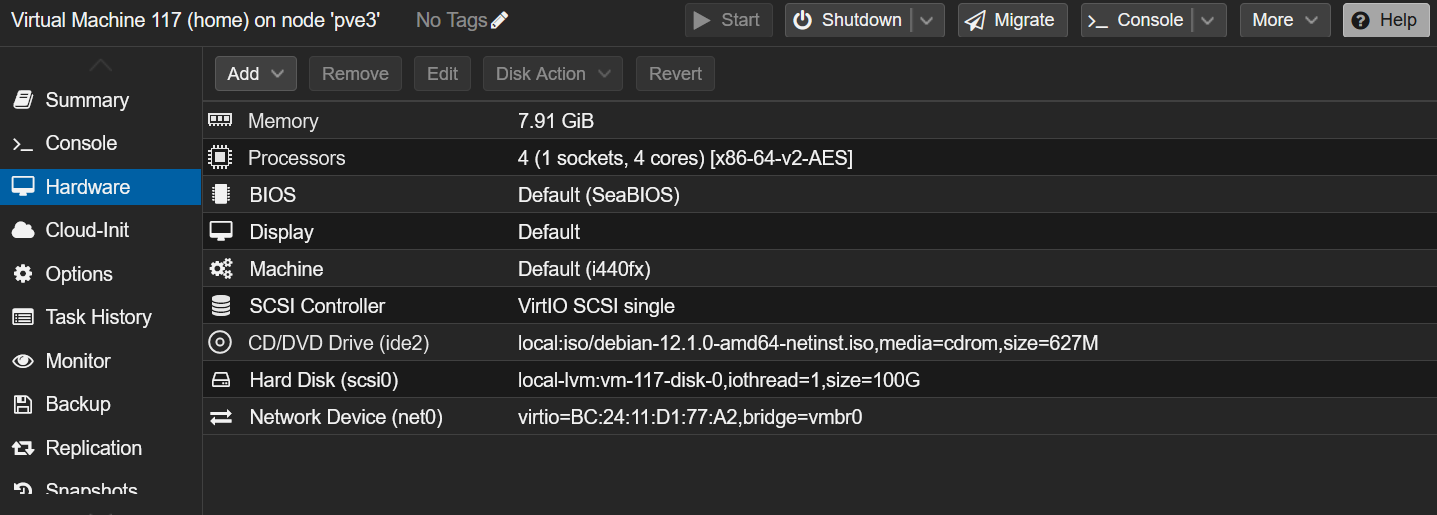

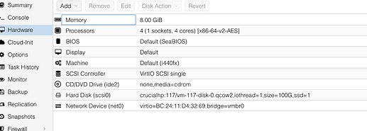

Do you use ns8 as vm?
Yes, on Proxmox.
Mhh well . Unlike I use NFS for almost all vms on xigmanas.
I removed dnsmasq1 … Now I’m starting to do these tests.
