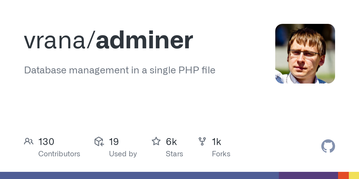

So I looked for something else, and found Adminer
Copied Adminer’s single php file into Nextcloud’s root folder. No installation nor configuration needed.
Entered the same credentials as in Nextcloud’s config.php file.
And boom, here I was.
Bye bye phpmyadmin, I never really loved you :blush:

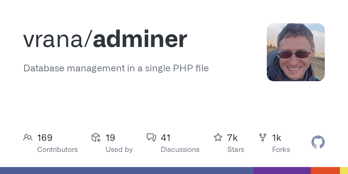

For such a tool that’s a one shot so I don’t care. I just need to visually edit a database to troubleshoot a bug I found.
Than visit https://nextcloud.example.net/adminer.php and it’s done.
