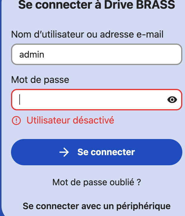

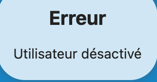

I tried to reapply the User domain setting and also tried “Internal Nextcloud database”. All the users are “deactivated” ?
When logging with ldap auth activated :
All the users were correctly imported into the directory though.

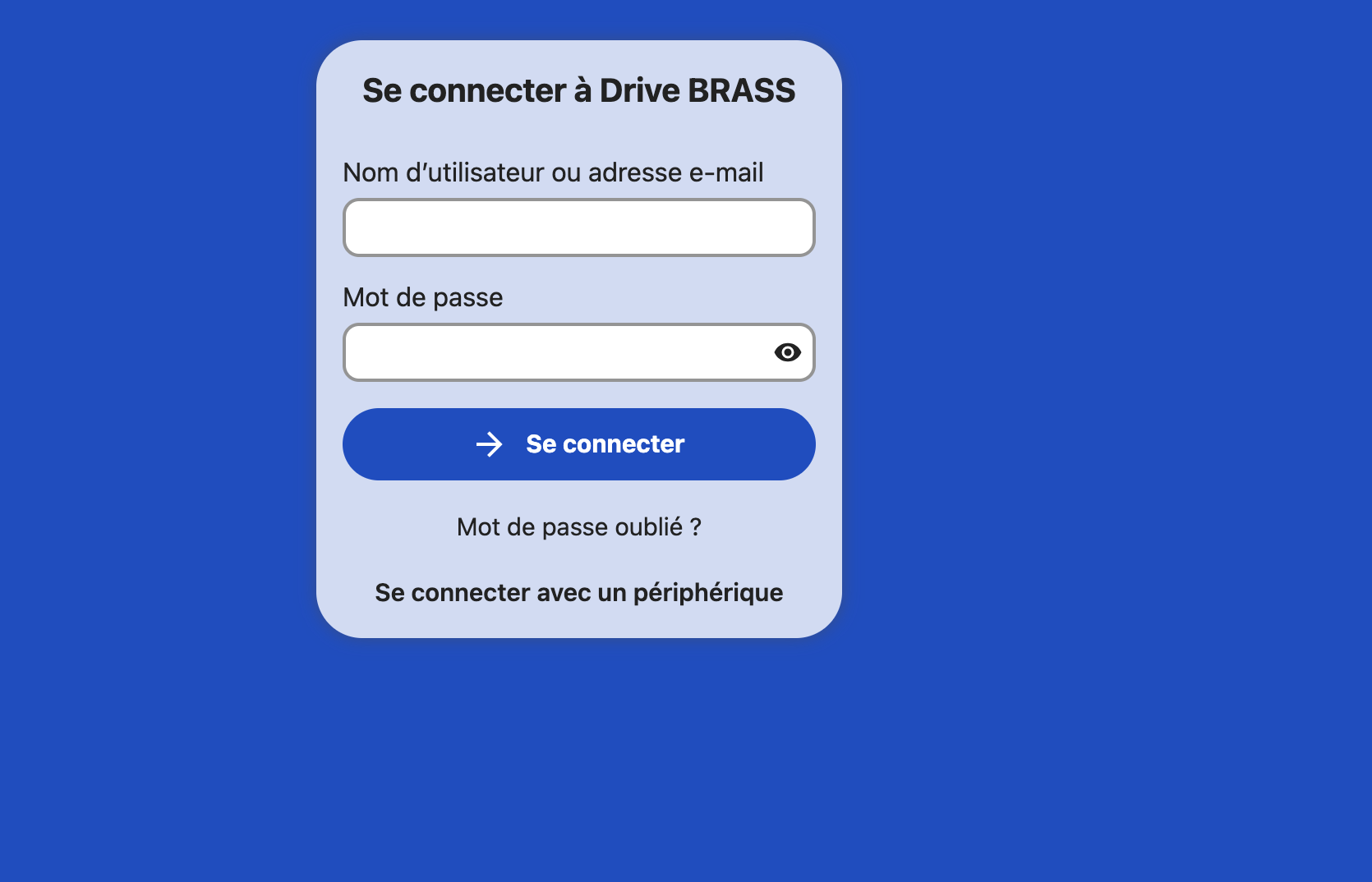

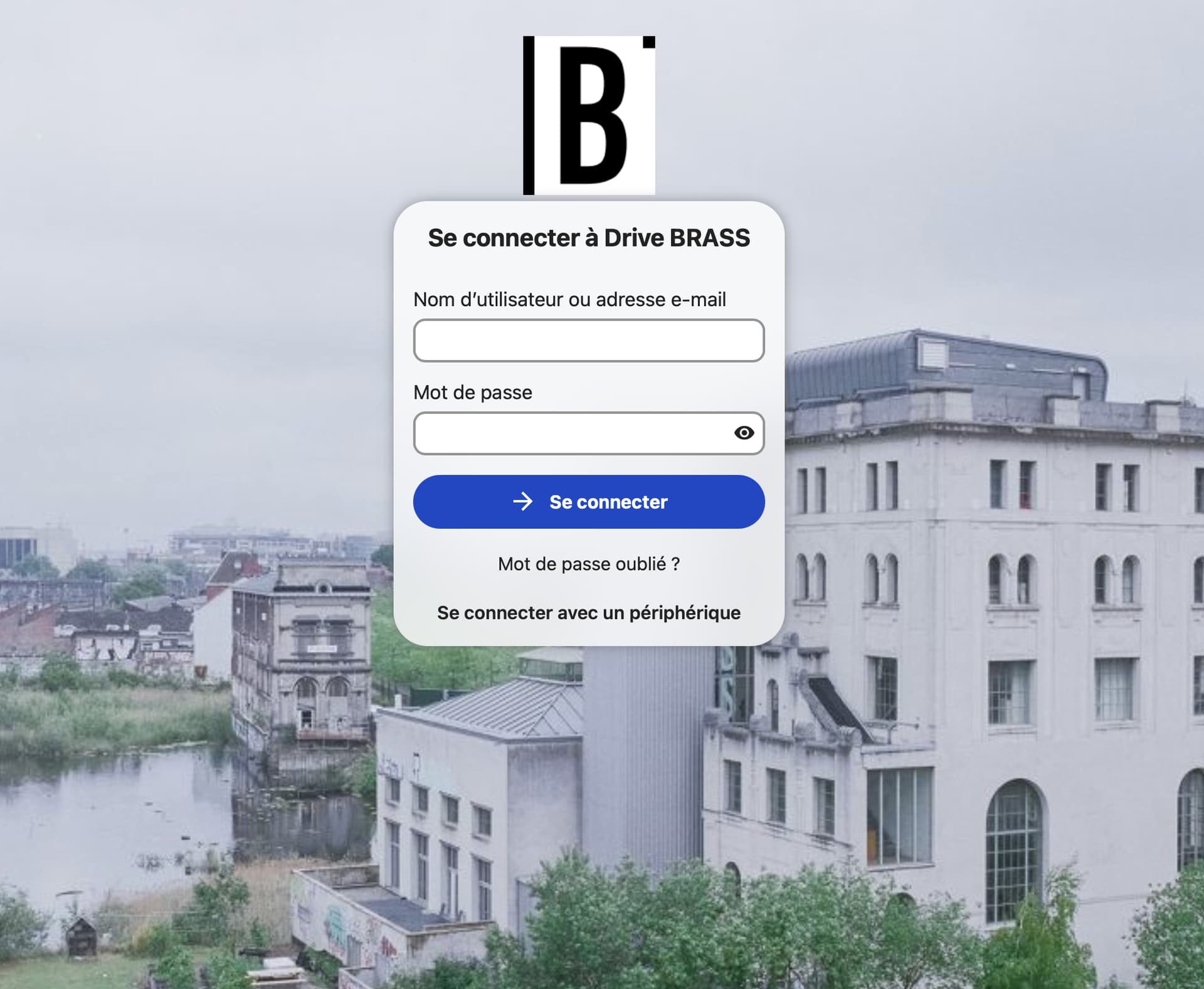

Also I see that the background picture was not imported. I believe the migration failed
Expected :
Migrated instance :

Sometimes also Nextcloud upgrades remove/unset pictures.

You could check the users, enable them and reset password using occ:
Enter app env:
runagent -m nextcloud1
List users:
occ user:list
To see the other possible commands:
occ user

Things are not looking so good. Not that bad but I’m concerned about the integrity of the data.
LDAP is working; however all the users are marked as “deactivated”, no idea why since they are active in ns8
$ occ user:info 00db7576-3bfb-1038-89f0-d38a1c9957ea
- user_id: 00db7576-3bfb-1038-89f0-d38a1c9957ea
- display_name: admin (admin)
- email: redacted
- cloud_id: 00db7576-3bfb-1038-89f0-d38a1c9957ea@http://localhost
- enabled: true
- groups:
- admin
- administrators
- locals
- quota: none
- storage:
- free: 31322193920
- used: 0
- total: 31322193920
- relative: 0
- quota: -3
- last_seen: 2025-07-25T08:14:35+00:00
- user_directory: /var/www/html/data/00db7576-3bfb-1038-89f0-d38a1c9957ea
- backend: LDAP
if manually activated I can log though.
