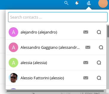

(Alessandro Polidori) #40
remember to enable the app
and to enable this option
to see the user list
