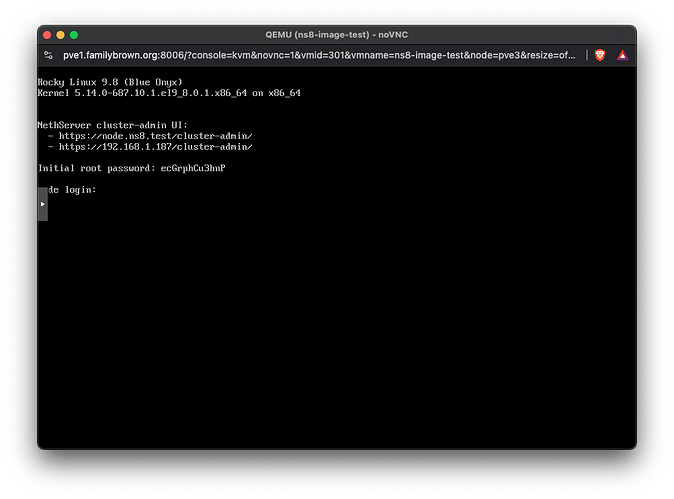

But with that said, I attempted to duplicate on my Proxmox installation. Created a VM through the GUI matching the specs you’ve stated, giving it four cores and 4 GB of RAM, no ISO or virtual disk. Then qm importdisk 301 ns8-rocky.qcow2 local-zfs, add that new virtual disk to the VM (double-click on it, set appropriate options, Add), then adjust the VM’s boot order to add that new disk to it.
Went to boot the VM, and it does stop for a moment at the “Probing EDD” you mention, but after that moment (maybe 30 seconds or so?) it brings up this:
Same result with the machine type set to Q35 and SeaBIOS (though it doesn’t display the URL on the login screen), and also with Q35/UEFI. So whatever it is, it isn’t a universal problem. I don’t know how to further troubleshoot, though.
