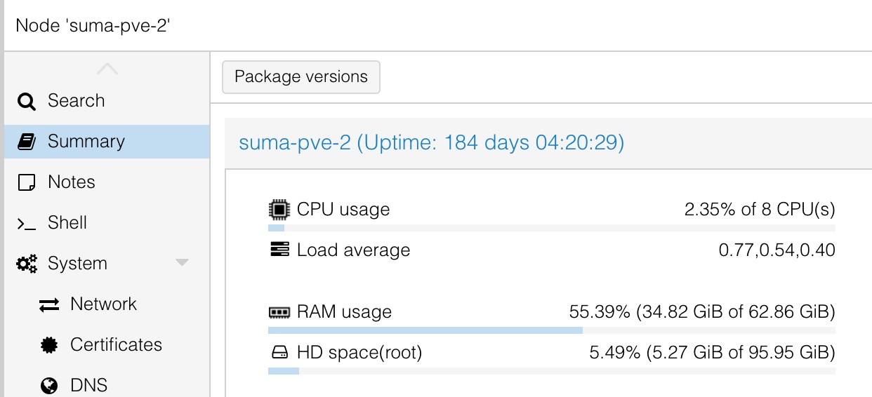

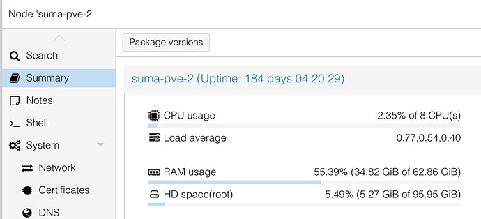

As to stability of Proxmox servers, here’s a typical sample:
HW: Thomas Krenn / Supermicro, 8 Cores, 64 GB RAM, about 7 years old…
Not bad, for a Server set up in March 2020… :slight_smile:
The UPS came a little later, that’s why a reboot was needed…
:slight_smile:

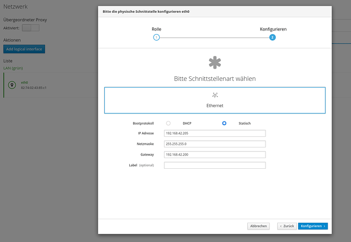

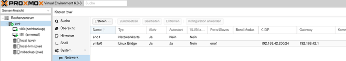

I’m still struggling with the virtual NS. Looking in the messages brings me to a couple of questions. Let’s start with an easy one. Do you have a NS in a VM as a backup-server for a real hardware NS running? If so, how is the VM configured?
For mine it looks like this, where 192.168.42.200 is the proxmox pve and 205 is the VM NS backup-server:
and
DNS are 1.1.1.1 and 9.9.9.9

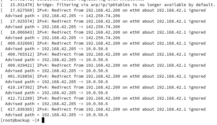

After a reboot of the VM:
Why is there a redirect to GOOGLE?
edit:

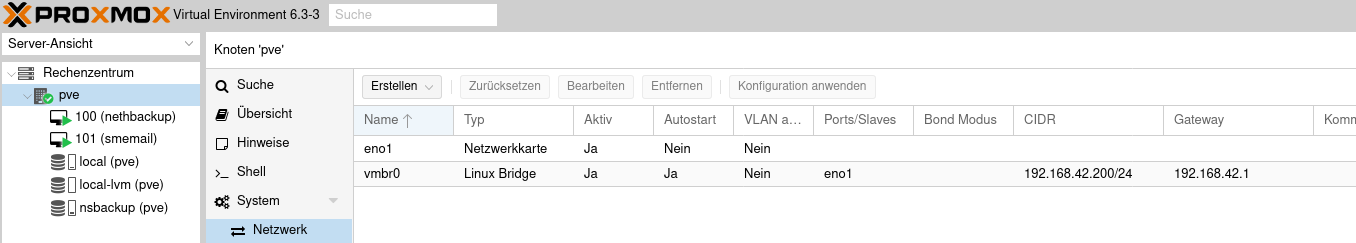

network config in pve looks like this, while 192.168.42.1 is the OPNSense:

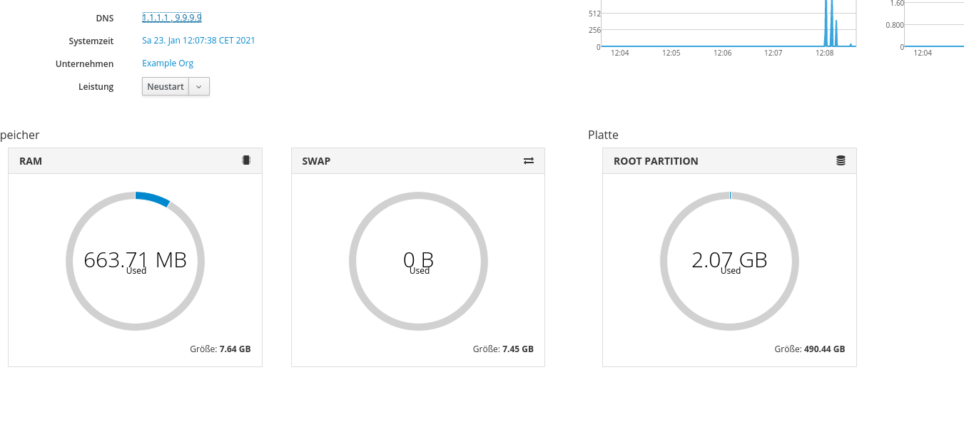

@schulzstefan

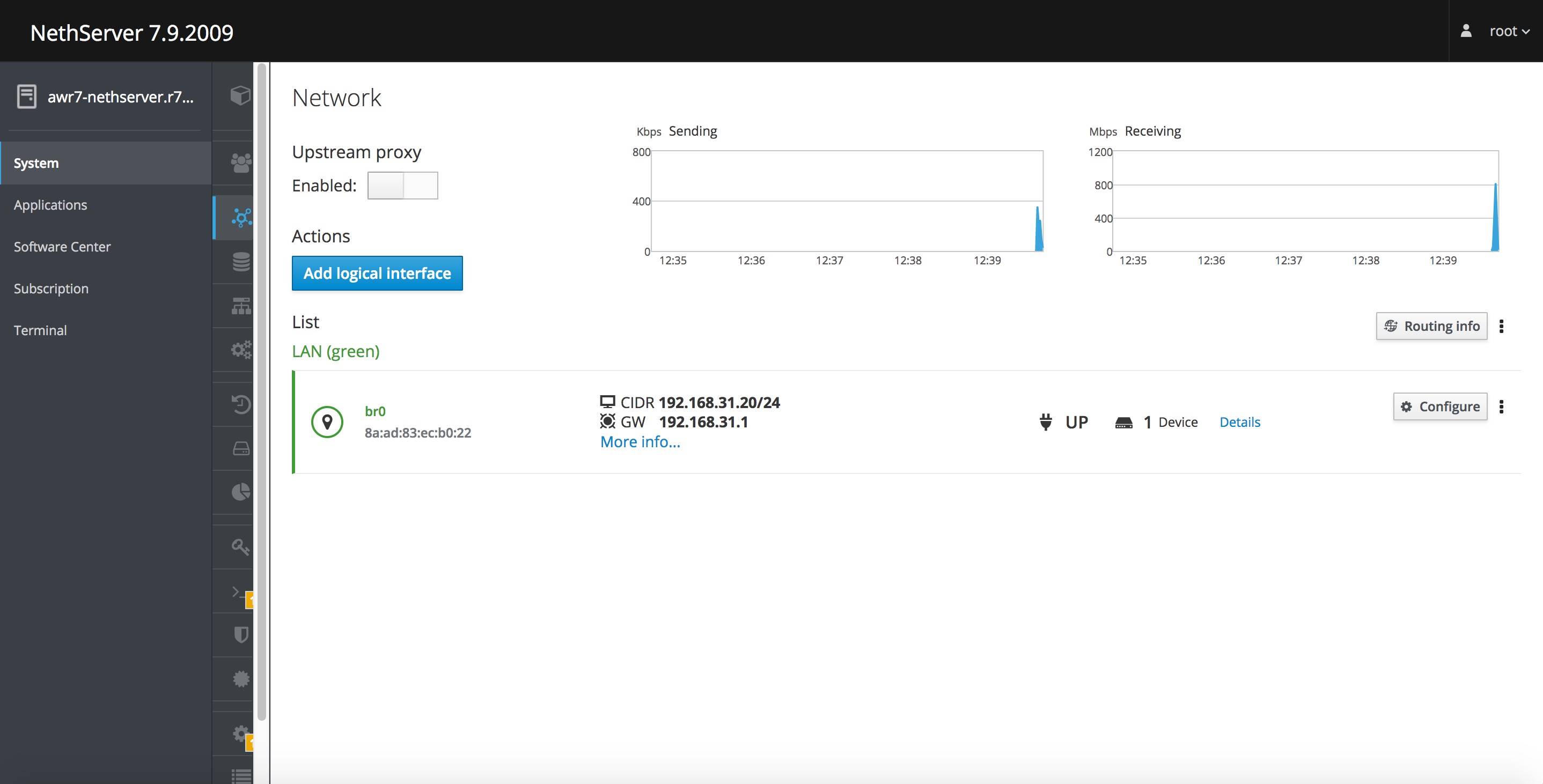

Could you show a screenshot of how that Nethserver VM has (sees) it’s own network?

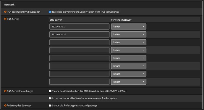

As to the google redirect: you are using Google as DNS…
Why actually? With OPNsense and NethServer you do not need any other DNS Servers…
Most people are under the misconception that a DNS Server needs a DNS. Maybe, but rarely. Root Server A has had the same IP for years now, that’s all a DNS server needs to know to resolve the whole world. And Root Server A is usually hardcoded into the code…
At home neither my OPNsense nor my NethServer uses any Google, Provider or any foreign DNS.
OPNsense is Primary-DNS, NethServer is 2nd DNS. My PI-Hole only uses those two DNS.

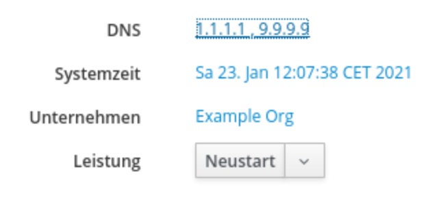

No google DNS in the whole network. I’ll configure the DNS in the VM NS to the OPNSense and the real NS. We’ll see.

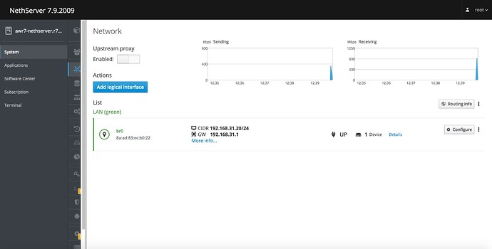

Are these (from your NS Screenshot) not Google IPs?
Bildschirmfoto 2021-01-23 um 12.40.10
Screenshot from Browser, this page:
No.

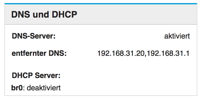

This are the DNS in the real server:
Bildschirmfoto vom 2021-01-23 12-46-49
working flawless.

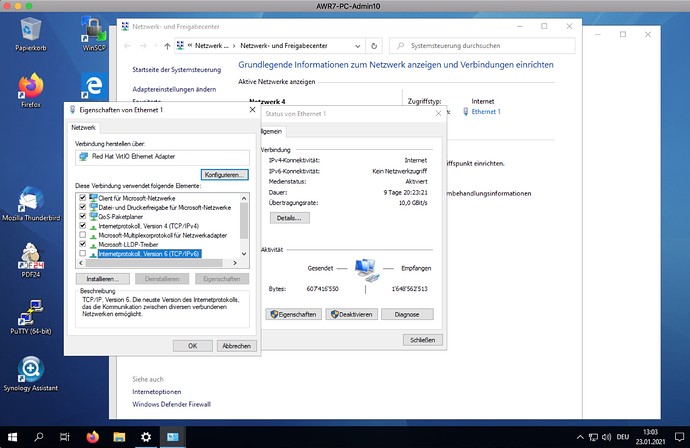

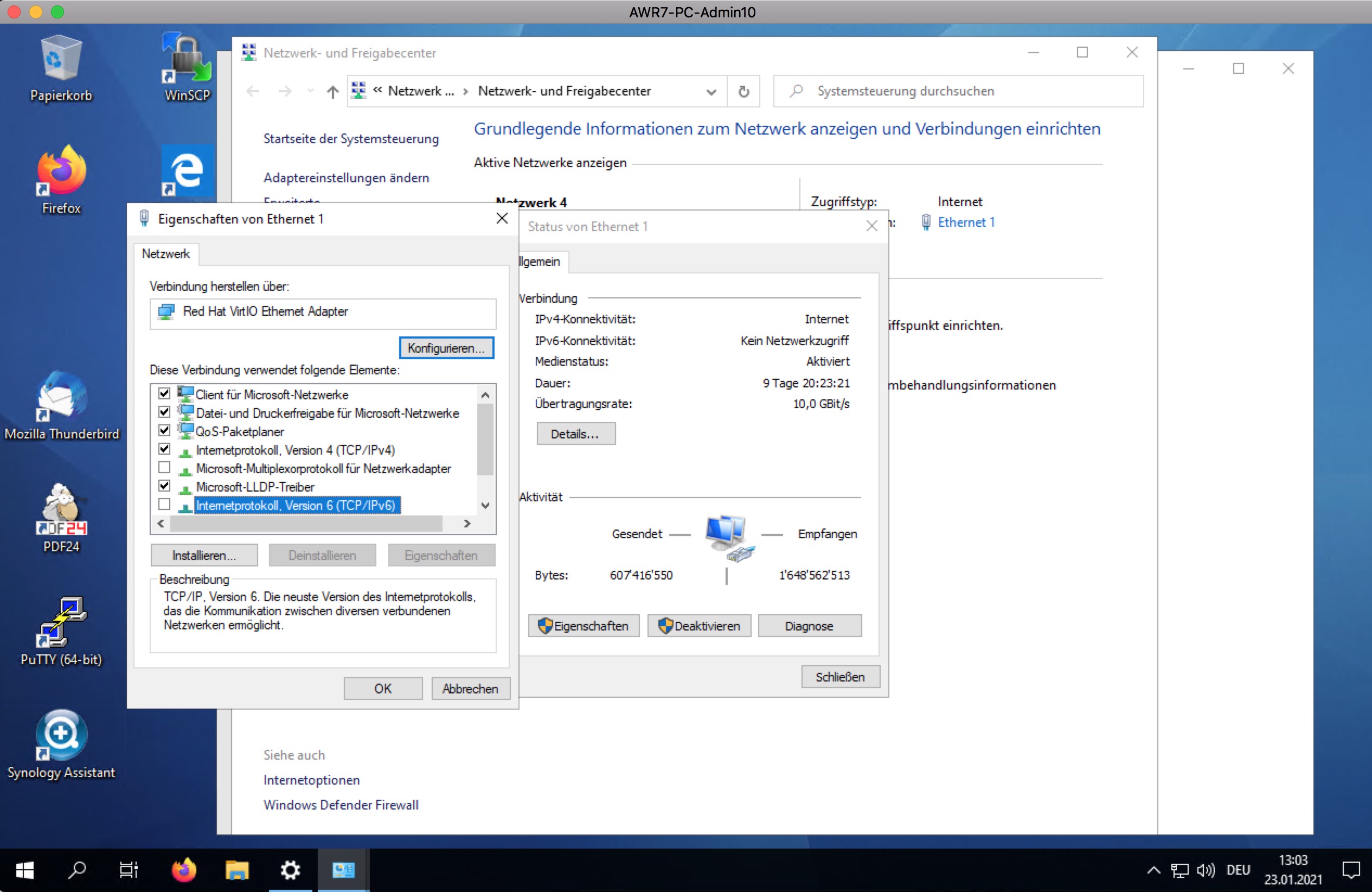

In an environment with NethServer, it’s best to deactivate IPv6 on all possible devices.
NethServer does not yet support IPv6 (At all! But will come…). I switched off IPv6 in my OPNsense, Proxmox does not use IPv6, and also my NAS and PCs have IPv6 deactivated.
That could be part of the problem!
Note: Centos underneath CAN do IPv6 - but NOT NethServer.
It’s deactivated - in the whole network, even in every win-client.
Me too…

is this o.k.?
coming right from the install…
