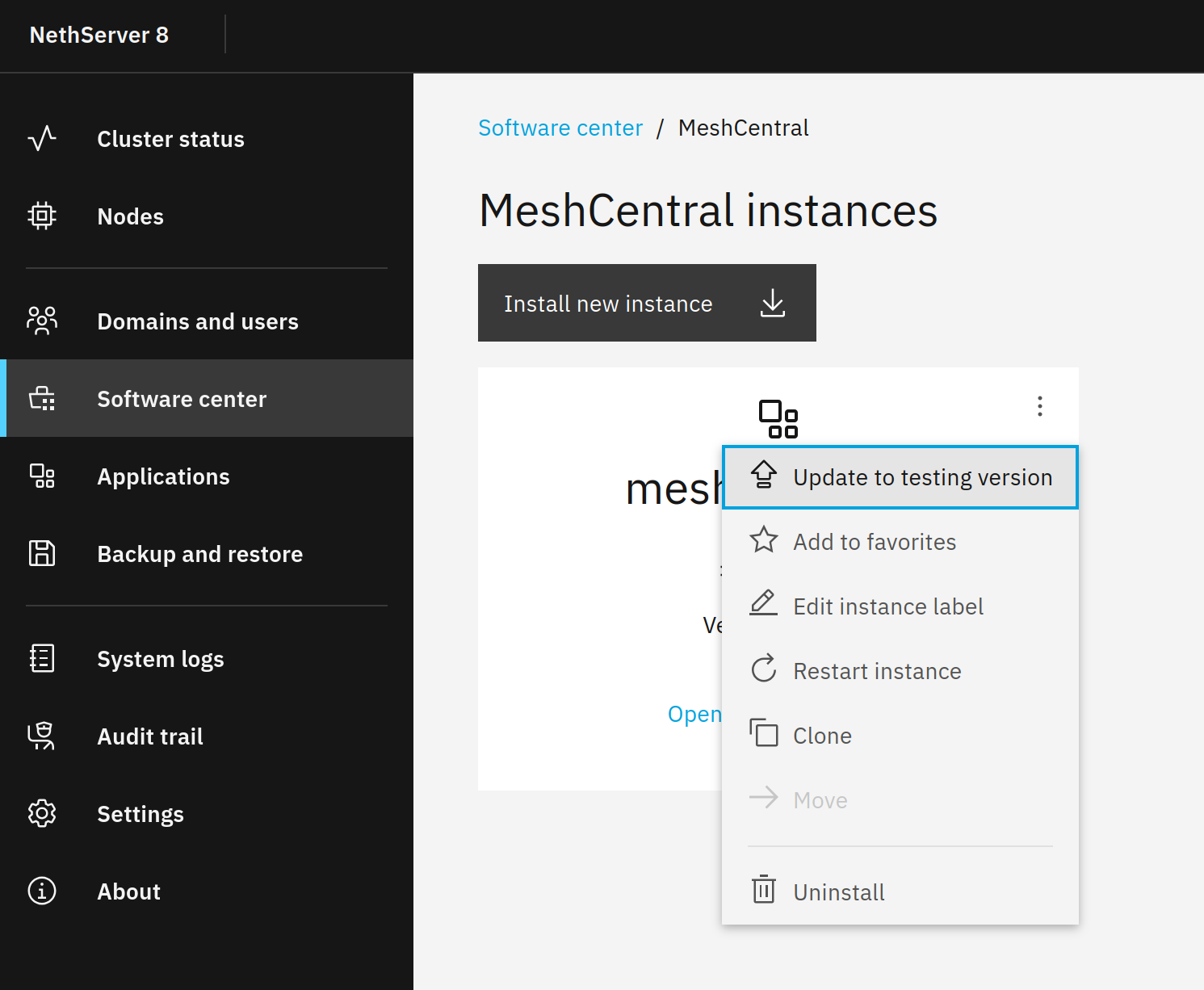

Upgrade existing installation via UI:
Upgrade existing installation via CLI: (adapt meshcentral1 to your used app name)
api-cli run update-module --data '{"module_url":"ghcr.io/mrmarkuz/meshcentral:1.1.0-dev.1","instances":["meshcentral1"]}'
